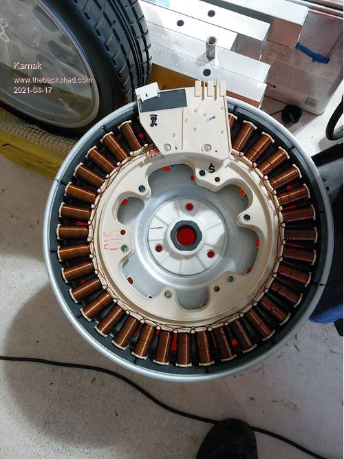

This is the start of a new build using a Samsung direct drive brushless permanent magnet DC motor as an AC induction generator utilizing the motor's inherent "back EMF" signal.
I am going to spec out and list this motor's stock mechanical and electrical parameters, to start with.
Motor design:
BLDC motor out of a Samsung Wf210anw washing machine
https://issuu.com/heydownloads/docs/001___samsung_wf210anw_wf220anw_service_manual_rep
36 pole(coil) aluminum wound stator - 19ga (0.03589", 0.9116mm) wire, (unknown wrap count per pole as of the start of the build)
6.2 ohms resistance per total of the 12 pole coil count, for each of the three-phase legs. 30 wraps on the top layer of each pole.
Estimations of coil wraps per pole:
visibly 30 wraps on the top layer of each pole coils.
Estimation of 5 layers = 150 wraps? Correction, it can not be an uneven number of layers of coil wraps, it must be multiples of 2, due to how the coils are constructed. They begin at, and end at the hub of each pole, hence multiples of 2 layers per completion. Therefore there must be either 4 layers or 6 layers.
19 ga aluminum wire has a 14.6-ohm resistance per 1000ft.
The measured resistance is 6.2 therefore 6.2(1000)/14.6 = 424.65ft/leg,
424.65/12 poles = 35.38ft/pole approx. 35.38ft x 12 inch = 424.65 inch/pole coil,
424.65/150 wraps = 2.83 inch per wrap avg. Seems reasonable. Correction, 424.65/(30x4) = approx 3.5"/wrap, 424.65/(30x6) = approx 2.35"/wrap.
4 magnetic poles in each of 12 magnetic bricks (NSNS x 12 = 48 poles)
Magnetic flux density per magnet is approx 1750 - 1800 Gauss at their highest peak regions.
This stator will eventually be rewound with a specific gauge copper with a specific winding count, to be determined. I will soon be getting the stock generator's output voltage and current at a specific rpm, once I can dyno it on a bench test setup. I will then strip the stator of its aluminum wire and start experimenting with winding counts and wire gauge sizes.

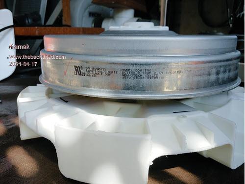

Stock Samsung P/N: 09CA49132 Stator
900mm ID. Mag ring
75mm W x 35mm L x 5mm Thk mag bricks
12 mag bricks
4 poles per mag brick NSNS
75mm/4 = 18.75mm W magnets
35mm L x 18.75mm W x 5mm Thk per mag pole
48 magnets @ 7.5deg of arc per magnet, 15deg arc per "like" polarity
Stock maximum mag flux density = approx 1750/1800 Gauss (at the centerline)
36 coil poles = 360deg/36 = 10deg arc per coil pole
3 phase winding XYZ = 30deg arc per "common" phase winding
15deg of arc per mag pole(centerline) of "like" magnet polarity
   3.75deg+     7.5deg     +3.75deg
N              |          S          |             N = 15deg C|C
N|S|N|S @ 30deg of arc per mag brick
30deg per "common" phase winding
therefore the "like" magnetic pole polarities (and transitions thereof) will always aline with the "common" coil windings throughout rotation, as 15deg is an even common denominator of 30deg.
Edited 2021-04-19 08:43 by Kamak
900mm Inner Circumferance. Mag ring
75mm W x 35mm L x 5mm Thk mag bricks = 30deg of arc
12 mag bricks = 360deg of arc
4 poles per mag brick NSNS = 30deg of arc
75mm/4 = 18.75mm W magnets = 7.5deg of arc

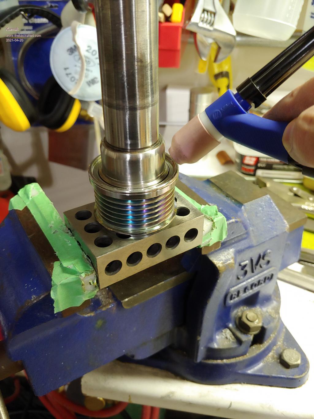

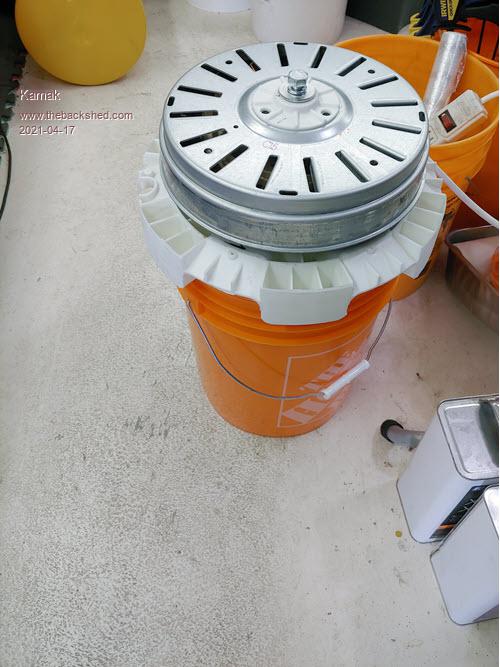

Temporarily Welded on a pully for bench testing.

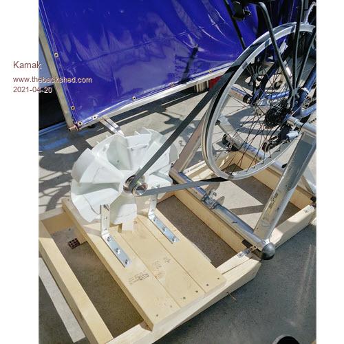

The Test Bed
Edited 2021-04-20 10:03 by Kamak
Kamak
Joined: 13/04/2021
Posts: 150
Posted: 12:03am 20 Apr 2021
The Test Bed
Kamak
Joined: 13/04/2021
Posts: 150
Posted: 02:38am 20 Apr 2021
I got 1Kv out of it. lol

So my bike rim/pully is 565mm OD. the rotor pully is 49.73mm
565/49.73 = 11.36:1 Ratio
100rpm rotor = 100/11.36 = 8.80rpm Bike pully.
Depending on the gear ratio of the bike, I might be able to turn the crankshaft with a variable speed drill, to get accurate steady rpm, if the torque isn't too high.
