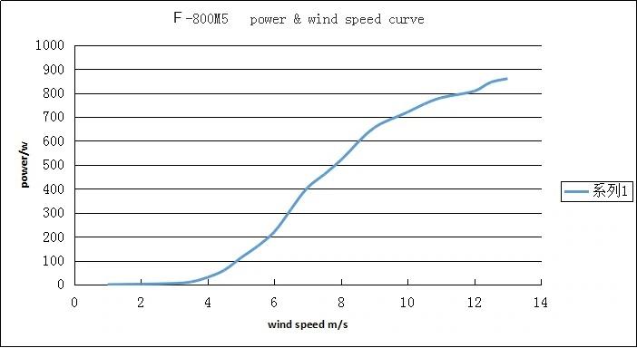

12V 800W Smaraad F-800M5 aka SM5-800 (Made in China)
I cannot verify who the manufacturer really is but it may be this company.

Anticipating the next question, why 900W, the 800W unit is said to peak at 900W and the 1000W similarly peaks above that. To start with I'll run under size blades to limit the power (and lessen the spin time too....I know)

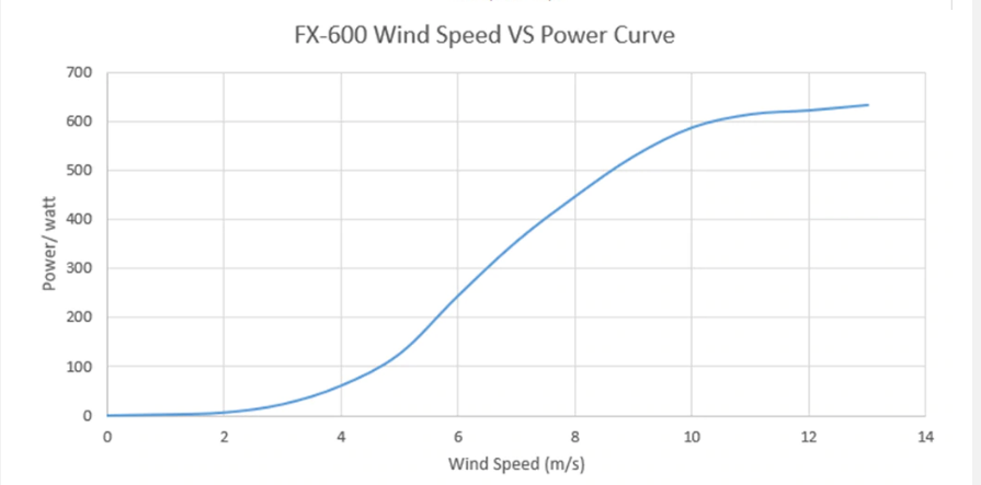

Technophiliac, I have done some research looking at various smaller vertical turbines, this one is interesting, it appears to be quite well made, bit pricey to get to NZ; Power output curve is similar to yours, if it can be believed.
FX-600
Regarding a suitable controller, seems easiest use an off the shelf suitable sized mppt controller from another bigger turbine, rather than attempt to get multiple ad hoc controllers to load share. I will be designing one and publish details on the forum, but will be awhile away.

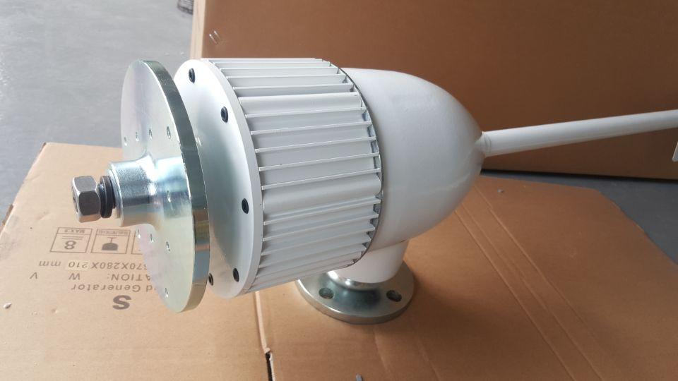

The generator component appears of similar quality to the picture of the above 12V generator. The bearings have no discernable play for what that's worth! Who knows how long they will remain like that but its a good start.
The generators can also be bought separately. I speculate you may find it difficult to do better than one of those as the generator component for your custom home vertical turbine but respect you may wish to exercise your skills and I cannot yet vouch just how robust these things are.
