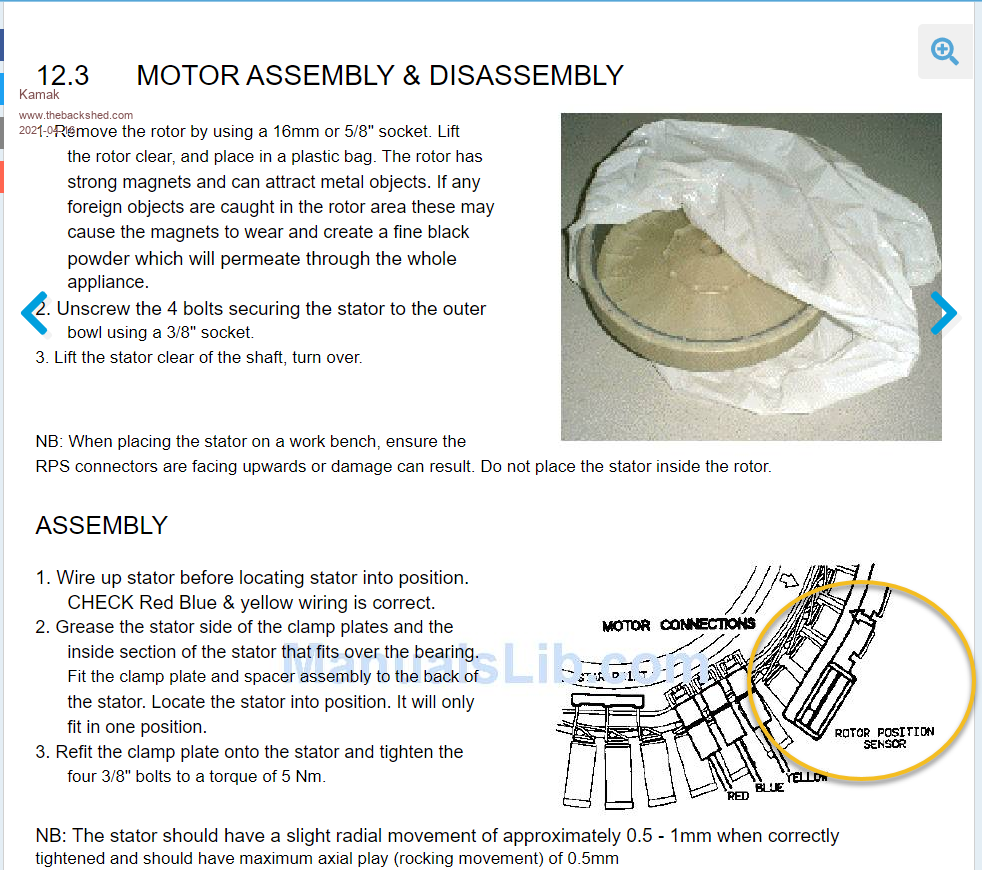

Posted: 12:31am 16 Apr 2021
F&P are not brushless dc motors either.
There is no sensing of rotor position fed back to the controller.
A three phase synchronous motor has more in common with a stepper motor than anything else.
Kamak
Joined: 13/04/2021
Posts: 150
Posted: 02:12am 16 Apr 2021
  Warpspeed said  F&P are not brushless dc motors either.
Wait F&P DD washing machine motors are not brushless DC pulse fed/driven motors? They don't have a hall sensor like the Samsungs or LG's? What do they use to sense position and speed? Do they use VFDs? Those are much more expensive than an ESC. Does anyone have a schem of the F&P DD washing machines?
Edited 2021-04-16 12:17 by Kamak
Kamak
Joined: 13/04/2021
Posts: 150
Posted: 02:25am 16 Apr 2021
Now I'm all very curious as to what models, that are/were being used for wind turbines, and the service manuals for these washers. I thought these were exactly like the Asian DD washers. Same rotor/stator design and these have hall sensors that use the back emf to sense position and speed. This is really weird.
"the Smart Drive DC motor."
https://www.manualslib.com/manual/1160699/Fisher-And-Paykel-Smartdrive.html?page=11#manual
Edited 2021-04-16 12:32 by Kamak
Kamak
Joined: 13/04/2021
Posts: 150
Posted: 02:39am 16 Apr 2021
OK, cool with this manual I also just discovered that yes the new 36 pole units are wound with aluminum wire.
Kamak
Joined: 13/04/2021
Posts: 150
Posted: 03:47am 16 Apr 2021
https://www.manualslib.com/manual/556089/Fisher-And-Paykel-Iw509.html?page=72#manual
So yeah, they are pulsed DC motors with hall sensor feedback servo control and use ESC drives, and they're brushless. They also produce an inherently "induced AC 3 phase sine wave voltage/current that can be utilized for power generation. This is classified as "Back EMF" produced by the permanent magnets induced into the stator.

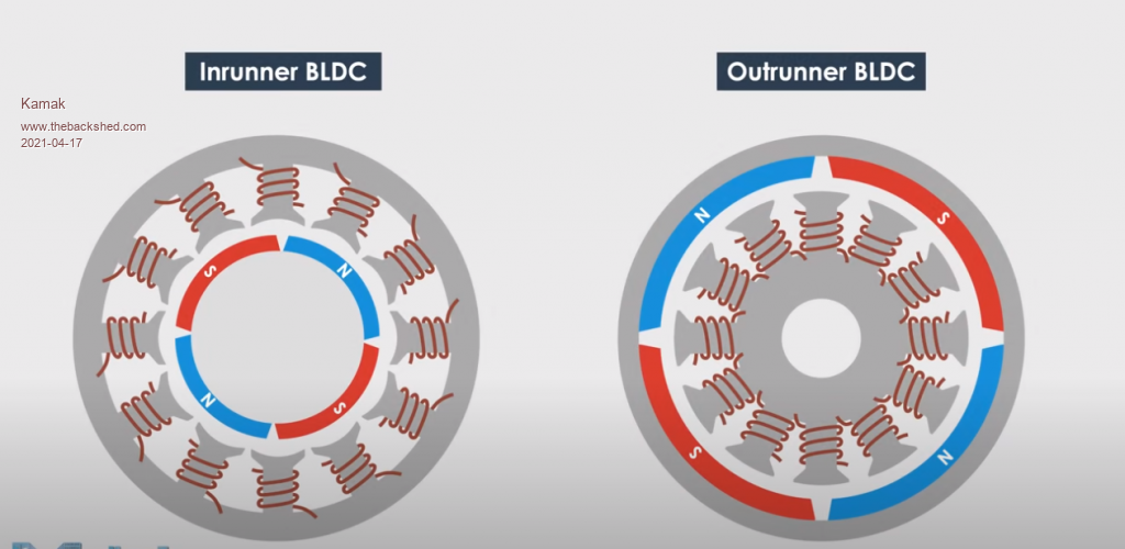

This is how these motors work.
https://www.youtube.com/watch?v=uOQk8SJso6Q&t=1s
