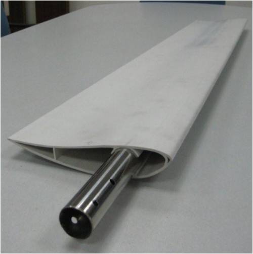

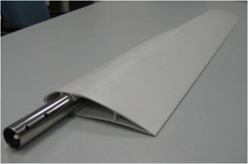

I've been in contact with Wes LeMarr, who some of you may remember posted a message a few days ago looking for advise on a windmill design he hopes to bring to market. Wes has factories in Germany, China and the USA.
Wes called me from the USA last night and we had a chat about blade options for his windmill. I told Wes the standard fibreglass blades supplied with those cheap Chinese windmills let the rest of the machine down, and he should strive to come up with a better blade design to include with his windmill, and of interrest to us, sell seperately to the home built windmill market.
The blades would be manufactured at the factory in China, where they have access to a PVC extrusion machine and router. Making a new die for the PVC extrusion is not a problem.
What does this mean? It means we have the opportunity here and now to design a new blade profile for mass production. The blades will be PVC, and any length from under 1 meter to over 2 meters ( a 4 meter turbine or bigger ). Because they are extrusion made blades, there is no twist or taper, just like those fibreglass chinese blades, however Wes's factory has access to cnc router equipment that can cut the blades to the correct taper. By putting our heads together we should be able to come up with a extrusion shape that can be routered to give the best taper and twist/angle.

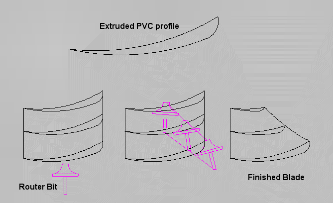

Hopefully the picture below will explain what I'm trying to say. The top profile is the end view of the extrusion. Bottom left is the blade with 3 stations shown, top side facing the wind, and a concave router tip. The router concave is the same radius as the leading edge of our blade. By routing a line down the length of the blade, as shown in the middle bottom image, we end up with a finished blade, shown bottom right.
This is a very cheap way of mass producing blades, and this will reflect in their price. What do you think? Is there another way we can use an extruded length of PVC of any shape we desire to produce a good blade?
What do we get out of helping Wes? We get a better option that the straight fibreglass blades currently on the market, in more sizes, and possibly for less cost. It also means Wes can get his windmill to market with a better set of blades, and thats got to be a good thing.

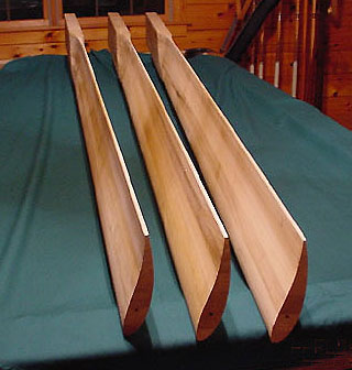

My last set of blades closely resemble the 227's dimensions. They are quiet and very strong with no twist and no taper. I would suggest making them in say, 2 and 4 meter blades so the end user could cut and trim them to fit their own application.
They also need to be fairly cheap in price.

I think your approach is about all that can be done considering the material used. I see that it is the profiles thickness that allows some twist to be gained from the tapering, therefor a profile with good root thickness is needed. For home modifications there is no need to stick with the same profile for the full blade length. Philb's 'Gottingen series 222 through 234' looks like a low speed, high lift profile with a goodly thickness that is fine for the root, with say the more high speed Clark Y profile for the tip.
Perhaps this much modification of the base extrusion is not economical for production. But certainly something with a larger chord to say 200mm is needed. Also unlike your site suggestion of tapering from root to tip, it can be improved by tapering only from the point where the extrusion and the blade profile calculator's shape can be made to match. This may be from around 1/2 way along the blade to the tip.

first up I have no idea how extrusion for PVC works. But I'll throw in anyway.
Can you setup the die to reduce in size as the blade
comes out like a camera aperture? Thus the root comes
out first and as the blade passes the die shrinks down
to cause taper?
If it were possible, I'd try to rotate the die as well
to add twist.
Probably a wasted post here, but threw in an idea anyway :-)

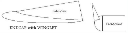

Your idea of using a "winglet" end cap, what do you envision it looking like? I think this sounds like a very good idea, maybe you could post a sketch of your concept.

Here's a quick idea made up in ms paint.

As a pilot (helicopters) I suggest a little caution on the wing tips. They are usually mounted on the end of fixed wing aircraft wings, not on the props'.
There are engineering problems associated with wingtips too, the extra lift puts greater stresses on the wing tips and overall. I've never seen wingtips put on props', There could well be a good reason and add to that the fact that these are "driven" props as opposed to "driving" props'. opens up a can of worms...I'd love to hear from an Aero' engineer on that one... A great idea to let the people at the forefront of this stuff decide what they want though!...Now about designing VAWT blades LOL

Yes Ken, I agree. This subject arose some time ago so I won't re argue my case against them again. The proliferation of winglets on commercial wind generators is a good indication of their application.
