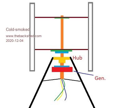

Posted: 07:31pm 03 Dec 2020
Yes, I guess I could put together a hub assy using a couple of trailer or go cart hub kits or similar - and flanges between the main components.
Btw, I noticed that the various versions of the pmgs I linked to are 7.5 to 19 kgs. I believe I saw 17 lbs or 7.7 kgs for the F&P`s.
Edited 2020-12-04 07:36 by Cold-smoked
Posted: 10:38pm 03 Dec 2020
That looks very good.
A  very strong pyramid type of support structure is an excellent idea, and needed to support the whole thing against the high wind loading, and the inevitable vibration.
The vertical rotating shaft could be extended right down to near ground level, and the main weight supporting bearing could be placed down low for best access.
You could drive the generator direct through a coupling, but a better idea might be to drive it through a belt or a chain drive, with a drive ratio that could be very easily altered, especially if the generator was bolted to slides to easily adjust the centre distance.
There may be some very great gains to be had with an an adjustable drive ratio.
If its all kept very simple, with the fewest parts, its not only going to be easier to fabricate initially, but also a lot easier to rebuild if it ever gets wrecked in a storm.
