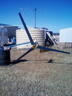

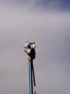

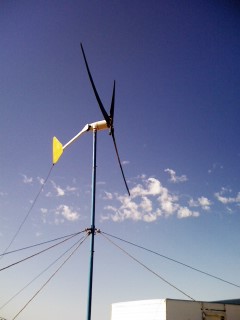

Here are the new storm proof blades...
They don't put out much power tho...
I have bought the farm...now I AM powering it...

Interesting airfoil you have there....not sure your going to start a trend though...
The tip angle doesn't look quite right, and perhaps try and get some more angle at the root.... for better startup.
Im thinking your dump load is idle at the moment
Sad to see this though.
Time to get the chainsaw unleashed I think.
........oztules

Hi grolly,
is probably a good thing your storm proof blades were on yesterday. I am on the south coast and we were hammered yesterday. I have a couple of sets of wooden blades that you would be able to look at for inspiration. You have a chinese mill I think?
Storm proofing is all about furling. I took 300mm off the tail boom length when I reduced the rotor size by 600mm on my F&P mill. The chinese mills have a very heavy and long tail boom, with a relatively small heavy steel fin. I would look at some mods in this area. My F&P mill is controlled now, with furling starting at 10knots and almost fully furled at 20knots. No extra power generated, even in tested 40knot winds.
The high pressure system will dominate the weather for a while, so it is a good time to work on your mill.
Gordon.

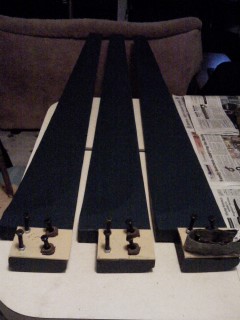

I have started to make a set of blades, don't know how successful they will be, I have modelled them on the old ones for shape, but I am using plastic, they might bend not beak.

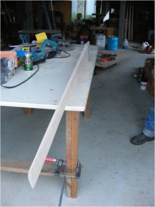

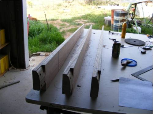

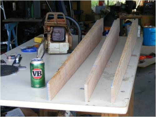

Well Guy's an upadte on todays work, yesterday I stopped at the timber yard and picked up 3 lengths of victorian ash for the blades. All the planks are straight square cut grain and when I told the guy what I was doing he took me out to the backshed and got me the best timber he had. Well $112.50 cash aint a bad price for the planks.
Firstly it's amazing just what you can do with a chainsaw powered by VB.
Just joking for Oztules.

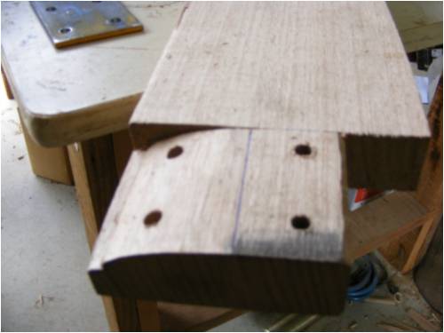

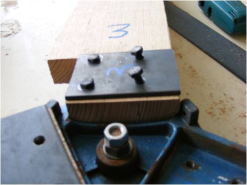

Now for the nitty gritty. The pic below shows how we chielded the wood to fit the chinese blade mount.
This pic shows the top of the chinese mount and tomorrow I'll make some tapered washers to suit the angled bolts

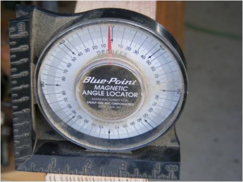

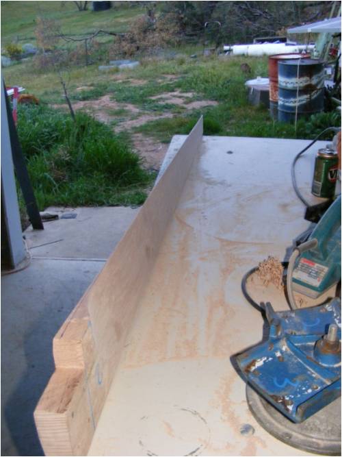

Here is a pic of the blades before any cutting showing the 3 degrees angle on the tips. We did this to see as the chinese blade mount had an angle already on it so to be sure to be sure we had to check.

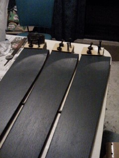

Well after day one here is the progress on the blades.
Tomorrow we'll hopefully get the blades finished, balanced and painted with the same 2 pak acrylic paint I used on my blades. The next job is going to dis-assemble the chinese genny and reverse engineer it so we have yet another kettle of fish to fry.
Cheers Bryan

Impressive blade mount workmanship....difficult curved surface there.
Dunno how you did that with a VB powered chainsaw .
Did you have to twist the blades, or is that a straight taper, with the twist from the angled mount?
It looks like you have used a bandsaw or similar to get the taper you have.... you realise I would not have to ask all these questions if you had a few more pics!! (I'm just picture greedy)
Looking good, am waiting on the edge of my seat for part two. I am also well relieved that you have managed to get Grollo weaned off plastic/glass blades. (By mistake I managed 5kw from the chainsaw blades today... they didn't break Grolly )
Well done Bryan, you're getting to be a real pro at this blade business.
.........oztules

Nice blades Bryan!
That's beautiful wood! The only wood I have found that looks that nice is aircraft grade spruce. I would have to sell the farm to pay for them. Instead, I use fiberglass over wooden blades.
You and Oztules seem to have taken blade fabrication to perfection!
Thanks for an excellent post! I am looking forward to hearing about reverse engineering the chinese generator.

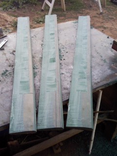

Well day 2 guys,

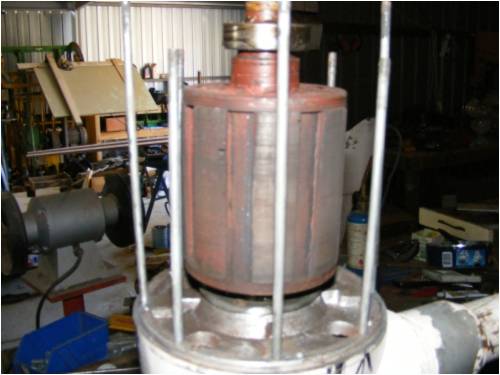

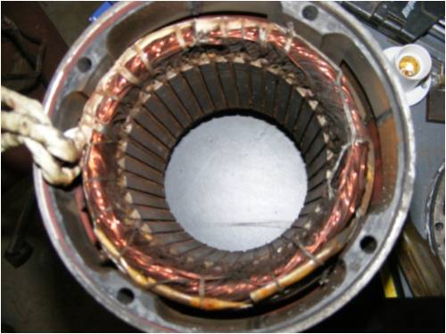

More hard work and we got all the front faces on the blades done and 1 blade nearly finished. We pulled the genny head apart and well the thing just looks like a cheap motor rewind so no reverse engineering here. It will be far easier just to do a motor conversion and get a better output anyday.
With the finished blade on the mount the tips are sitting on 3 degrees and although the wood was only 38mm thick we managed to get some twist in the blades. Hopefully i'll get a chance thru the week and get the blades all finished, both bearing holders rebushed and the genny backup in the air at Grolly's place producing power.
Cheers Bryan

Nice looking work Bryan
..... of course you know if you had fed the VB to the chainsaw, they would be finished yesterday ... two sets.
Dinges
Joined: 04/01/2008
Location: Albania
Posts: 510
Posted: 10:19am 21 Sep 2008
Bryan,
Hard to see in the pictures and maybe I haven't read carefully enough, but what's preventing the generator from cogging?
Looks as if the permanent magnets on the rotor are straight bars, and it doesn't appear the stator is skewed either?
Good looking blades, btw. Couldn't find a knot in there... More royalties going in Oztules' direction, I s'pose. He should be filthy rich by now.

Dinges,
Just Filthy I'm afraid. He did these blades the hard way, so I missed out..... and I think he's going to fine me 2 cents for being a smarty.... so I'm back to zip
I wondered about the cogging too, hopefully we'll find out if it cogs or not.
I am a little concerned about the length of the blade holder (or lack of it). Seems creepy small to me.

Oz the blade holder is abit on the small side but i did make the base of the blade fit in suggly. I also made a 75x110mmx6mm plate to go ontop of the blade and 2 out of the 4 bolt go in at a 45 degree angle. Also as it will be hard to keep the moisture out of the blade base we'll be putting fiberglass resin in along with some glass matting not only to seal it up but also for additional strength.
The rear bearing had gone on the rotor so once i get the bores re-bushed and the thing back togather we'll see if there is any cogging but Grolly did say there was very little if any cogging. I'll measure the distance between each magnet and see if any are offset too..
Cheers Bryan
