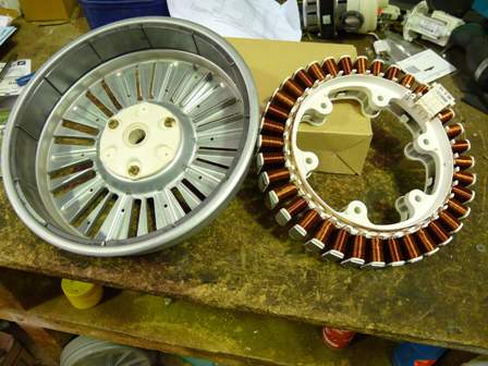

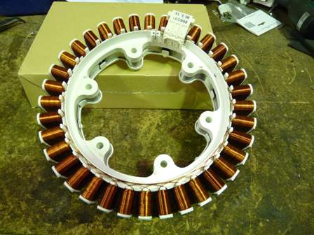

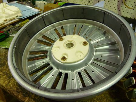

LG Front loader has a similar setup to the F&P and I thought it might be useful for wind power. I have not gone into the details yet as they are hard to find. What I do know is it is designed to spin the entire washing machine bowl and 10kg of clothes. So it must be strong, maybe too strong.
Good thing is it is made of steel mostly. I can get these Brand new as a set for $53 plus postage, but I don't have the time or skills to start from scratch. Anybody interested in trying them out.
Attached are 3 photo's hopefully.

Gee, $50 for stator and rotor --are you sure ??? F&P are much more...
The "bolt-in " rotor mount looks great ,machine fit a shaft ,easy.. The stator looks a bit light compared with the F&P (wire and laminations ) .. but the steel backed rotor might be great ..
could you get back to us on those prices,please?
