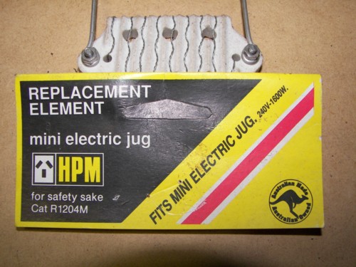

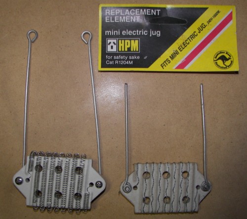

Here's the element type in question with one of my spares. This is as per the instruction and 4 of these are the dump load of a 12Volt 300Watt wind turbine.
This pic clearly shows the element is 240Volt 1,600Watts as purchased and for bare immersion in water.
You young fellows have been spoilt by electric kettles that turn themselves off. In my day we had to clean up the mess when the jug boiled over.
Cheers Gill _Cairns, FNQ

dear Gill thank you for calling me youngster, but as a 67 year old youngster I learn to heat water in the old kettle over a "Primus" heater, I would like to know if the elements have to be connected in parallel [ the elements I have are the same as in the photo 240 volts 1600 watts] do I have to use a diode and if i have which thanks agaian to both of you I have been learning a lot.
