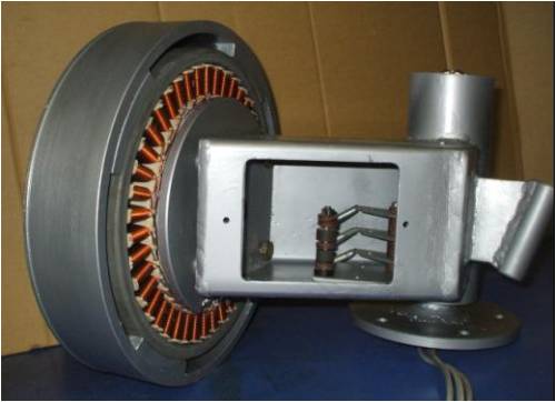

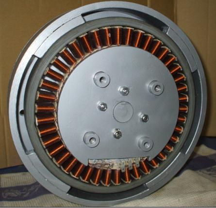

The F&P mill is up and flying.
Here are some photos. The design and engineering was by ZestAir. The Unit contains an unmodified F&P 100S stator and the original F&P magnet ring, that was removed from the spline moulding. This is a work in progress still. The 1.5m Douglas Fir timber blades of high aspect taper/twist design are in the process of restoration.

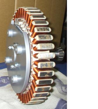

The first 2 images are of the assembled alternator with front and side views

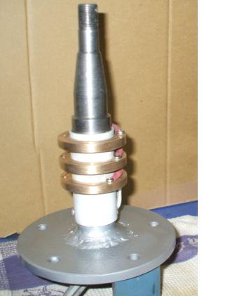

This image is of the Yaw bearing and slipring axle

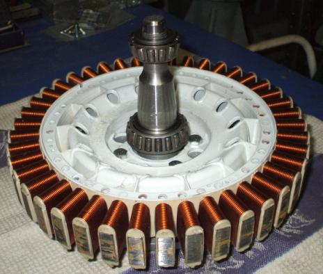

This image is of the assembled alternator
This image is of the assembled mill head components
This image is of the windmill waiting for enough wind.

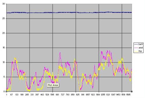

The first flying test is finished.
I have logged the F&P with my mill as a comparison.
The graph below has battery current for each mill and battery voltage. The current is multiplied by 10 for clarity to show on the one graph. The test was for 5 minutes.
This is a 24V nom battery system.
There are some interesting features. The F&P mill needed approx 15kph wind to start.
The axial flux mill has a 3.14m^2 wind capture area and has a Maximiser between the mill and battery. The F&P mill has a 7.07m^2 wind capture area and is direct to the battery bank.
I have to say that there is little difference in the currents between each mill. The iron cored mill was not overloaded at the power levels tested. It seems that the iron and winding resistance gives a degree of wind energy tracking. The larger rotor had more inertia and this smoothed the mill response.
The most obvious point is that the F&P alternator required 7/3 larger rotor area to produce approx the same current.
There is significant noise associated with the cogging. This does diminish at higher power levels. I have had to turn the F&P mill off until I either twist the pole fingers, or use some other technique to reduce this noise. It certainly will draw unnessary atttention to the windmill with the current noise levels if left this way.
No doubt more enexpected results will come with further testing.

Gordon,
Very clean lines and presents well.
The bearings will never be overloaded that's for sure and am curious of the lubrication to be used and how it's retained.
I assume a load distribution clamping washers/ring was left off for the 1st photo but guess too late now if not.
A weather exclusion cover across the back of the stator could block sunlight etc. but again may have been left off for photo.
I really like the enclosed slip rings, and still accessible through a cover plate for quick inspection.
The added mass of the hubs extra band may slow response time a little, but otherwise a very neat and solid mill.
Nice to see a departure from the standard arrangement too. Though, like me, I'd say few would have machine shop access to duplicate that approach.
At least us bush dwellers can always beat you with height. Those stumpy towers might pacify the neighbours, but can't give you the clean airflow you'd like.
Still, it's a matter of making the most of what you've got, and that mill will sh*t it in.
Great design, Nice work.
Cheers Gill _Cairns, FNQ

Hi Gordon ,,,,
nice work ,,, the 100 series will annoy your neighbours -- it makes by far the most noise and I've tried many ways to minimise this ,,a hum on the way up and a hum on the way down --pity ,because it's a great performer.
Change over to a 80 or 60 series stator and silence is guaranteed.
Can you incorporate a "dual" stator/rotor into your assembly--?.
Nice work on the slip-rings,,better tell our mates about the brushes--a very important part of slip rings ..
Your wind strength has to this point not been ,in my opinion, strong enough to capture the top end ,but as discussed you want to see how things go down in the low end winds.

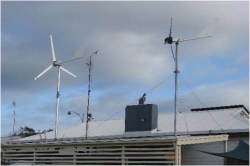

It looks like the windmill mast is attached to the roof? If so, then yes it will make a hell of a racket!
Using a standard F&P on a roof mounted mast is possibly the noisy-est configuration you could come up with , top job. But if thats not what you wanted, any of the decogging methods will reduce the noise considerably, and get the windmill starting in lighter winds. Using a later model 36 pole smartdrive will be almost silent, as would a 7 phase conversion.

Looks Bullet proof , are they ford wheel bearings on the prop stub axle ? if so you should be able to swing a 10 mtr prop on them in a gale .. Great to see different designs and keep the test results comming ...Phill....

I have just applied the twist technique to the pole fingers of an 80 series and now have to true the stator again and then I will rewire to the standard rewire.
My axial flux is attached the same way to the structure and is very quiet. If I lose some max power in the decogging process, this will not be an issue. I may end up with a rewire in delta with a maximiser.

Looks very impressive, Gordon. The devil is in the detail. The slipring assembly with detachable coverplate, the generator and yaw bearings, the outer rotor. Looks very professional, I hope it'll live up to its expectations.

I will decog the 100S as well now.[pole twist method]

My two machines are almost the same, from the ground, up through the pole, slip rings and yaw box. The different power head and blades are interchangeable.
There appears to be a fair bit of electromechanical loose coupling, "sponginess" between the wind energy and the battery in an iron cored machine. The blade/alternator/battery was well matched to the wind energy during the above test, at that wind energy level. A boost maximiser would not have improved the output. As far as I can tell, there are no MPPT, to confirm this with.
The fact that my axial flux[electrically stiff], that has controls to match the wind energy, provided almost the same power tracking as the iron cored machine was shown in the data. The blades were not overloaded as there was no abrupt sound/rpm change as cutin occurred, and current flowed. The battery voltage remained constant during the testing, yet in both machines the rotor rmp followed the change in windspeed, at the 0-50W power level. This may be dumb luck with the F&P/battery load being well matched to the wind energy at this power level.
I will keep gathering flying test comparison data similar to the above, to log the test changes.

Dinges,I had a large resonating noise in the blades of my VAWT caused by the uncogged F&P.By twisting the poles as described at the front info page of this site,it is now silent.But is still unloaded as I have yet to do the rewire modifications.But it definitly got rid of the noise and starts more readily.

Still, something is the matter; the F&P has 2.3 times the diameter (7/3) so 2.3^2 = 5.4 times the blade area (and potential windpower capture), yet it produces the same amount of power into the battery as the much smaller axial flux. That's not right.
So, either the F&P blades are more inefficient or not properly matched to the generator, or the F&P is much more inefficient (copper losses? Iron losses? simply not enough magnet to actually generate satisfactory power?), or the F&P isn't matched properly to the batteries, or...
I don't know what's the issue here. I'll agree that an iron-cored genny has more losses, but certainly not to the point that it needs over five times the blade area to produce the equivalent power of an axial flux. If we assume the axial flux to be 100% efficient then the F&P would be in comparison only 20% efficient. If it were only 20% efficient I'd expect your F&P to get very hot (assuming the blade was still harvesting 5.4 times as much power as the blades of the axial flux). If it isn't getting hot that may mean your blades aren't extracting all the power from the wind that they should ? (less mechanical power input to the F&P).
So, either you're getting much less mechanical shaft power input (blade issue), or there are huge inefficiencies (generator issue; unlikely, as the F&P would have to get *very* hot), or... ?
Something's not right though. (or rather: there should be room for improvement )

Very professionally-looking setup! Congratulations! Those Timkens are as big as Texas and would support a dual F&P.
Will you use the brushes out of a vacuum cleaner for your slip rings? Or something better?
