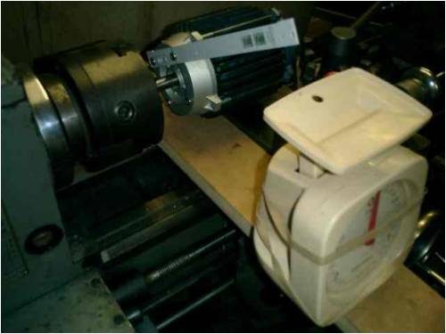

All this talk lately of efficiency made me curious as to how efficient my 500W motorconversion 'blue boy' actually is. I decided to measure it. For completeness' sake I'll include all measurement steps so others can easily repeat it for their generator if they desire to do so. The 'math' part below can be skipped if you're only interested in the results.
To determine generator efficiency we need to know both the mechanical input power and the electrical output power. Electrical power is easy to measure using a voltmeter and amp-meter as the genny is charging the battery.
Mechanical power isn't much harder to determine using a De Prony brake. Below is a photo of the setup I used.
The lathe was used to supply mechanical input power to the conversion. The generator shaft is clamped in the chuck. The house is more or less free to rotate but actual amount of rotation is held in check by an arm (with measured length l). The end of the arm presses against a weighing scale. The 'weight' on the scale is an indication of torque, which can be used to determine mechanical input power, with the exact relationship being:

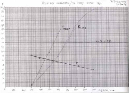

Below is the graph that shows both mechanical input power and electrical output power as a function of RPM, with power (W) being on the left scale. The downsloping curve is the efficiency curve, with the horizontal line being defined as 100% efficiency (chosen so that 100W on the left equals 100%)
(high-resolution images can be found here:
http://picasaweb.google.com/motorconversion/500WMotorconvers ionBlueBoy (click on the magnifying glass to zoom in))
To my surprize, efficiency in the lower output range was actually quite high; at 3.8W electrical power into the battery efficiency was 72%. This figure takes into account ALL losses in the system, also rectifier losses, so the actual efficiency of just the generator would be even slightly higher. As output power goes up efficiency goes down, as expected because of I^2*R copper losses. I rate this generator at about 100W maximum (even though it originally was a 500W motor). At full rated output power efficiency is about 50%, which isn't fantastic in my opinion.
The losses consist of all losses in the conversion chain: bearing losses, iron losses in the stator, copper losses in the stator, wire losses to the battery and rectification losses in the 3-phase rectifier. So it includes more than just the generator losses. Power lost in the rectifier is about P = sqrt (3) * 1.5V * I so definitely not negligeable. As there may be non-linear losses involved (losses that vary non-linearly with RPM) I decided not to calculate 'the' efficiency but rather establish an efficiency curve over the operating range of speeds.
One more note; after the testruns the generator was noticeably warmer, I estimate it was at about 45 deg. C. So was the rectifier. Of course, the power losses had to go *somewhere*, in this case being used to heat the generator, rectifier and connecting wires. At some point there was 470W being put into the genny and 176W extracted, so the difference (~300W) had to go somewhere...
All in all this is a pretty simple measurement technique to determine generator efficiency, which yields a lot of information about the performance of the generator. It would be nice to see more of this kind of data in the future from other people's gennies, as it provides a yard stick to help evaluate performance of generators.

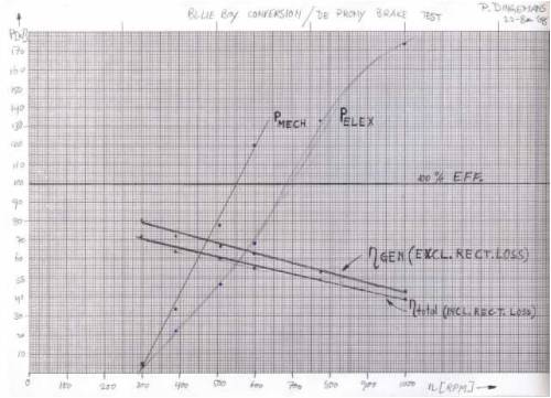

I did make a graph of the generator efficiency, this time excluding rectifier losses. Rectifier losses *do* matter in the entire windgenerating system, but shouldn't be included in the generator losses, so I separated the two now.
(high resolution image here:
http://picasaweb.google.com/motorconversion/500WMotorconvers ionBlueBoy/photo#5237671013160885154 )
As can be seen, maximum generator efficiency is about 80% at the lower range, decreasing to about 60% at its rated 100W output power. Most of the loss is copper loss, with rectifier loss and iron loss being of lesser importance: at 1000 RPM there was about 46W iron loss (10% of 468W mechanical input power), 16W rectifier losses and 210 W copper losses).
I'm pleasantly surprized by the generator efficiency at the lower end of the power range, I would have expected it to be worse. 70%-80% I consider to be acceptable for a motorconversion. But the fact that the iron losses are so low compared to the copper losses suggests this generator is 'undermagnetized', despite my attempts to cram as much magnet as possible in there. Most likely it's caused by the relatively large airgap. This was a deliberate design consideration but, as can be seen, comes at a price: acceptable efficiency in the lower power range but rapidly increasing copper losses as power goes up.
Edited by Dinges 2008-08-24

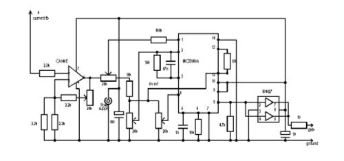

Thanks Oztules. The schematic looks familiar (I've seen it before) but is unfortunately illegible. And I don't see any inductors or capacitors that function as charge storage for the boosting, or any big transistors/FETs ?

Dinges, go to Flux's files, it looks better there. So you should recognise it.
Flux's stuff in Gordons Maximiser thread
6th reply down.
The fet and the coil is pretty experimental from Flux's description. In your case you could probably use the motor as the coil as Flux described in his load matching article. The fet is after the driver chip.... whatever will match your device.
........oztulesEdited by oztules 2008-08-28
