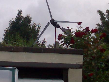

Well I finally got a mill up at the weekend (Mk3!) and we had some decent winds.
This is a simple DC motor (4800 rpm at 180v)with set of 90ish cm PVC blades.
No idea what sort of RPM the mill was getting but it seemed quite fast (over 300rpm I would say). Problem is the power coming out from it is no where what had expected or hoped for.
Before it went up I did some hand cranking - at a low turn (say 60rpm) it was generating 7/8 V and with a good spin it was getting 15/16. However now it is up it rarely gets near 6 and is more like 3 in a normal wind. I have no idea were the loss is and am hoping for some forum inspiration?? My only other thought was building a voltage doubler circuit (or buying one of ebay as my eletronic skills are not that good) though I have found a couple of what looks like easy diagrams.
I am measuring the voltage directly (no capacitors/diodes in the way) via a cable attached to the 2 outputs from the motor. I have also put a picure below of the Mill.
Ideas anybody?

G'day Piercy,
I can see the effort you have put in and it is disheartening when performance is so dismal.
My first impressions were, What long skinny blades,and Gee that's low to the ground considering the surrounding environment.
Yet you estimate 300rpm and with open circuit you are only getting 3 to 6 Volts whereas when spinning by hand you got 7 to 8 Volts????
Seems to me you've got some wiring wrong. Is it a brushed motor?
I wouldn't go building a voltage doubler until I found the fault.
Don't try to optimise the prop for example until you are getting an output consistent with your hand cranking bench tests.
With what you have described it points to being something that has changed between hand cranking and flying. This means it can be found and fixed.
Let's see what other members say. A different approach, or simple suggestion might be just what is needed.
Gill EDIT:
P.S. The prop shaft seems offset to the gen body. Is it geared??? Edited by Gill 2008-08-21
Cheers Gill _Cairns, FNQ

Hi Piercy.
Yeah I agree with Gill, I think you need to do some fault finding to see whats changed since your hand cranking test. I would get it back on the bench and try the hand crank test again.
Judging windmill RPM by eye is difficult, but here's a little tip that might help. Wrap some black tape around ONE blade only. It divides the number of blades you need to count by 3, trust me it makes it a lot easier to comparatively measure RPM.
Gill
Thanks for the fast response. The offset is due to the bearing the shaft is on. Its a bolt on job but the bearing also has rotation (a bit like an elbow joint) so it keeps moving in its socket. Mind you it did not seem to matter as it was still getting a decent spin!
Yes its a brushed motor - I was wondering about the actual cable - I am sure I read somewhere you can lose some Voltage across specific lengths and size?

Sure, Voltage drop for long runs or fine wire is a problem. However, your voltage drop is too huge to be that.
Rather than guessing, how about an ohm meter testing for a high resistance somewhere in the circuit?
