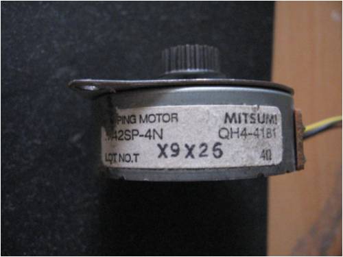

hear are some picures of my motor .. I got it out of a cannon BJC-256sp printer which broke down.
for more photos please go to the link at the bottom of this post(they were too large to post in this forum). I captured all the labelling and text on the outside of the motor in these photos.
dinges: "are you sure you've connected the right wires of the stepper?".
yes i think so. One way of connecting them didnt work at all so I tried the other way and I got the tiniest amount of light out of the LED. I think the motor should give me more energy than this. The RPM is approximately 252.http://flickr.com/photos/9937638@N02/

Ok, those pictures help some (mostly to verify that what you have is *really* a stepper in the first place).

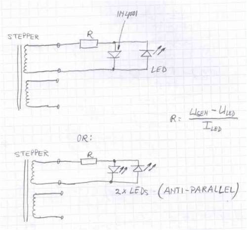

If not, there are ways to wire it up without the external rectifier that would still make it work. The external rectifier in this case drops quite a bit of voltage (~1.5V). Normally this isn't much of a problem but in your case, with such low output voltages, there's nearly nothing left at the output of the rectifier (or diode, in your case). So we'll have to try to get rid of the rectifier.

In any toy project where no energy storage was involved, I would only use a DC brush motor as a generator. There are plenty in the 1-5W power range. These could come from junked video or tape plyers. Just connect up the led with a series resistor and place across the motor. The direction of blade rotation determins which way to connect the led.
At the low power and voltage levels, it is pointless to add diodes and have to spin faster than needed.
In an AC output machine, I would use 2 LED's back to back and a resistor across only 1 winding. No need to complicate with more phases.
