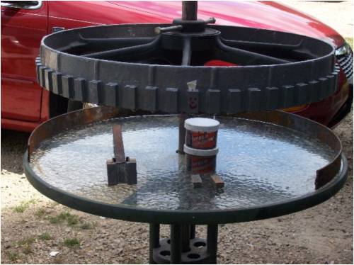

THANKS PETER
I will have to go with the full mechaniical details option since i can't draw worth a crap.
Magnets
1x2x1/2 N42 grade
54 or 66 ?
Rotor
32in diameter
13 mm average thickness
No. of spokes?
Width of spokes?
Hub hole is 1 5/8th
Can you go by the pic i uploaded in my last posting or the Other ones
The outer band(no mags) will be adjustable between 1/2 and 3/4 airgap and is 3/16 thick.

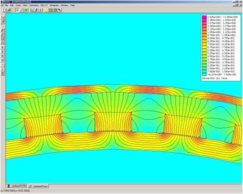

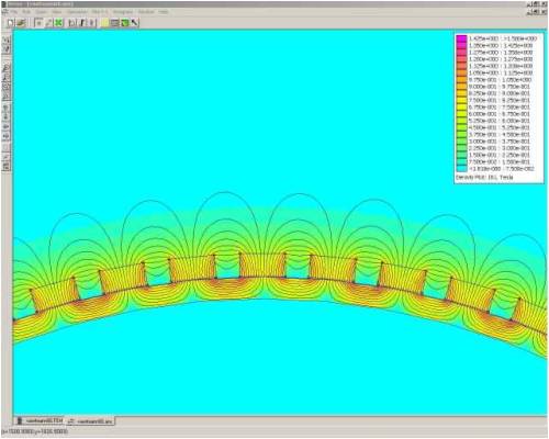

Mark, see the results below. I simulated using N40 instead of N42 as there's no N42 available in the FEMM library. For comparison purposes between the 54 and 66 magnet variants it doesn't matter.
The 54-magnet variant in close-up:
And for the 66 magnet variant:
The high-resolution images can be found here:
http://picasaweb.google.com/motorconversion/Temp
(click on the magnifying glass to zoom in on the details)
I made sure both scenarios have the same colour-legend so you can more easily compare the two. As expected, in the case of 66 magnets there's a bit more flux shorting. Also notice that in both scenarios the flux densities are rather small, in the 0.3-0.4 T range at the stator. This shouldn't come as a surprize for an aircore radial flux generator.
Which is best ? Hard to say. In the 66 magnet variant there's definitely more flux shorting/leaking from magnet to magnet, without being useful in the stator. I'm curious as to other opinions in this matter, but it may just be that the extra 12 magnets may give not much better results because of this. Not sure how one could easily quantify this though. What I did so far is simply count flux lines and guesstimate that only 1/3 (and likely just 1/4 in the 66 magnet variant) are actually useful (at one magnet-thickness away from the magnets).
Of course, much also depends on how thick you will make your stator. I think the above results show that the thinner your stator is, the better the results.

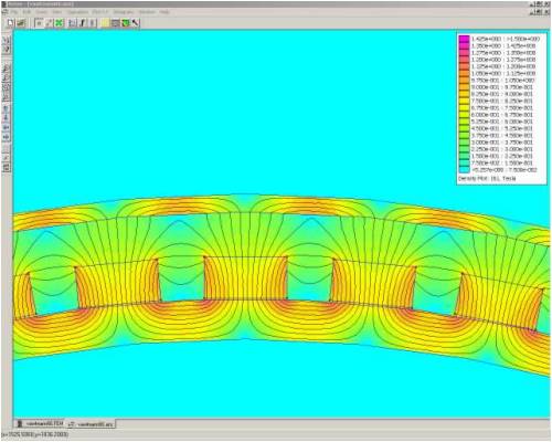

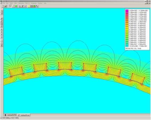

Here are the corrected simulations, sorry for the delay.
54 magnets:
66 magnets:
As you can see, there's slighty more flux shorting in the 66-magnet variant, but the difference is much less than without the steel outer ring, as was to be expected.

On the last simulations the lines flatten on the outer edges of the steel.Would that simulate slight losses there?No big deal though i would think.
I've spun it to the upper range of the turbine(180rpms)and looks good.Spent alot of time building the shaft.
Would you be interested in X20 reverse direction speed increaser for payment instead?I have many thoughts for it but i have 2.I will upload a pic of it if your interested.FREE for you
Mail me your shipping addy.I know your out in the boonies but thats o.k
I think i'll leave it at 54 based on the femm.

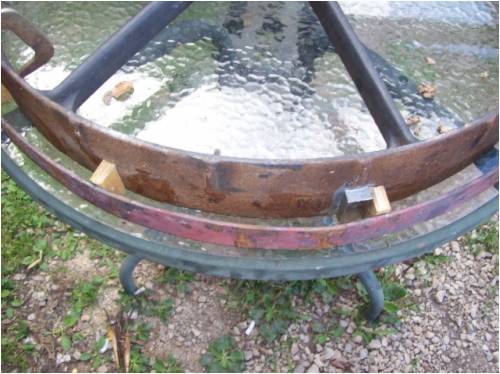

Posted: 01:34pm 30 Aug 2008
Mags are on Now to start on the outer band.Part of it is on the table.
