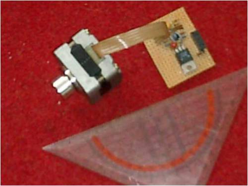

Now that your power requirements are so much smaller than initially stated (2.8W vs. 20W) you may actually get by with a stepper motor (can be found in 5 1/4" floppy drives, old printers, scanners, etc.)
These easily put out 40V+ just by handspinning them, but their current is very limited, maybe just 100mA or so. If they don't produce enough power you could even install 2 or more per turbine.
The advantages: cheap(free if you know where to look), easy to acquire, easy to use (no DIY genny building needed). Power is very limited but 2-3 W may be doable. I've built a tiny genny too like that once (handcranked) and it lit up white LEDs just fine:
Definitely have a look at this story by Gizmo too:
http://www.thebackshed.com/Windmill/assemblyMini1.asp
