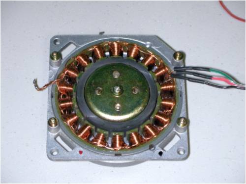

Okay.. I'll give you all the information you want.. Here is the picture of the motor before any modification:
This thing came out of an old DLT tape backup drive. Actually, I got two identical ones out of the drive. The size of the motor is about 3.5 inches diameter and about 0.75 inches thick.
yes, I am aware this won't produce an enormous amount of power. What I'm wanting to do is build a small wind generator first (maybe 4 feet in diameter) as a learning experience and so that I can experiment with different types of blades and fabrication techniques. Once I'm satisfied, I'll move on to building a much larger one.

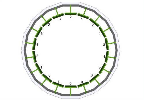

I have taken the motor apart and I have started to unwind it keeping track of how it is wound. I was actually surprised to learn how it was wound. There are 32-turns on each pole. It doesn't really make sense to me. It has 18 poles and I would have always imagined that the 3-phase system would have been wound like 1-2-3-1-2-3-1-2-3, etc.. But it is actually like this:
They aren't spaced exactly even which I thought they would be. Would there be any advantage to re-winding them 1-2-3-1-2-3, etc?
I found some magnet wire at Radioshack yesterday evening but the spool was so small I don't think it is long enough to give me 320 turns per pole. I'll need to buy a spool from the internet.
So anyway, I plan to wind this thing back up in whatever arraingment makes it best suited for generating electricity for charging a 12V battery (so around 15V to 16V, I would think)
As for the person who said this motor isn't suitable. Well, I think the size is perfect, and the re-winding will be a learning experience for me which is what I wanted. So I think it is a suitable choice. I just need to figure out what I'm doing.

I tend to agree with Vawtman that the motor isn't suitable if you want to produce useful amounts of power, but if you want to just play around, learn and experiment it'll do fine. I have in the past seriously considered experimenting with a similar motor myself. Vawtman prefers to spend time experimenting with VAWT windturbines that others consider to be unsuitable. That doesn't stop him though. Neither should his remark stop you from doing what you think is best in your situation. You're the only one who can judge your skills, time, interests, desires and how to spend your resources on them.
I hope you haven't progressed too far with unwinding yet. I was going to tell you to make very good notes of the order of the coils (1-2-1-... in your case) AND the winding direction of them. It's possible (in fact, likely) that different coils within a phase (say, phase 1) are wound in different directions; some clockwise (CW), others counter-clockwise (CCW).
The reason they may use different winding directions is because of the number of magnetic poles on the rotor (in your previous post you said 'it has 18 poles' but that's incorrect, you have 18 stator slots. The number of magnetic poles on the rotor could be (and most likely is) different from this number).
If you haven't kept track of the winding direction not all is lost yet. You'd have to find out how many magnetic poles there are on the permanent magnet (PM) rotor. You can do this by taking a small magnet and moving it past the rotor. You'll feel areas where the magnet is attracted and where it is repulsed, with little 'humps' in between where no field is felt. I usually draw a little mark on the rotor there. Go around the entire rotor like that with a small magnet, and then count the number of poles. Then, go to this site (German, but very good; use an online translator if your German is underdeveloped):

Thank you for the detailed reply. Unfortunately, I have already removed all of the windings and as you guessed, I did not pay attention to the direction of the windings. However, I still have another, identical motor, that I have not yet disassmbled. So either way, I should be able to find out how it is done.
I realized that the motor wouldn't give me much power because of its small size. But it sounds as if you are telling me that another motor of similar size may be able to give me a lot more power than this one. If so, that is the direction I need to go. I want to have it as efficient as possible in a 4-foot diameter turbine so I'll have accurate numbers to compare to when I build a larger one (which will be using the most efficient motor I can buy/build.)
Any suggestions on where to find a suitable motor in this size range?

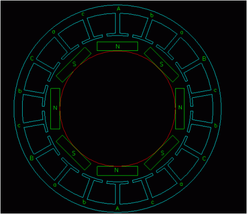

Maybe you could check but I *think* your rotor has 10 magnetic poles; when I enter that number (18 stator slots, 10 magnetic poles) into the calculator (http://www.powercroco.de/Kombinationstabelle.html) I get a winding scheme similar to yours: ABabcBCAcabABCbcaC (with A=2; B=1; C=3). Maybe you can verify if the rotor has 10 magnetic poles, if so, you wouldn't need to take the 2nd motor apart.
Not sure if other motors of similar size will be better suited; I can't think of any, at least. I'm working on a 1.3-1.5 m turbine of about 100W and its size is substantially larger than your motor ( http://www.anotherpower.com/gallery/album69/blue_boy_stator_ gutted)

Hm. When I enter 8 magnetic poles (18/8) I get another winding scheme that is different from the 18/10 scheme but ALSO exactly fits your pattern: AbaBcbCacAbaBcbCac (again with A=2; B=1; C=3). It has the exact same order as the 18/10 scheme in my previous post but differs in the winding direction (CW/CCW) of some coils. So your rotor might just as well be an 8 pole.
Safest way would be carefully to count the number of poles on the rotor and continue from there. Or unwind the other motor as you planned.

Under the "things you learn" category, I too would have thought a 3 phase set up would have the coils in a 1-2-3 pattern. Seems intuitive .... but apparently not!
There is a recognizable pattern in the 18 coils tho. 18 coils/3 phases means 6 coils per phase. The 6 are split into 2 sets of 3, which are diametrically opposed, and the middle coil is wound opposite in every set.
That makes me feel better somehow! LOL!
How the timing could possibly work with 8 or 10 poles, or 42 for that matter, makes no sense to me at all, but I'll keep lurking along and learning ....

  pntrbl said   How the timing could possibly work with 8 or 10 poles, or 42 for that matter, makes no sense to me at all
I find it really helps to draw these things out:
Take a look at a single phase, e.g. phase 'a/A'. Notice how, at both the 12 o'clock and 6 o'clock position, the stator tooth is close to a N-pole on the rotor. Call this 'A' (capital A, wound CW). Now have a look at the 'a' at 2 o'clock, 5 o'clock, 7 o'clock and 10 o'clock. These are instead seeing a S-pole of the rotor and thus are wound in the opposite direction, hence 'a', CCW wound.
The same goes for phases b/B and c/C.
There's actually some logic in there... and it becomes much more understandable if you make a quick sketch of it.
I must admit these are a bit complicated examples with strange winding schemes. In practice we can often wind ABCABCABC (or 1-2-3-1-2-3) because we choose a pole number that's a sub-multiple of the number of stator slots. E.g. in the case of a 'normal' motorconversion with 36 stator slots and a 12-pole rotor the winding scheme is a very straightforward 1-2-3-1-2-3, with all coils wound in the same direction and following eachother in strict order. Besides, in 'normal' motorconversions coils span several slots, unlike in the example of the original poster where each coil is exactly one slot wide.
Confusing ? Naah.... Edited by Dinges 2008-08-09

That is a nice CAD drawing, what did you make that in? I made the other one up above in Google Sketchup. Adding the magnets with their poles in the picture does clear things up a little bit.

1st I'd like to agree with adric22 that that is a fine CAD drawing Dinges, and then add my personal Thanx for taking the time. A sketch makes what's happening in there abundantly clear.
I think it's starting to sink in now ......
