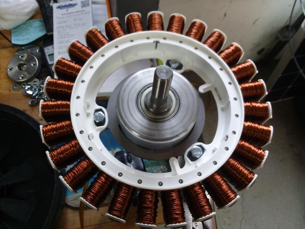

Hi all. New to the forum and windmills and have a couple questions. I have a new F@P-640 that leaves me with a problem. It has just as they claim no cogging but as soon as I hook it to my 90 amp rectifier and that to my battery it has quite a bit of drag. Still testing it on my bench but I doubt my LENZ2 VAWT is going to turn it. Rotating by hand open circuit it does 50 vac and turns nice and easy. My 1st question is, if I use an MPPT controller will that lessen the drag to rotate it? I first tried a HAWT with Raptor 7 blades but in my residential area with buildings and trees the wind switches from all directions keeping it searching and rarely turning. So I built a VAWT with the LENZ2 type wings. Neither of these would overcome the drag of the new F@P-640 or my stock wired 36 pole F@P. That's why I bought the F@P-640 cause there is no cogging. But, as I said the drag over 20 RPM is to much to overcome to get any power out of either. So would an MPPT controller help to ease the drag and get more then 20 RPM from either of these motors? Next question is if I rewire the 36 pole which has the 12 large magnets will that reduce the drag that occurs from putting a load on it? If so which wiring configuration would be best for a 12 volt slow turning VAWT. I've read the F@P-640 may have aluminum windings so rewiring it may not be so easy. But, what configuration would work with 27 poles and 36 magnets that it has for a slow turning 12 volt VAWT? I'll try to add pictures of the F@P-640 with it's 27 poles and 36 magnets for anybody that wants to see one as they don't seem to be around much. Any comments or advice would be appreciated as the windmill thing doesn't seem to be working out for me.

Thai
Joined: 22/05/2018
Posts: 30
Posted: 08:16am 02 Aug 2020
