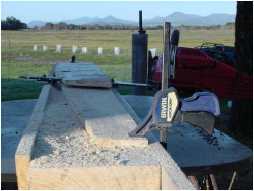

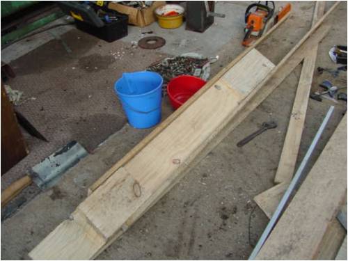

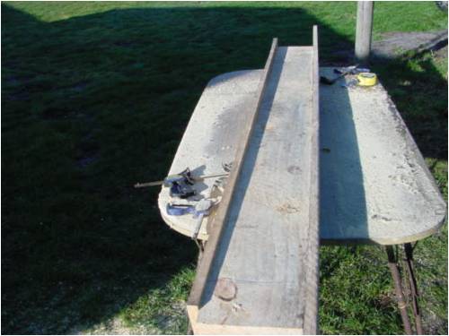

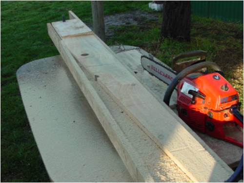

Here is the 20 minute jig I came up with. It uses the Dans 3 degree at the tip, 6 degree at the center and extrapolate to the sensible end of your timber size, and blade thickness= 1/8 blade width, and best line of fit from the tip to somewhere near the root.
It consists of two pieces of 3x1 down either side of my 4th piece of 8x2 timber I had. It is 2M long.
Here is a timber blank sitting in the jig ready for "processing" It needs to be held down while slitting obviously, and I used the clamps for this.
Here is a full view of it..... yes lots of pictures just in case anyone else is silly enough to try it.

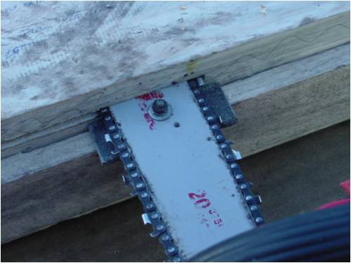

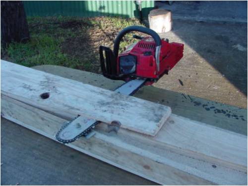

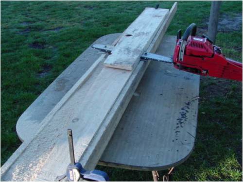

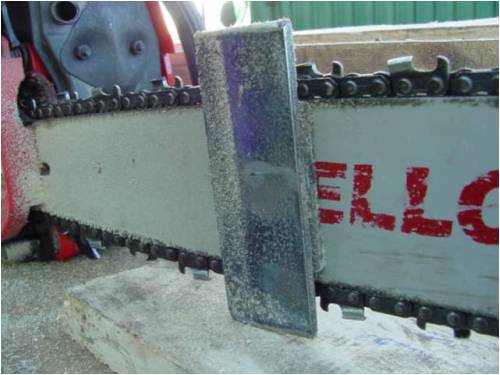

Well now I guess I must show how we get the chain saw to follow the jig we have set up.

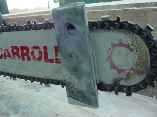

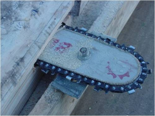

It was solved simply (like all things I do) by just welding a few bits of steel 6mm strapping together to give me 12mm thick bits, boring holes through 2 parts of the blade bar, and installing the guides with some 6mm bolts. It looks like this:
and one for the other extremity like this:
It turned out that they allowed exactly 10mm clearance from the jig to the cut wood. The side pieces of timber were offset 10mm too low on either side from our actual line. This meant that when I cut along the jig, sliding along on the skids, I will be cutting 10mm above the jig line

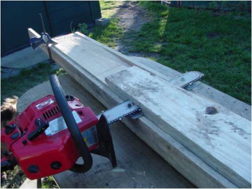

Here are a few pics of how that looks:
Here we are part way through

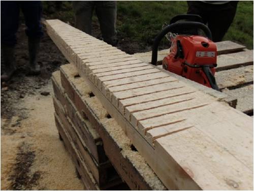

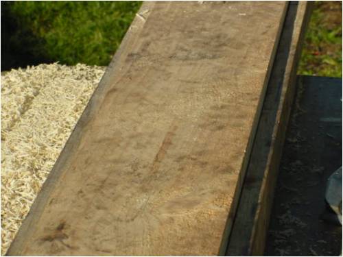

I suspect we all have the idea of that part now, so here is a finished raw cut. The finish is the same as a fence paling, or a weatherboard. So very happy with the finish, 2 minutes with the planer and the leading face was virtually complete. From start cutting to finished cut and plane, was only about 10 minutes. This beats the hell out of half a day or more doing it with the saw and chisel.

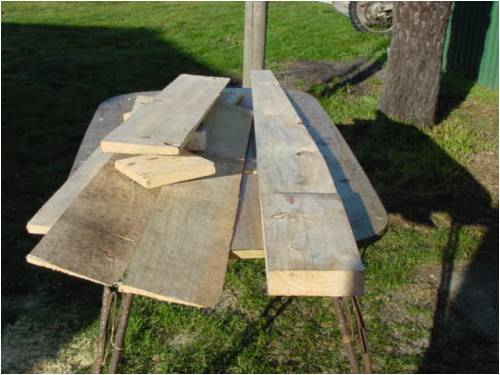

Here is the remains from a few cuts. Thats a lot of timber I don't have to remove by hand.
The three blades and all the angle cutting is finished. It took an hour or so do make the jigs and guides, an hour to cut all the blade blanks. This is the fastest way I know of cutting blades of this size. If I had built the jig a bit less flimsy, you could pump out blades all day long.

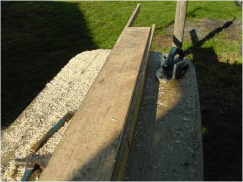

A second jig does the rear of the blade (airfoil side) and is every bit as quick.
And now just have to plane the camber for the airfoil side. May make a jig for that too, but the planer will probably be fast as well as there is not lots to get rid of. The hard part is done.

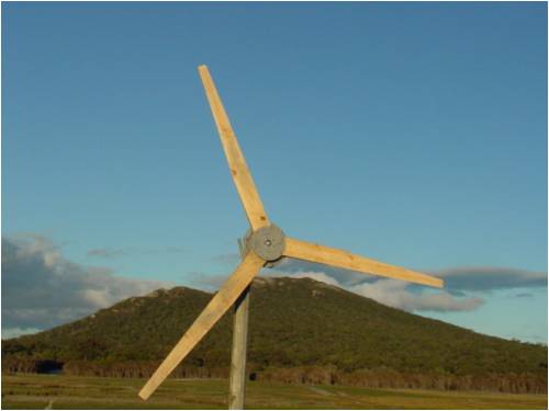

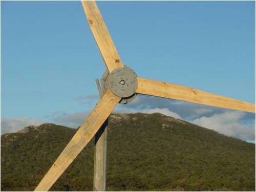

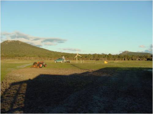

Well today was the day the chainsawn blades took to the air.
It was on a small 3.5m tower just for testing and trimming the turbine.
They worked unbelievably well. As is customary when you raise these things in the air, there was barely a breath of wind anywhere... in the roaring forties in winter.. no wind.
The breeze was so low that I could barely feel it on my face, so I estimate about... 3mph.
With the blades not balanced, they would not even rotate. After balancing (with some magnets and spanners magnetically glued to the front plate), it slowly started to spin up. I could barely detect any air movement. Quite suddenly they gripped whatever air was there and you could hear them cut the breeze, even though I could barely feel it.
Here is the test site, the trees are about half a kilometer away from the mill.
I was dumbfounded, with almost no detectable air movement, the damn things were trying to cut my head off. They were putting out 27v in virtually no wind.... no power mind you, but I would not have suspected that they would even spin under their own power.
I didn't have any batteries on hand, but I did bring a 415v 3kw induction motor .. just to put a load on the alternator .... on the off chance a gust came along and it became unruly.... and it did
A gentle 5-10 mph gust came through, lasting about 40 seconds at best, and it took off and drove the big 3 ph motor at a very respectable pace.
So I was right, these are high TSR blades, too fast I think for this alternator, as it is very electrically stiff for battery charging. They make a slight swish noise from front and rear, but eerie silence out either side.. very odd... no detectable sound at all out the sides.
I have not been face to face with blades of this diameter on a basically frictionless alternator before, but is all a little bit scary when you are both at ground level.
Here it is a bit closer.
Anyway, the chainsaw blades are very impressive performers on their first windless day out.... and no I haven't built the tail yet.
........oztules

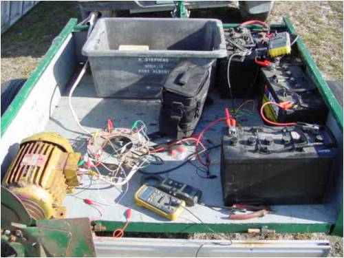

Ok, Test results

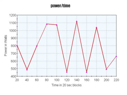

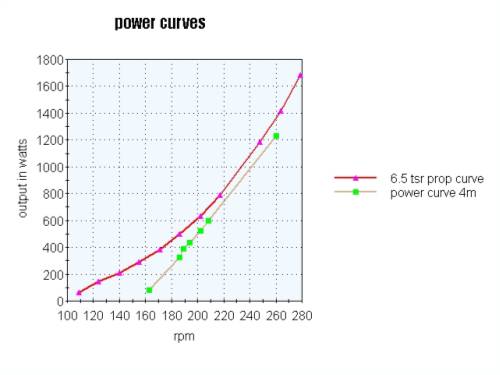

Here is a graph of rpm/watts. I have placed a line of best fit for the prop curve. TSR 6 was just far too much, TSR7 and the figures were impossible. TSR 6.5 closely fits the results, and the wind conditions on the day/s. According to the weather man, no gusts were recorded greater than 30kmh so TSR6 was not possible by a long way. It was a clam day by our standards. I think 20 mph would have been as good as it got. (32kph).

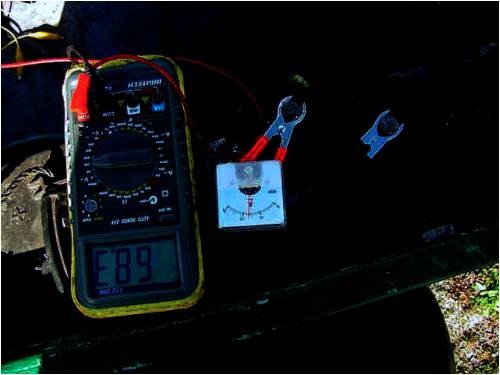

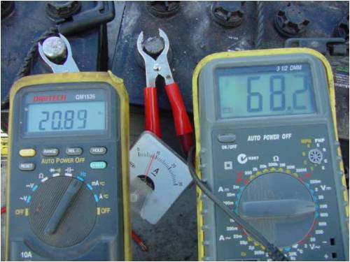

I was not good enough to read three meters at once, so had to use a camera to do it for me, and this had it's own problems. The other problem was the sheer amount of power going into the batteries when I started this. They were truck batteries(which I grabbed out of the grader and dozer just to have a 48v load.
They are 700cca batteries, so I thought they weren't sissies, and that they could stand a bit of a belting ....not so
After setting things up in a small trailer, and getting organised, the batteries went from 13v/batt to 17v/battery in no time with 20 or so amps pushing in....
So the first shot looks like this 68.3v@18A= 1230 watts, and the batts didn't like it much.
So I waited for the wind to die down a bit (didn't feel very strong at all anyway). Later in the afternoon,it was peaceful, and the readings looked more like this...still high voltage, but amps had calmed down a lot (batteries won't love me after this.
Meter on left is rpm/10
Note the voltage is about the same, but the batteries are not taking much charge now and probably only registering electrolysis if the truth be known. Had to stop this pretty soon, but took a number of readings... hence the graph.

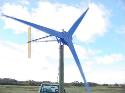

The blades have now got a few coats of epoxy paint on them now, and look like this:
The tail is temporary to get the right weight and size for furling.
All in all, these chainsawn blades work far better than I had expected for such a quick effort.
Here is a pic of the test setup including the three phase 3kw motor I used as an initial load, it went over 1440 I think, and created a lot of air flow with that fan. At one stage the mill was driving it full speed and putting 19A@70v into the batteries at the same time (1.3kw for batts plus another 3-400w for the induction motor.... )
For those wondering what the performance is at ground level with a mill, here is an example of a few minutes power recording every 20 seconds.
That should read time in seconds. The interval used was in 20 sec blocks...

On your trailer you hook wires up on a ring thing between yellow motor and black bag so can you tell me what is use for ? and also stator coils are 100 turn 1.8 wire so how many ohms on each coils ? thank ian
