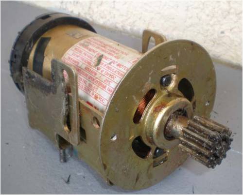

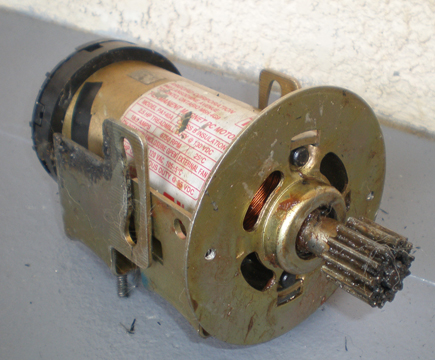

i have just purchased this DC motor(DC 130v 2 1/2 hp Permanent Magnet MOTOR, WIND GENERATOR) from Ebay and i am not very happy with it. it is very hard to turn because of the carbon brush and it cost me a fortune and i don't think i will be able to use it as a wind turbine. will do some experimenting s during the weekend. already cut out the blades in PVC s. Has anyone out there ever used this type of DC motor for a wind turbine?

Do you have a link or pic of the nameplate?

I have been competing with you on ebay for a decent dc motor recently
If I am not mistaken, you are describing the "treadmill duty" motor?
From my findings, many of the treadmill type motors are rated upwards of 10,000 RPM at 130 volts, from what I have heard/read on the subject, the "rule of thumb" is to quarter (1/4) the input ratings of the motor (from the data plate or spec sheet) to get approximate expected output, (derating by 3/4ths or factor of 4) I forgot which site I read this information on, and have yet to confirm or deny it to be accurate.
If, indeed this is the case for dc motor sizing for wind genny use, and you indeed have a high rpm treadmill motor, they very well may not be too suitable for direct drive wind generator applications.
From what I understand you should look for a reasonably low RPM rated PM DC motor (like 1725-2500 or so) with the highest current (amp) rating and voltage you can get ahold of.
The reasoning behind this "quarter derating" theory suggests that, if you take one fourth of 10,000rpm, and one fourth of 130 volts, you will still require 2500 motor shaft input RPM from your propeller to produce about 32.5 volts. (that will still charge batteries but the RPM, to me, seems still a bit high for a small PVC bladed mill)
Using 3-4 ft pvc blades, I would guesstamate about 400-600 RPM at the most ??, in hurricane type winds ??.
(I dont know enough math to back that up and it is only a wild guess since I dont own a tachometer capable of accuratly counting the rpms of any of my previous generators, it could be entirely possible and I just guessed wrong.)
That would be a -Derating factor- of about 14, or 1/14th of rated RPM, that fourteenth would then be applied to the 130 volt input rating which would net you about 9-10 volts at 400-600 rpm.
The motor I got (for about $50 U.S. Dollars delivered) was a 3/4 hp 90 volt pm dc industrial type 56c frame (TEFC) totatly enclosed fan cooled motor. These motors are much heavier and better made than the treadmill duty motors and generally have a higher current rating and much lower (1750 +/-) RPM ratings and are also continious duty motors as where the treadmill motors are intermittent duty, not to mention the sealed ball bearings as opposed to the brass sleeve bushings in the treadmill motors.
I could be way off base in my advice to you, but, it the information I have been going by in my search for a permanent magnet motor
if you can gear it at all, that would aid in acheiving the higher rpm needed to operate correctly ??
Hope this helps and if you can provide a spec sheet or even a picture of the motor it may help.

I think he means this one
http://cgi.ebay.com.au/2-5hp-130V-DC-motor-Wind-generator-w- Flat-Base-Mount_W0QQitemZ130242013149QQihZ003QQcategoryZ1218 37QQssPageNameZWDVWQQrdZ1QQcmdZViewItem

sorry for my late response, the model is the same one as Allan mentioned, only the bracket is different (http://cgi.ebay.com.au/eBayISAPI.dll?ViewItem&item=13024254 6823).

I looked into the motor that was posted by Allan as your link did not work or was expired.
That little gold motor is indeed, a treadmill duty motor. It appears to also be -continious duty- rated, for its 1.5 hp rating@ 95 vdc so I will use that figure.
However, its only rated 6750 RPM and not the 10,000 that I expected, I still believe that without gearing, your 6750 rpm is just a little high when de-rating for wind generator uses.

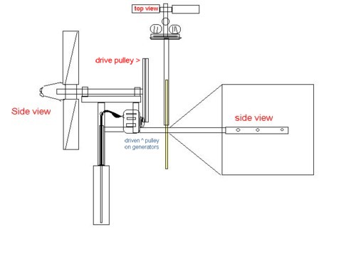

Dodgeman, thank you for writing back. i must say you seem a passionate person just like me. the calculations that you gave me sound very reasonable. i will have to redesign the system, taking into consideration that i can not drive the motor directly with the blades and will have to use some kind of gearing like you mentioned to get a good voltage (12V +) to be able to charge a 12v battery.
BTW do you have a design or picture showing the gearing of a motor from prop to the motor shaft? this will be helpful. when i mount my tower i will have a go at fixing the blades directly on the shaft, see how it goes and record the voltage. then i will have to rework the gearing part again.
thank you for the info.

Asvin, Thank you, I just like to understand what I am doing, and I do like to help people any way I can.
The only suggestion for gearing that I have is a design I drew up some time ago for a fan blade I had gotten for free, which I had intended to make into a large wind generator in the future
It is just a quick paint shop sketch of how I had planned to make it, I was planning on having the prop attached to a drive shaft, which will turn a pulley, which will, in turn , spin the smaller pulley on the generator. in the diagram I was thinking of GM alternator conversions but any dc motor should work.
I have started smaller and began my actual experiments with dc motors and direct drive instead of rewinding alternators yet.
I hope that helps, I am off to bed now, its 11:38 pm here and I work at 5 am, I will check back tomorrow.
Nice chatting with you, and I hope we can learn from each other.

Posted: 04:44am 06 Aug 2008
thanks for the design. very interesting. will keep you update.
asvin.b

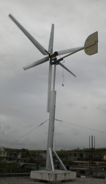

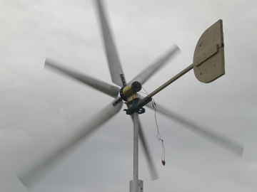

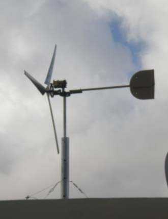

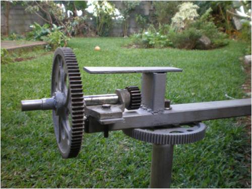

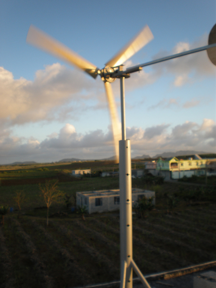

Hello I’m back. Hope you have been well. On my side i have made some progress since my last post. I manage to build my tower on my roof. Please see pictures. The pole is 10 cm inside diameter and is very heavy (6 feet high). It has two 40mm poles as supports with a base in concrete 4 by 3 feet. The concrete base was sealed on polystyrene to absorb the vibration and reduce the noise level.

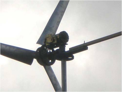

After a lot of trials and errors, I have been able to design and make a head base for the wind turbine. Base on your advices I have included a gearing system. The blades are made in PVC and are around 3 feet in length.
Yesterday I connected the blades on the tower and it work just fine. It turned like mad. I even got scared at one point. It was noiseless and there was no vibration. I further added metal wires to support the tower as an extra safety measure. I left it over night. I guess this was still the easiest part although it took me a while to gather the entire spare parts and getting them adjusted/ modified.
The biggest challenge was to find a way to connect the 12 DC motor to the head and getting it to work. I spend all my Sunday trying to do that. The engine was fixed on top of the front part. It became very heavy but nevertheless manages to place it on the tower.
The problem is that because of the gearings it became slightly hard to turn by hand and therefore did not turn at all even in strong wind. I made lots of adjustments to make the gearing smooth. When I turned the blades by hand, it does rotate to around 10 times but then eventually stopped dead. I need to find a solution to my problem and I am desperate now.
I still need to take a picture of the turbine with the DC motor attached to it. Please advice.
asvin.b

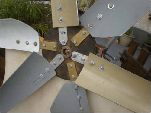

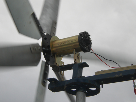

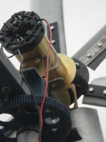

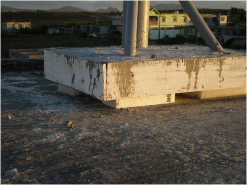

Posted: 05:51am 01 Sep 2008
just posting some more pictures of my wind turbine with the motor. will try to get a close up later on.
cheers
asvin.b

Hello again,
Good to hear from you, and nice to see that you have progressed, Your whole machine looks very stong and capable to me.
I love your tower too, I know my tower needs work to be as sturdy looking as yours
(I have recently regressed rather than progressed, but I will post about that in my other thread

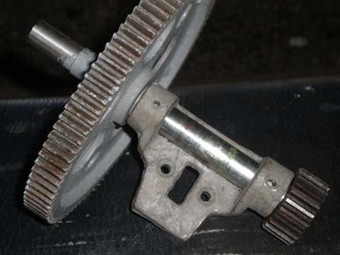

I think your gear design looks great also, I would like to know, What that gear assembley is from ?
From the pictures, I cannot see why it would not spin in the wind.
I do believe that there may also a "magic gear ratio" that must be found in order to compromise between startup capabilities and RPM at a given windspeed.
Unfortunatly, I am afraid that, that "magic ratio" will probably have to be determined by repeated trial and error.
For mine, I was looking at starting with a 2.5:1- {1 drive shaft RPM to 2.5 motor shaft RPM} to begin with, this should put my motor RPM up in the 500-600's in good wind (I really need an anemometer also)
What gear ratio do you figure you have there? I am guessing here,, but I counted what I could see in the top picture and guesstamated about 60-70 +/- teeth on the large drive gear and about 15-20 +/- on the driven gear (<motor gear)
I am assuming this ratio, but, 65/17 gears would give you a ratio of 3.82:1. That would speed your motor up quite a bit, but as the ratio increases from 1:1, it gets proportionally harder to turn, Your description would make sense as to why its very hard to start, especially if your motor has strong "magnetic cogging" also.
If I understand correctly, you said that: "it spins like mad without the motor" ??, with no load on the Prop?
or, do you have the motor loaded as well? With a DC magnet motor, it will become harder to spin, as it encounters electrical resistance from the load.
I wonder, if your wires may have been shorting to ground? causing difficult startup/turning of the motor?
I also wonder, if 3 ft PVC blades are long enough and/or wide enough to to catch enough wind to get it moving with the motor/gear resistance.
Also, is that drive shaft mounting apparatus a ball bearing carrier? or is it a sleeve/ bushing type? It's tough to tell from the pic.
(as I am sure you know>)a bushing would create some added rotational resistance as opposed to a ball bearing setup.
I sincerely hope that I have not advised you wrongly by suggesting the addition of gearing to your mill, I know how much work it all is to put together, I do plan to gear my current motor as well.
From my non-geared experiments, I have been unable to produce the continious voltages I am looking for, with a direct driven 90V/DC motor generator.
Please keep us posted in your progress and keep at it, you have only discovered 1 way that it wont work, 999 more to go and you will have it
DM.
it came from an old textile machinery.
well the gear on the dc motor is around 3.5 to 4 cm in diameter and the one in the picture above is around 15 to 16 cm in diameter.
If I understand correctly, you said that: "it spins like mad without the motor" ??, with no load on the Prop? or, do you have the motor loaded as well?
it spin very well with no load. also i don't think there is any electrical resistance because i did remove the carbon brushes from the engine as i thought it was causing some kind of brake.
It has not ball bearing. it a part that i found and which was used for something similar in a machinery part.
