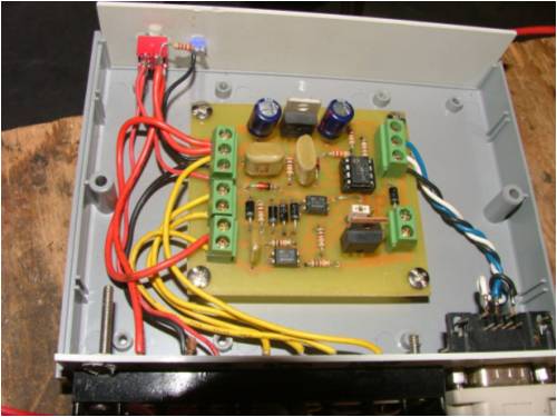

hi glenn and thanks for the pic log info,
i have just finished the board and have a few questions, sorry if i repeat some already asked.
the caps on the diagram shows 0.01uf i ordered some but there completely different to the ones on the photo of the board, mine are quite a bit smaller, is there a perticular type i should of got, the circuit diagram shows them as 0.01uf 63v, are they electro caps or ceramic?
also could you please draw a pic for me of the terminal connections as they are on the board, IE bat pos, neg, windmill +, _ inputs, dump and a/c inputs, and serial connections; i have worked out a few but my understanding of electronics is limited and i don't want to damage the board by wiring incorrectly.
also on the picture, top l.h.s you can see something attached to the project box and wired to the terminals, it also has a led wired to it, is this a on off switch or something else?
thanks for your help with this, it will be great to be able to test the upgrades or sometimes failures to my mill, only real way to tell if im on the right track.

Without looking at the photo you mention as a reference, I can assume you should know from the photo if the capacitor is a ceramic or electrolytic type. If you can show me the photo via a link to the URL I could help out more
Be aware that some modern caps are much smaller than older ones and still maintain the correct voltage and capacitance values.
Also, an understanding of the circuit should give you an understanding of the purpose of the capacitor and thus the required type...and also the circuit diagram should indicate the type required...try this link to help you out in understanding electronic bits...

martinjsto
Joined: 09/10/2007
Posts: 149
Posted: 11:52pm 24 Jul 2008
thanks craziestOzzy for the reply
the link to the page i am refering to is this
http://www.thebackshed.com/windmill/PicLog.asp
here is the pic

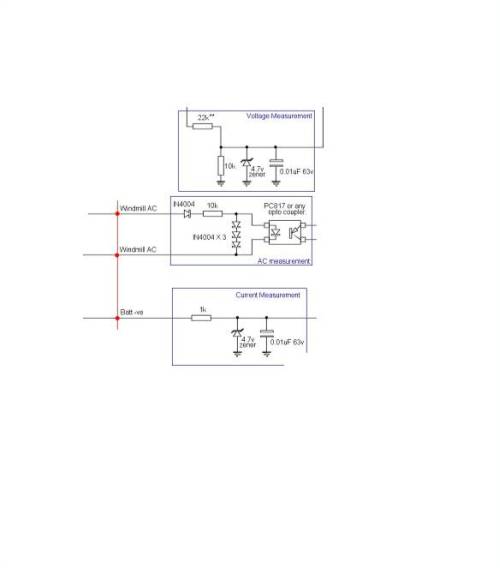

the caps on the diagram are shown as 0.01uf, connected from a pos to neg so i was thinking these are electros but they dont look like them in the pic, i will research the caps more through those links you provided
thanks again for the reply

martinjsto
Joined: 09/10/2007
Posts: 149
Posted: 11:54pm 24 Jul 2008
oh i am referring to the beige coloured caps not the blue ones up top of board

Martin, the .01 caps look to be there just to keep out the noise.
I imagine it makes little difference what breed of capacitor it is as it seems to be mostly a noise attenuator (with a little voltage averaging effect as well).
I'm haven't played with pics and am not familiar with the 08 chips, so don't know what their input impedances might be. If very high, then .01 is big deal, and if low impedance then .01 is small beer.
Either way different types of .01 caps should make minimal difference here.
If truth be known, a fairly wide range of values would make a difference in plotting scatter only. I'm guessing the bigger the value, the less scatter in the results (up to a point)

Oztules is basically right.
I saw straight away from the schematic that the electrolytic capacitors in question filter out frequency noise. The fact that the negative is immediately grounded gives this away, as the circuit is still complete if you were to remove the capacitor completely.
The reason for the different shape and/or colour of the capacitor is due more likely to the fact that basically different dialectic materials are used to filter out accurately a specific frequency from the standard "barrel shaped" "blue" ones. You can be assured that if the "beige" coloured capacitors are marked with a +/- symbol that they are of the electrolytic type you need and not the ceramic ones you feared.
You can get away with any type of electrolytic capacitor when interpreting a schematic, but be aware that some schematics often specify a particular type of capacitor due to temperature/frequency/current experience in circuit. If the schematic specifies a particular capacitor type, it is not advisable to sway from this. If nothing is mentioned that a certain type of electrolytic capacitor is to be used, then any type in general could be used as long as it has the same values of voltage and capacitance.
In summary, some capacitors are very accurate in their ability to filter out a particular frequency range, requiring different materials of construction and creating different shapes and colours to distinguish them from the typical "barrel" cap. The second link I gave you (link) shows the accuracy range as +/- percentage and sensitivity of different types of capacitors to noise filtering.
This LINK shows much about the Picaxe chip...I didn't know it uses BASIC...gonna have to grab me one.Edited by CraziestOzzy 2008-07-26

Martin,
Glenn has used Greencaps(Polyester or Mylar). Greencaps are not always green by the way. You could just as easily use ceramic. Both are easy to get. I very much doubt you'd find an electrolytic below 0.1uf anyway as the standard range ends at 1uf.
It's a great project. Have fun..

thanks for the replyes oztules, craziestozzy and gill, i have finished the board and assembled the unit, seems to test ok but i need a serial cable to connect to pc. i will get one on the weekend so heres hoping for a successful test.
the info you posted links to craziestozzy was very helpful
thanks
i have just finished a anemometer made from old computer power pack fans for the bearing, hub and cage, the bearings are all sealed roller bearings of really good quality and easy to repair, i removed the internal stator and magnets so it spins freely and mounted two new neo magnet pieces inside the hub and opposite each other and then mounted a reed switch underneath. it is very stable and should proove to be reliable. I formed the cups from aluminum sheeting.
i think i worked out the wiring connections on the board
looking at the top LHS i believe its Bat +, Turbine D/C -, Bat -, the next two are A/C inputs, the bottom two are reed input and i think the last is connected to the bat -, on the RHS from top the first 3 are the serial connections and the botton two are for the relay for the dump load. please advise me if you think this is wrong.
thanks again
martin
free power for all
McAlinden WA

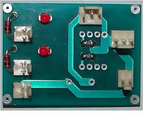

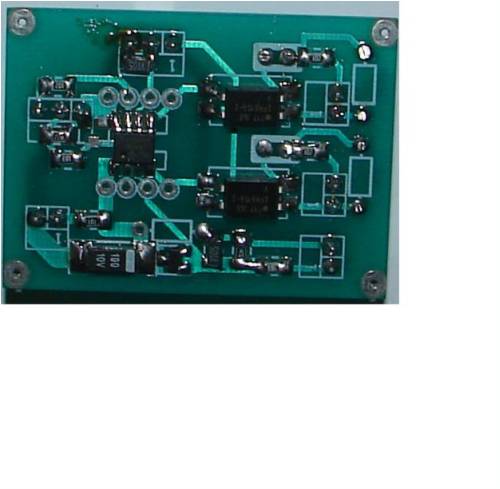

Posted: 11:17am 03 Aug 2008
Hi Martin,
I have made a piclog board with good success. I have attached photos below.
The upper photo is the top side, with the I/O connectors. The lower photo is the component side. I have added input LED indicators for the anemometer and the RPM sensing. The unit is powered from a 5V plugpac, as usually a mains connection is available for the PC logger. The Serial connector is the 3pin one, centre right in the top photo. The components are SMD. The current measurement is for hall effect or shunt in the negative lead. Voltage sensing is scaled to accept up to 65V input. The unit works with Gizmo's code.
I have made a plug in LED that I connect accross the serial output connector and ground to test for cct operation. This LED will flash when data is sent.
I hope you sort the problems with your unit.
Gordon.
