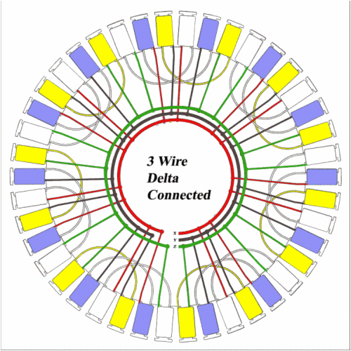

Hi all. Let me say this is a great forum. I have just wired up my first f&p stator. Unfortunately it was a 100 series stator and I wired it up 7 groups 2 pole star. I've since read that 100 series stators are not the go when it comes to HAWTs. I'm just wiring up an 80 series into a delta configuration and notice that no one has published a diagram for 7 group 2pole delta with 3 wires. I believe I have worked it out by combining the 6 wire diagram and the star delta diagram. I will publish a photo and schematic in the next couple of days to check with the forum gurus that I have got it right.

Welcome to the forum. Nice to see you have started your first F&P project. You are possibly right that not every possible configuration has a diagram on this site. Once you understand the differences between the Star and Delta wiring you are able to apply it to various arrangements. I'm sure there is someone here who can critique your proposed layout if you are not 100% sure. Better that than putting in wasted effort and possibly wasting a good stator.
There is an advantage using the 7 group 2pole with 6 wires you mentioned instead of just straight Star or Delta, and that is it can be configured in Star OR Delta should you later want to try the other configuration. This is how I did my first stator. I think you may find Star is for average wind sites. Your proposed Delta would be more suited to very windy sites. Why not run 6 wires (assuming slip rings are not used) down the pole and fit a switch before the rectifier? During the mild seasons run Star then during the windy seasons run Delta?

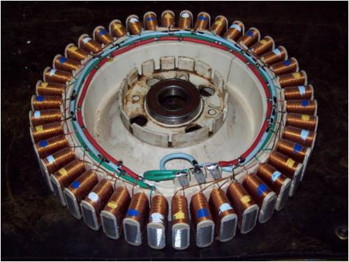

Posted: 10:32pm 27 Jul 2008
Here is the drawing and photo of my delta wired stator. I hope I have got it right or its a few hours down the drain.

Posted: 02:47am 28 Jul 2008
Yes, that looks right by me. I see you've decogged already so all the stator mods are done.
One of my hints is to use hot glue to hold wiring modifications in place. There is a reasonable amount of vibration in use and for general handling as well I find the glue makes for a more robust unit.

Posted: 06:43am 28 Jul 2008
Thanks Gill. I'll hot glue before moving onto the next step of my build. I have put some cable ties around the 3 wires and have covered it all in electrical varnish to protect it. I decogged it on the linisher belt attached to the grinder at work. Did a great job.
