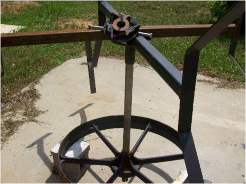

I see the camera works now. What in the world is that ...looks like a one way clutch doing in the scheme of things.
Soon youre gonna have to throw on some magnets and some wire and see what this puppy does.
Is the Vawt ready to test it on yet?

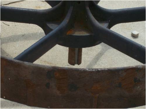

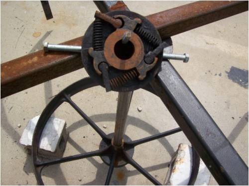

The Wheel is back on it's patio surgery table for the mag insertion and band attachment.I think i got the right stuff for glue.The hub is only one way and the bolts are just there to show where the setscrews will go.
The blades are built but will be the last to install.If you need a pic of them let me know.But you know the shape and same thing
just two more.
Has i said i'm working on the tower.
