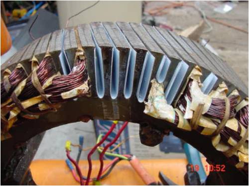

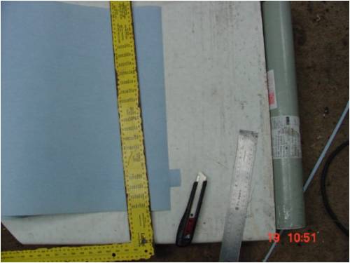

First we have to cut some transformer paper to fill the slots to protect the wire enamel from the steel stator.
Here is the paper that Zubbly sent me.
We cut it up and place it in the slots like so:

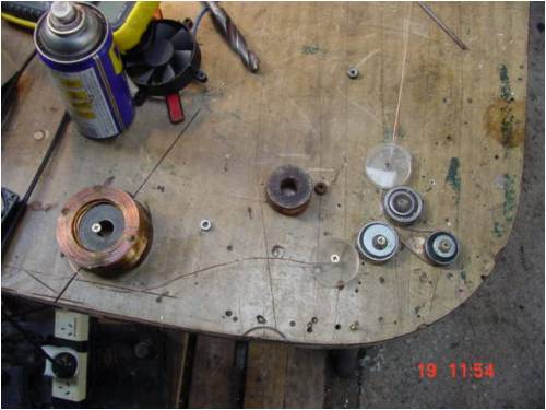

Now we find some likely source of wire to fit our requirements. In this case, the center rotor core from an alternator seems to be .8mm thick, so thats what we'll use.

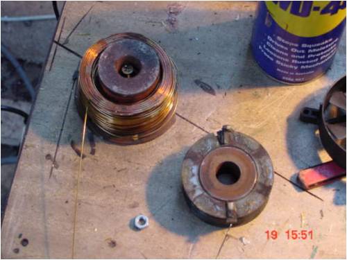

Here are two spools from alternators. One half used already (on this project).
We need to straighten it or it won't fill properly, and this stator is a killer, thin slots, very thin gaps. You need the wire straight or it will not load into this stator. So we run it into a few bearings like this:
The wire goes from the spool through a few bearings and off to the winder (which is horribly basic, but works well)

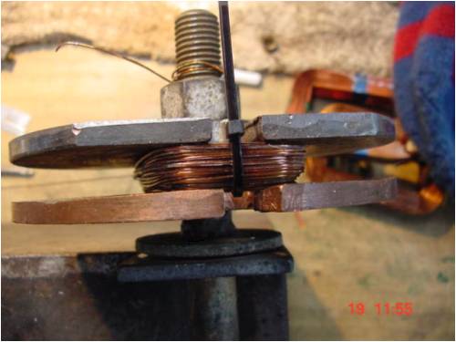

Sadly I forgot to get a pic of the coil itself. I needed 7 of them. 5 single coils, and 1 dual series coil. ie 2 coils wound 1 after another without cutting the wire between coils.

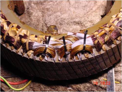

We then place them into the stator and it looks like this

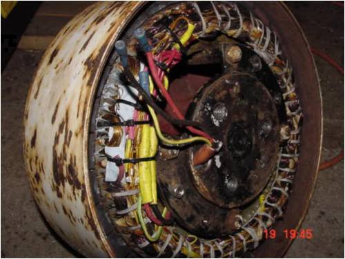

Then it is a simple matter to put it back together and test it.
So here it is temporarily back together to test.

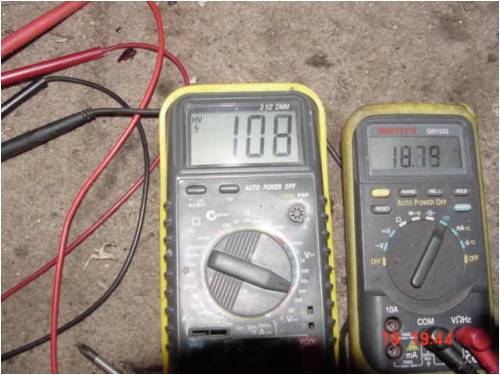

The Ohm test put the phases at 25.1 ohms they were equal, so should be good.
and here are the test results. 108vac. at only 18.8hz
for 30 poles that is about 75 rpm. or 240vac. @ 166 rpm.
Volts on the left, hz on the right.

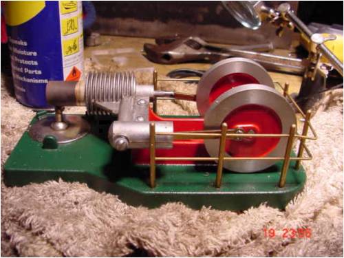

The WD40 was on the table because I was playing with my little Stirling Engine, and I use it as a very low viscosity lubricant on the power piston and displacer.

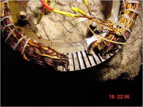

If you look at this:
and this:
you may notice that the outer layer is missing two coils, and the inner layers all need 1. Remember each coils occupies only 3 segments. it then has 3 empty segments then another coil so they span wider than it first appears.
So on the outer layer it is the only place I could wind two coils (as part of the same half phase) that ran contiguously. The other 5 layers needed only 1 each so I was having to do 10 splices for 5 coils and only 2 splices for 2 coils in the outer one.
For this I just wound 1 coil, took it off and plastic tied it to the winder shaft and wound the second coil without cutting the wire. Saved a pair of splices thats all.
The other odd thing about this stator is that all coils are wound in the same direction, but miss every second coil that you would have expected to find.
It does make it easier to wind without stuff ups, and achieves the same thing.

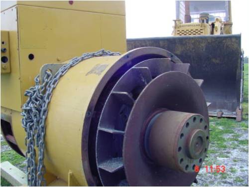

The "grid" over here consists of a new ( well actually second hand from USA) 1MW diesel alternator plus 2 backup 500,000watt gennies. Power distribution across the island is 11000 volts, and nearly everyone has their own 24kw transformers (100A 240v).
I got hold of the old genny they replaced here:
It weighs upwards of 2.5 tons. Had to use my trac (955l cat) to unload it, the Fergie tractor had no hope.

I then wind it onto a large diameter thing (like an 18" 2b pulley or two). This gets it manageable so I can use the bearings on the desk to finish it off straight onto the winding former.
The bearings also strip off flaky and not so flaky varnish, (sadly not all and I still get some cuts from the varnish left on.)
It does not seem to bother the enamel though... which is a good thing.
