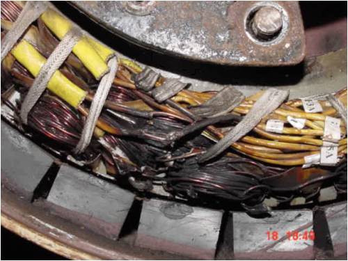

So down she came, and our worst fears were confirmed.... a burnt coil in the stator.

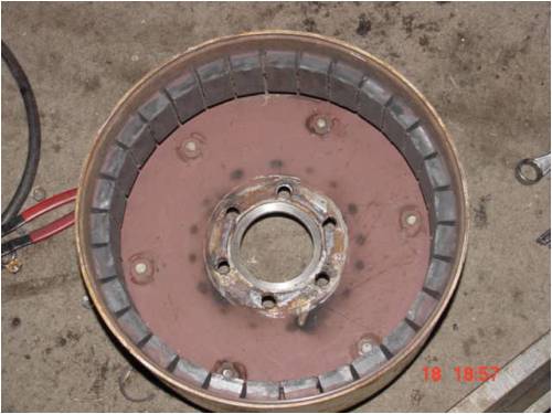

Here is a picture of the front of the genny (after some mods a year ago

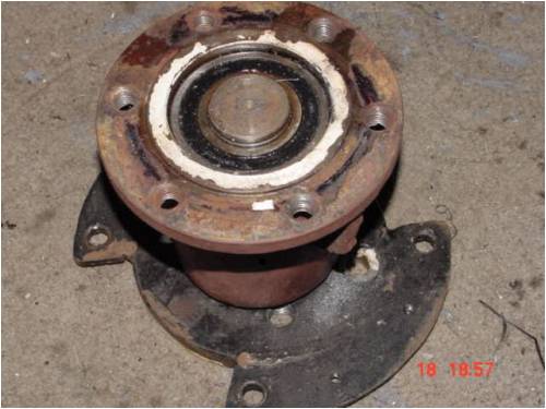

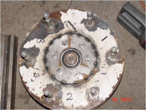

Here is the bearing carrier:
It has ceramic magnets, which are weak as water but still put out lots of power. There are thirty of them:

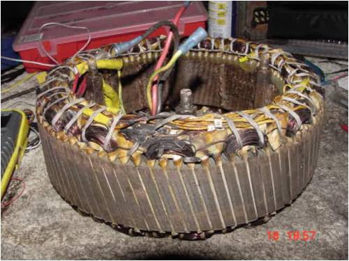

The stator has 90 coils three phase star. It is of cogless design with the laminates slanted to give the cog free stator:

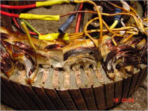

So I hacked the coils up with a chisel like so:
and then cleaned it up a bit:

It appears to be just poor manufacturing again. When they wound the stator, they dipped it to weatherproof it. Some parts are knee deep in lacquer, and some a bit sparse.
So in this marine environment, it looks like corrosion has gotten into some of the coils, which after a while start conducting between "green corroded bits" at these high voltages (unloaded over 500v). This then makes a happy little arcing machine that busies itself burning still more enamel off and away we go. charcoal maker.
It is not from overload. This machine can stand shorts on the outputs all day long. Great design, pitiful quality control.

This time around, will just rewind the bad bits.... and some bits I had to pull out from being over enthusiastic with the chisel .

The winding is a six stage one consisting of 15 coil groups x 6.... ie the inner "ring" has 15 coils as half a phase then the next is 15 coils of half of the next phase then 15 coils of half of the next phase blah blah blah. Thats a bit complicated.... lets see
ring 1 phase A 15 coils evenly spaced around 90 slots
ring 2 phase B 15 coils evenly spaced around 90 slots
ring 3 phase C 15 coils evenly spaced around 90 slots
ring 4 phase C 15 coils evenly spaced around 90 slots
ring 5 phase B 15 coils evenly spaced around 90 slots
ring 6 phase A 15 coils evenly spaced around 90 slots
(yes I learned to cut and paste). Thats 90 coils to wind of 55 turns each .8mm wire. Coil width is three slots.
So coil, miss three, coil, miss three, etc until 90 slots done then the next layer.
It was a dog to get the wire out off, as the slots are very deep and skinny.
