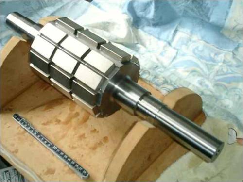

After the first small motor conversions (none are yet flying) I decided to tackle a larger project. About a year ago I finally acquired an old 10 hp motor to be converted to a permanent magnet (PM) generator. Work has been progressing slowly but steadily. Initially I intended to just make a new PM rotor for it but later decided to do a full conversion: a new rotor and a rewind.
This is so far the largest motorconversion I undertook. It will likely be the final one too. Larger conversions are frought with too many problems. A 5 or 7.5 hp motor is the nicest size, I think. 10 hp is just a tad too large (for me). And to think that Zubbly was considering doing a 25 hp conversion... (me shudders). This is also my first conversion where I use the 'JacquesM' method of decogging, as opposed to the usual helix-method. Hopefully the theory and calculations were correct, otherwise I'll end up with a 20 kg magnetic paperweight.
The progress so far: the coils in the stator have been removed (sept. 2007). A new rotor has been turned and milled (finished in march 2008).
At the moment I'm glueing the magnets on. 36 pieces of N42 2"x1"x.5". A scary job. Sometimes things look nice on paper (or the CAD screen), till you finally hold the workpiece in your hand in real life and see and feel how large and heavy it really is. The photos don't do justice to it.
Anyway, I'll try to describe the progress on it in this thread. Plenty more photos, along with short comments, can be found here:

This looks fantastic. I really like some of the new ideas, like the fences on the rotor to keep the magnets from drifting around as you locate them.

I particularly like the little ridges too. In fact, if it weren't for them, wrestling the magnets in place as they sliver around on a coating of epoxy would be practically impossible. The downside is it takes a fair amount of machining (milling).

http://www.anotherpower.com/gallery/album68/blue_monster_dra wing_3?full=1
Notice that the magnets are not at 30 deg (360 deg/12poles) but at 29.166 deg w.r.t. eachother. This method was described in the decogging tutorial (p. 14-19, 'offset method'):
http://www.otherpower.com/images/scimages/3538/decogging_tut orial_V1.pdf
It has been proven in the past to work. See this work by JacquesM (who seems to have copied it from Victor, who seems to have found it in commercial generators):
http://www.fieldlines.com/story/2005/1/8/2291/67790
Look especially close at the spacing of the magnets on the rotor, you'll notice that in one place (~5 o'clock in this photo) the distance is not equal to the other 11 places). Stator skewing shouldn't be needed here.

All magnets have been installed. Next step is to add some glass cloth around the magnets and cast the rotor in epoxy.
