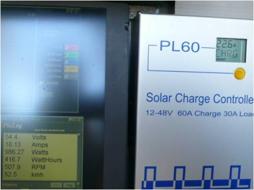

At last a good blow , the piclog lags the PL60 as it records data every 4 sec , 22.6 amps @ 54 V = 1220 kw

Excellent!
Phil,
Is the 507 rpm on the piclog correct??
52km/hr?? Is that wind speed??

Hi Trev & Glen ,
Thanks , it was a real buzz to watch it peaking out in the gusts , I would say the 500 RPM would be correct as in 43 Klm wind I constantly see 420 RPM , I did suffer some damage to the floating prop hub as it lost drive to the rotors as it has never had to cope with a 1.2Kw load before , so I striped the whole lot down on sat and did some mods , also cut of the seal lips and re-packed the bearings with graphite & oil , changed the tip angle to 4 deg ..
After all that it starts up in 10 to 11 Klm and keeps spinning down to 6 to 7 klm , BIG improvement for 3 blades driving 4 rotors , anyway I'll leave it there and see how it goes over the next week or so but 1.2 Kw is going to be hard to top , mabe need to add a few more rotors ...Phill..
