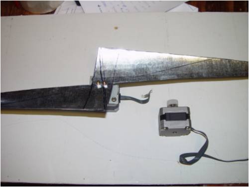

I'v ripped out 2 stepper motors from my old epson printer and have so far made the props and mounted them on the motor.

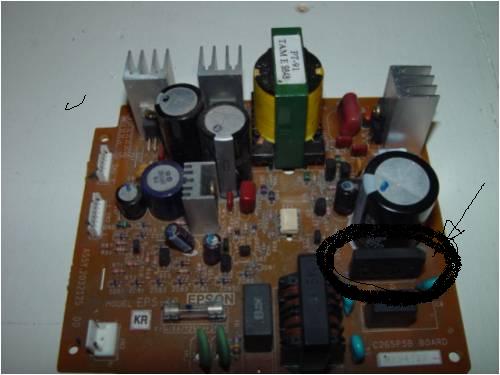

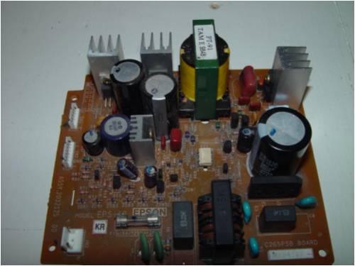

Posted: 03:10am 07 Jul 2008

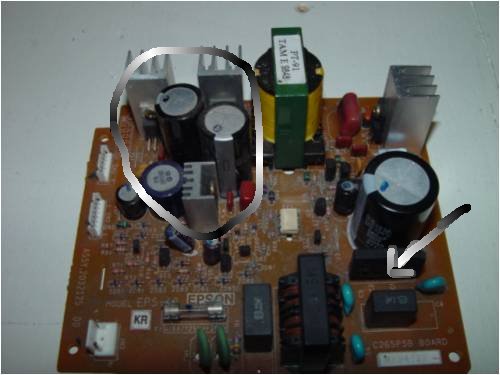

Heres some pics

Posted: 04:04am 07 Jul 2008
Theres a bridge rectifier with the arrow and there will be diodes that you may be able to use in the circle.
That big bridge is way overkill but you'v got it so use use it.
Oh is that a blowen fuse on that board? I hope the bridge isn't shot. Edited by Robb 2008-07-08

Posted: 04:07am 07 Jul 2008
The rectifier is that flat rectangular plastic block, with the circle around it and arrow pointing to it. Close to the large electrolytic capacitor. Verify that it has 4 legs, 2 marked with '~', one with '+' and one with '-'.
Now, if you can scrounge an old PC powersupply, in there (again close to the one or two large electrolytic capacitors) you'll find a rectifier too.
As far as Radio Shack goes: Gee... You're the first one I've heard say such things about that store with its large inventory of electronics parts and knowledgeable sales persons. By now you likely know more about electronics than the staff...
BTW, before you toss those PCBs in the garbage, at least remove the aluminium cooling fins and the associated 3-legged components, which likely are FETs, rectifiers and/or voltage regulators. Remove the fuse and the white thingy in the middle (with 6 legs, an optocoupler) too while you're at it. It may come in handy in the future if you decide to play around more with electronics.

Posted: 04:32am 07 Jul 2008
Sweet 1 rectifier down :)

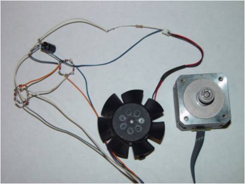

http://www.anotherpower.com/gallery/dinges/stepper_generator _resized
The 8 diodes are so small you won't be able to see them in this bad picture. But, it works, and should work for you too.

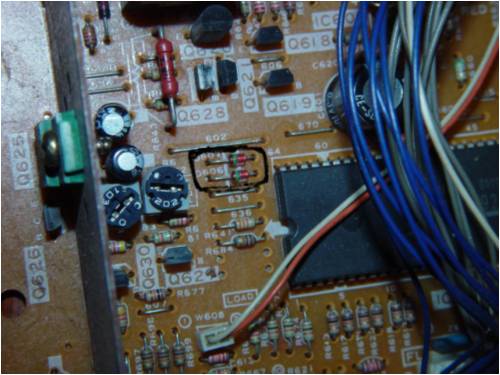

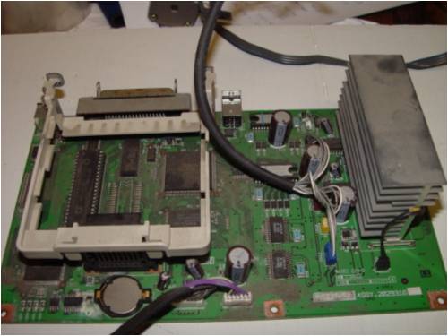

jeen
Joined: 06/07/2008
Location:
Posts: 11

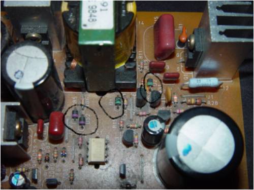

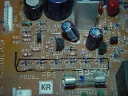

Posted: 07:05am 07 Jul 2008
I hope those are diodes but I seem to have a problem. Theres 3 purple striped and 3 teal striped ones. Can they be mixed and matched?
I take it those are the zener diodes?
this is from an old vcr that i just took apart. Unfortunately there dont seem to be any rectifiers but there are more then 8 of those diodes.
btw are the strip an indicator of where the arrows point?Edited by jeen 2008-07-08
Dinges
Joined: 04/01/2008
Location: Albania
Posts: 510
Posted: 04:55pm 07 Jul 2008
The 3 purple and teal (just learned a new word) diodes in your first picture should work fine, even when used mixed. Not much of an issue in your particular application.
The 6 zener diodes in your next picture shouldn't be used, just as other zener diodes in that same image. Zener diodes are used for voltage stabilization/regulation, not rectification.
The last picture from the VCR, with the two (or eight) green diodes should work fine too. BTW, if you look carefully at the white print under those diodes, you'll see the symbol of a diode: a triangle with a line at the tip. Notice how that line is at the same side as the black and/or green band around the diode.
I'm 100% convinced that there is a normal rectifier (4-legged one) in that VCR too, just as in the powersupply of the printer. Have a closer look at the circuit board where the 220/110 V power enters and where the fuse is. Near the fuse should be a large capacitor and in that vicinity there should be a rectifier too. Just to give a hint on where you should be looking.

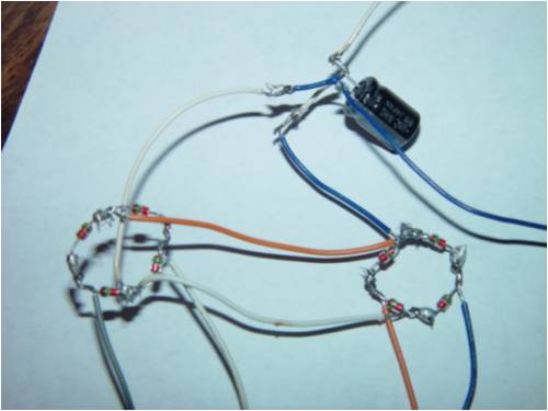

No luck on the rectifier from the vcr power board. There are 4 huge diodes wired next to the transformer though.
Might be more of a learning experience and fun for me to build the 2 rectifiers :)
