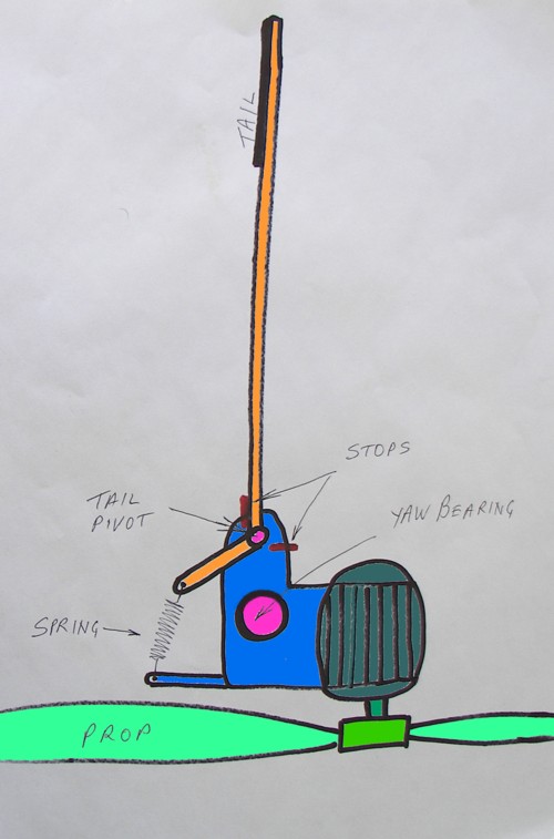

Here is a spring mechanism as opposed to our gravity mechanism. It uses a vertical pivot and no tail offset which are the source of most confusion. For basic understanding I did not allow the 20 degree extra in the low speed stop.
For a spring mechanism, 2 variables need be considered when designing; the resistance of the spring, and the preload. The resistance dictates the force needed to take it from one stop to the next(wind speed at start of furling to wind speed at fully furled). The preload gives the zero or the force at which furling starts(sets furling wind speed).
I'm sure this is easier to understand furling basics with.
