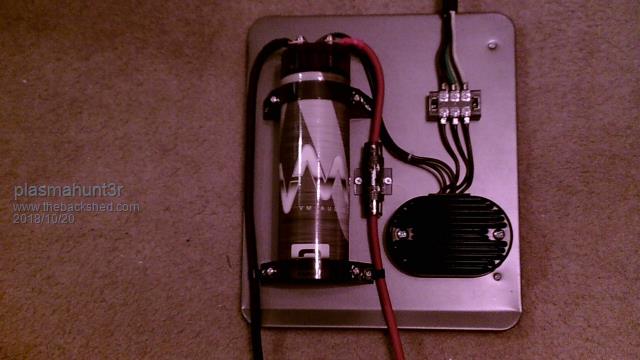

The black heat sink device is the Harley Softail Regulator. I feed in into a 2 Farad Capacitor which is parallel with the battery. The cap is there to help with surges, like when the refrigerator kicks in.
