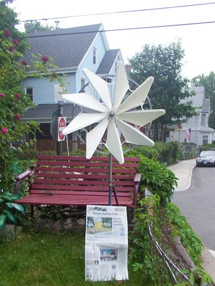

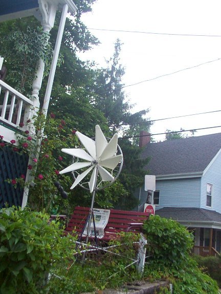

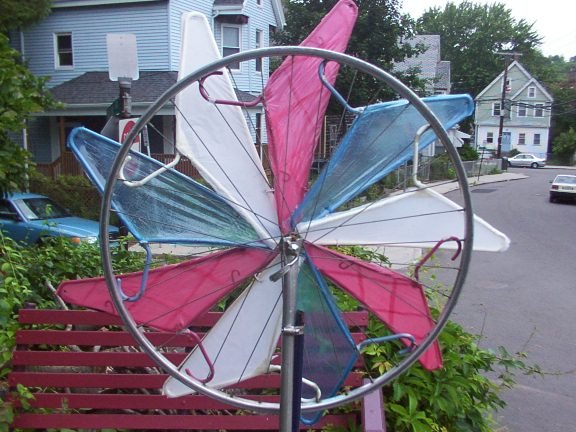

I love this thing. Philippe from Boston send me photos of his windmill he made with " a bicycle wheel, 9 plastic coat hangers, Styrofoam and tape. " He uses a clothes dryer belt around the rim to turn a small motor. Its very clever the way he used the coat hangers.

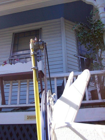

Philippe sent an update on his windmill, he's updated the design...
"This wheel rotates freely. At the location (hole) of the inner tube, I inserted one side of the axle of a rotating "bicycle wheel windmill". The wheels are perpendicular to each other. On the opposite side of the tire valve hole (windmill anchor point), I added a tail supported by a section of aluminum crutches. It is a "wheel on wheel" solution for smooth rotations in both horizontal and vertical planes. That horizontal bicycle wheel will likely be replaced by a scooter or motorcycle wheel, once I am ready to add the load of a generator."
