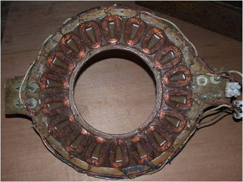

when i spin up the axial alt by hand you can feel a very slight resistance when its wired in delta...if you spin it up with one connection open and then touch it to make the full delta you can see a slight spark...i,m pretty sure these are the so called parasitic currents delta can allow
probabely only a few watts but enough to make me go back to star (what it was origionaly designed for )....
niall

If you were to wind it perfectly symmetrical, and could guarantee every coil was geometrically identical, then there would be no imbalance, and circulating currents would be all but non-existent.
With bottom of the garden axial design, this is unlikely... however, the F@P gang will have better results as the device is much more geometrically perfect.
With the axial, the very low R of the design, also means that any small voltage imbalance will use up significant power as W=ExE/R.... if R is very small, then this W will increase quickly. In an F@P, the R is high (comparatively) per coil..(include inductive reactance here), and so power lost to circulating current will be very much lower/damped. We lose much more to synchronous impedances in the alt.
The diodes hanging off the end of the alt for battery charging purposes, exacerbate the problem and introduce harmonics from the non-linear diodes, and crest factor /power factor that causes the "sine wave " to be very much distorted. This makes following sine wave rules very difficult... as they become more square as the power increases.... losses losses every where.

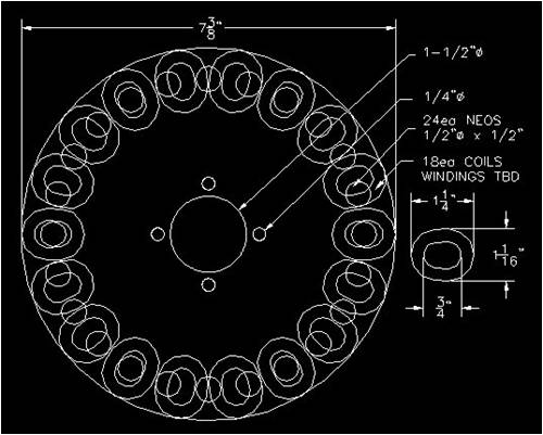

It is obvious that you have the theory well in hand, for classical alternators, but the practical asect of axials is just not there.
With the dual axial a lot of effort is used to shape the field, involving large quantities of heavy steel to provide return paths for the flux...in fact it can be empirically measured when coil testing, just how much difference air gap spacing can effect the field concentration. With a twin disk axial, there is no discernible change in EMF regardless of the distance one places the coil from the magnet face.
This indicates a field of relatively even intensity from one magnet to the other, of uniform strength, and matching the magnets shape. Testing with a single disk, shows the complete opposite, and that the induced EMF in the coils is very much dependent on the distance from the magnet face. This means in a thick coil, all sorts of things are happening.... but it is the coils shape in both instances that dictate the waveform. If we wind the coil to suit, it seems to come out very close to perfect.
I used round coils with round magnets. By changing the coil's hole diameter, I could induce the square shapes or peaky shapes or as perfect a sine as I could tell. If the hole size reasonably matches the magnet width, it seems to be a so close to perfect sine wave as to not matter. It IS the coil geometry that dictates the wave shape. The field shape is a given for the design, from there it is simple coil manipulation which changes the wave from square to peaked.
The comment was brought about by Nials observation. It is not mine. I can hook my axial up as star or delta on the test bench, and spin it by hand and it spins down very slowly in either combination, star or delta. It generates voltages in excess of 50v with a hand spin, and has a R of somewhere near .7R..(published here somewhere I have forgotten exactly now). and in delta is only about .23 or thereabouts. There is no discernible drag which in your numbers is "To put some figures on it. If the alternator is generating 30V, third harmonic is 20% and winding resistance is 0.5 ohm then the circulating current will be 30x0.2/0.5 = 12A. And that is just one phase." I think I would notice 50x.2/.23=43A...for just one phase....it would spin like a brick. This just does not happen in the real world of dual axials.
It IS the coil geometry that will dictate the wave shape. The field is very consistent and well shaped with virtually no leakage... so it is the coils shape and hole size that will determine the wave.... period. If you wish to argue this, then build one and find out yourself. It is not hard. I have done it and seen it as have many others.
If you use rectangular magnets and oval shaped coils,(as Hugh Piggott does) then it gets messy, and it is much harder to get a true sine wave, and you can wind for square if your keen. Hugh is a strict Star person (father of the modern axial flux), so does not bother with waveform..... (he also burns up stators in his larger machines like the Nirvana, so Delta loses are not at fault..... but high R star is.) I suspect Nialls is of the Hugh design with rectangle magnets and oval coils.
The hand placed coils in the axial are prone to be improperly centred and aligned as well. It is not an exact business. As a consequence. non-symmetry is almost a given unless your very careful. If non-symmetrical, then the phase angles are incorrect, and roughly 120 degrees is about what we get... you can guess the rest..... for an axial it is symmetry and geometry that dictates the wave shape and phase angle. We are stuck with the field shape and have to work within it's constraints. Another problem with rectangular magnets, is that most have to wind the coils ovoid, or triangular(ish) to fit the inside of the coils into the diameter as it diminishes towards the center, and this means the geometry of the coils does not match the geometry of the field... here you should get wave distortion.... but it does get surprisingly close to sine.. ( not as good as the circular ones though)

the alt is one of hughs square mags oval coils...
in my case its definately bottom of the garden mechanics
winding coils is weirdly hypnotic and its easy to get an extra turn or two in there (i.e. the dog barks.. you get an itchy nose etc.)
plus the first ones usually come out a little bit bigger (you get better as you go along) ..its hard to align coils .. i tried printing out cad templets for as much as i could but soldering heavy wires ,enthusiasm etc can move things around a little ...
as regards hughs design,s theres a danger of not factoring in the human element (like above) as well as the machine......people are tempted to let machines run in occasional storms just to watch the ammeter hit the top..i cant understand that ..a lot of burn outs seem to happen in freak weather
on his last course here watching the way hugh approachs building a machine ,setting up furling , air gap ,possible weaknesess down the road , good pratice etc was an eye opener in itself , never mind the machine ...all this with 16 pairs of hands playing with power tools with gay abandon...
i can only speak for my own take on hughs design ..i provided the personal touchs .....delta accepted
at first i thought i had only nipped the bearings with an extra flat (maybe a bit less) on the castle nut (the resistance like i said was that slight ) only for i noticed the slight spark i,d probabely have ignored it
it had been running in delta a couple of months previously and seemed fine (in hindsight with a slightly different growl) but now i just dont like the idea of a little extra drag (however small) in a machine that has early cut in as one of its main characteristics ..so star it is

Can Nial1 explain why his alternator has 12 coils and 16 magnets..?
with hughs designs i just copy , thats a given.....it works for me....i have no aptitude or feel the need to analize all his different approaches ..its above my head ...do i need to alter something ?... a tweak here and there perhaps ?..........
erm......on the other hand your loaded question seems to pose a doubt about understanding basic 3 phase principles .... as regards learning something about this i do understand its helpfull to know something (all be it a bit thin.... ..) of the physical relationship of the coils to the mags
..trawling through otherpower for months about 3 phase for me was a start and still is
....an earlier learning curb included a 24 to 18 coil 3 phase (if memory serves)..2 simple single phase alts and one serpentine 3 phase )........basic stuff and yes they were pretty crude..... but then you try to move on a bit and hopefully improve ...the precise wave forms (precise measurement etc..).. arnt so important to me but still of great interest
my point is this
one of the first axial single phase alts was trully awfull ..... it had 14 mags per rotor , 7 coils that had far to many turns...its own mother couldnt love it...no research.....just unbridled enthusiasm
yet when 3 sets of 2 were individually rectified into a 24v batt it could put out bursts of of 300w , yes it was a bruser but i like to think it could have fought its corner against some of the commercial 2 meter 3 phase machines ..
i bought one of these ,it was just a source of embarassment... so i took it down
the 24 mag stator ..3 phase 6 coils per phase (its been a while since i looked at it )..doubtless the wave forms were interesting i have no idea...... but you got a lot of copper in there for your buck.. ..
the magnets were small though 48 in total and slightly the wrong size...all i could afford at the time ..a learning curb nonetheless
the theory is interesting ...but charging a battery was the ultimate goal ...the end justified the means if you like... apologys to all (especially peter) for the rant ...
ps ..a better pic from fieldlines
i,m not the sharpest tool in the box....but i can sortof understand a picture.....as regards your question this post is basic but the only answer i have ........ Edited by niall1 2009-08-21

Hi Bob,
AAHH how right you are when you say 99% of the population have no electrical background. I am one of those 99%, and i feel like a mouse running around and around one of those wheels in a mouse house !, when topics about electricity flow com up.
BUT i am not here to try and re-invent the wheel i am merely trying to bend it a bit to suit my needs.
I only use fisher & Paykel smart drive motors for one simple reason someone has been there before me and has a mountain of data. Have a look at eco-innovations website https://www.ecoinnovation.co.nz/
I have results for every combintion these motors can be rewired in for 12, 24 & 48 volts, and these results are purely from rewiring not adding any extra bits like capacitor.
