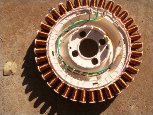

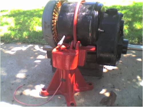

kiwijohn here is a picture of my stator wired to a 2 poles in series.I have also upload a picture of the turbine.I am not sure which way to wire this stator.Any help would be great

nice to see your project. I'm interested in the gearbox and the way it,s constructed. Is it bronze helical cut gears ? Where did you get this from ,,if thats not an invasive question ,,like ,,out of a bus,car,some sort of machinery.????.
I've got Glenn's and Trevor's F/G 14-15 foot blades ,,,,so will be watching your progress with the 13 footers with interest...

The whole thing is cast iron.It has steel helical cut gears.It was a turbine off a local farm dont know who made it got no markings on it.My dad machined down the body so we could use a standard shaft and bearing housing inside the main body and the smart drive justs bolts on the back

The wiring seems to be OK from what I can make out of it. As you say, 2 x poles in series, 3 phase- Star configuration, times 6 in parallel.
What is the connection when the bulb is not? Perhaps you have a short circuit there, and that is a back EMF brake???

Thats a 4 blade Dunlite,
ive got a manual burried about the place if anyones interested.
also have the machine sitting in my toilet but have never got the courage up to try it.13 ft galvanised iron blades just look too scarry at high speeds for me, my hub has had 2 spokes welded up long before i got, it way back in 1990 ish. from memory it was meant to be about 400 watts 32 volt. I have seen the remains of 3 of these that didnt furl properly, very ugly and a long way from the tower.
from memory the castor of the tail was used to set the charge rate.The instuction make interesting reading so i will try to find them scan and post if thats not to uncool for copyright issues.

I would be interested in having a look at manual.I have the old galvanised blades they do look a bit scarry.have replaced them with a set of fibreglass blades.As for the tail have made my own design.

Do a sketch will be easiest to understand. It doesn't matter if you're unsure of an area of the wiring layout, but do show and identify every terminal please.
You are aware that a spinning wind generator not connected to a battery will likely have a voltage much higher than 12v, right? With a gearbox it's difficult to know what the Rotor RPM is when the blade is "bearly spinning". Things may be fine and you may be really fortunate to have a low speed turbine. If that gearbox ran from galvanised iron blades, maybe the step up gearing is large. Too many unknowns at this stage to speculate further. A data snapshot of the blade rpm, rotor rpm or gear ratio, battery voltage & current would help.
