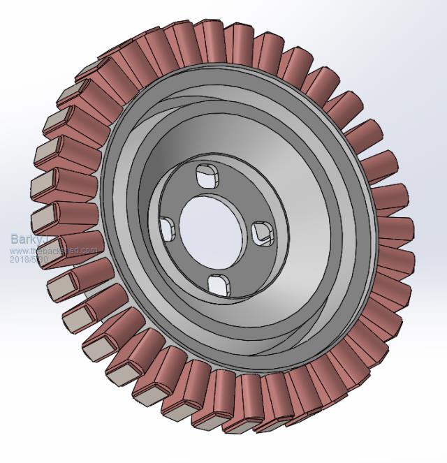

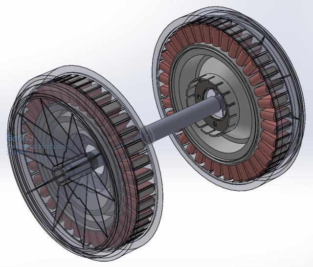

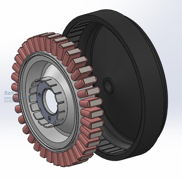

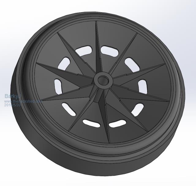

I have modelled the black cap rotor and 36 pole stator in solidworks, then the metal centres which go into the stator, then designed some bearing holder spacers for the centres of the stators, then put them onto a simple chassis.
Then figured out the drive shaft using the original older style male ended shaft. Popped out the build in plastic bolts in the black rotor caps, and figured out how far the shafts can insert into the caps, how much sticks out the back, and adjusted the centre chassis to suit the lengths etc.
Things are going well.
Here are a few pictures. These are at various stages of the last week, so some are newer than others, and I was using the newer female ended shaft at the stage of one of these images. Just what I took screenshots of.

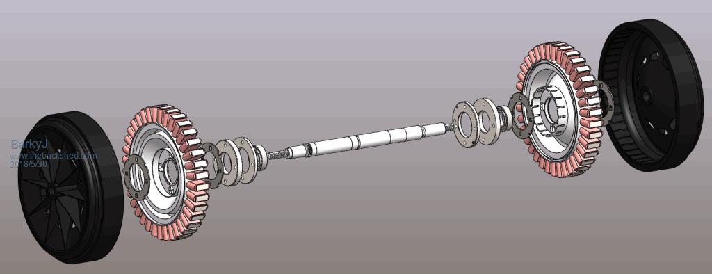

Here is a bit of an exploded view of the drivetrain and spacers, nothing magical here, but quite neat to see.
BarkyJ
Joined: 26/04/2018
Posts: 114
Posted: 09:19am 30 May 2018
So referring to the exploded view above, after the metal rings which locate into each side of each stator, I designed up 2 mild steel rings. One out of 6mm plate, which would have a standard 6005 bearing pressed into it, so 6mm was in the plate, 6mm sticks out. The portion which sticks out, then goes into the stator in the stock location, and the spacers 4 bolts then line up with the stators 4 bolts.
Next is another plate, 100 thick (in the wrong order on the left side of the exploded view, oops), which has a smaller diameter hole so the bearing cannot move, but the centre is free, so this acts as the end stop for the bearing. Sandwiched between the stator bearing lip, and this metal plate. So both 6mm and 10mm plates when stacked together, just come past the 'fingers' on the back of the stator, which use to locate the stator in the washing machines outer drum. So now we have clearance of these fingers, it can be bolted to the central chassis.
Same deal on the other side.
The shaft worked out great. With the centre plastic bolts removed from the black caps, the male ended shaft with the shorter male threaded end (opposite end to where the threaded nut goes on the shaft), can be pushed all the way into the black rotor, so the end shoulder of the male shaft comes up against the end stop of the rotor. This then gives the race where the bearing sits a perfect location, as if the shaft is not pushed all the way in, only part of the shaft is the right diameter for the inner of the bearing.
The left side of the shaft in the above explosion, with the nut, works as usual, and the rotor pushes on all the way up to the nut.
A standard lock nut can be put on each end, however the left end is where I am having my prop, so some weird stuff is planned here.

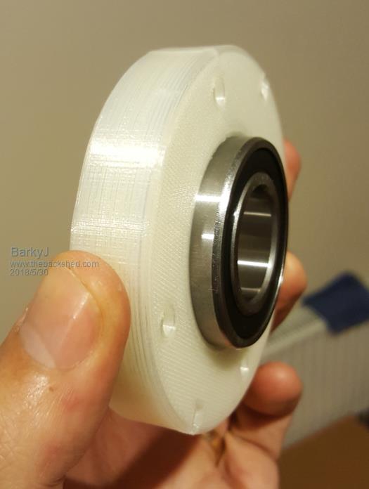

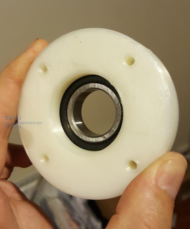

So I have those spacer rings being water cut, to pick up tomorrow. I actually 3D printed them as a single unit with a shoulder, and the bearings press in perfectly with a tight fit, so I might still use plastic rather than the metal ones, I am not sure yet. I printed them 100% infill, so they are solid as, each one took about 5 hours to print.
Ill put up some images of those next.
BarkyJ
Joined: 26/04/2018
Posts: 114
Posted: 09:45am 30 May 2018

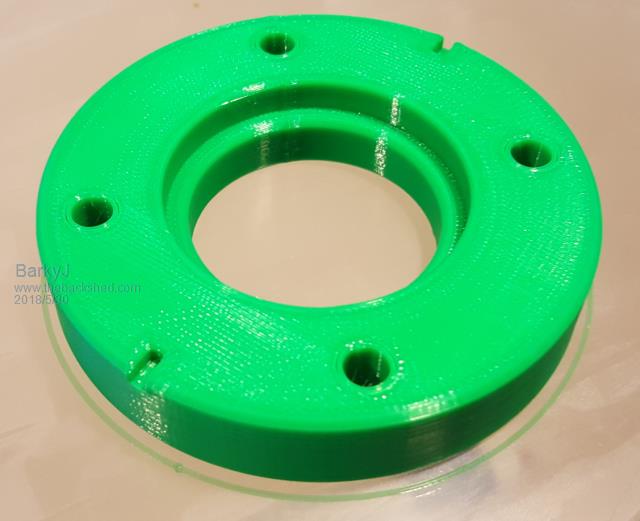

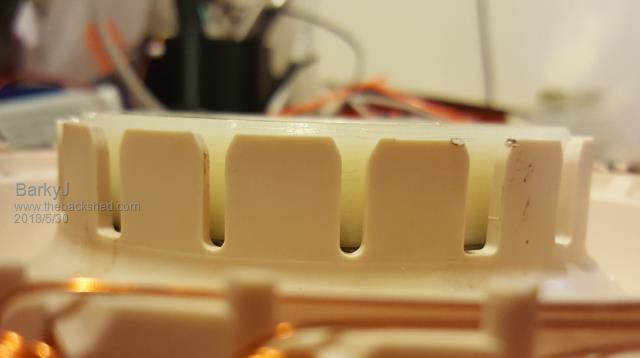

Ill figure out tomorrow when I get the steel pieces, if I go 1 piece plastic or 2 piece steel. But at least I have both options to work with.
Here is a pic without the bearing installed, did the 2nd one in green.

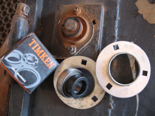

there are some other bearing options that could make things easier and more robust. Not saying you should use them just making you aware of whats out there.
In agriculture we use a thing called a self centering bearing, pressed sheetmetal flanges and a locking ring (tightened against the direction of rotation) they are as tough as old boots because everything is locked solid, no slop at all.
Posted: 01:37am 31 May 2018
The 6005 bearing is plenty strong enough, as I suspect it only has to support the two F&P rotors. Some of "the weird stuff" to come, probably involves a very cunning and super strong quite independent main turbine support bearing, and a coupling of some kind.

Thanks Yahoo2 - I started off looking to use the 56205 bearing and F205 carrier that Gizmo used in his public plans, but they just weren't going to work in the configuration I am planning on.
Any idea of the part number of the bearing you have there?
Always happy to consider other options, thanks for this idea.

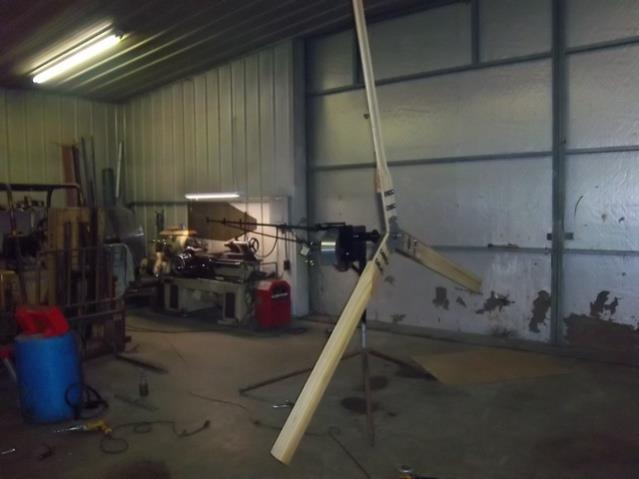

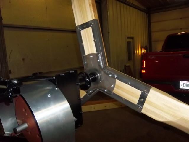

Here is some examples of a laminated timber GEO-222, the lamination is done to get extra strength using the grain of the timber in the correct direction.
https://www.royalwindandsolar.com/wind
this is using these blades on a geared head. One of Chris Olson's massive builds. if you get stuck or have problems with the pipe, building with timber is always a good option.

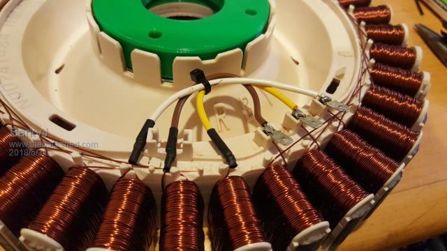

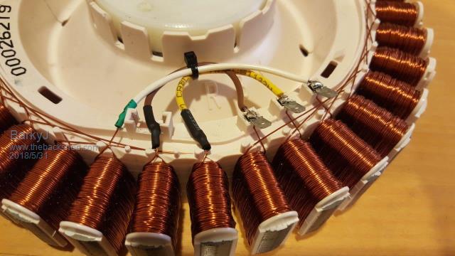

Just wired both stators up for 1X12C Delta, hopefully correctly. Same length wires used on all 3 phases, with the jump over in phase.
Measuring resistance between the 3 combinations of connections between phases, and the first stator is 10.36, 10.36 and 10.37 ohms. The second stator is 10.42, 10.43 and 10.44 ohms.

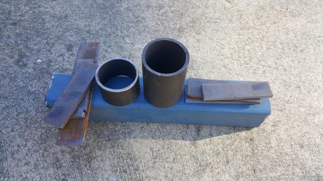

Getting everything ready for my day off tomorrow, to get this main chassis proof of concept built. Heading to my Dads place, where he has a small lathe, and old Arc Welder and my Mig welder, however I have a feeling my Mig isnt working at the moment, so likely this will have to be Arc welded up and then cleaned up afterwards.
Went to a scrap yard this afternoon and got a bunch of pipe, box, plate offcuts, so we should be all sorted with bits and pieces to try things out.
Got some parts back from the Waterjet today, Dad collected those while I was at work, so ill see how those turned out tomorrow also. The rings for the bearing as mentioned, along with the end caps for the main chassis which the stator assemblies bolt into, along with the first stage output disc which goes on the outside of one of the rotors, which will have the blade disc bolted to. If this idea works that is.
No i would have to look it up.
i use fafnir bearings so it would probably be a 205 RA-RR or RR series but I dont recall the exact number.

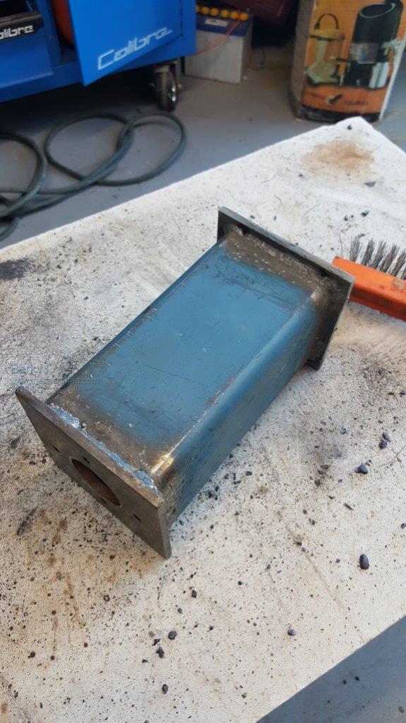

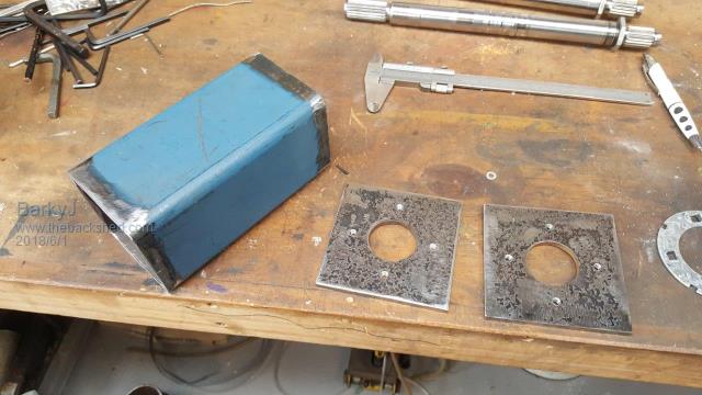

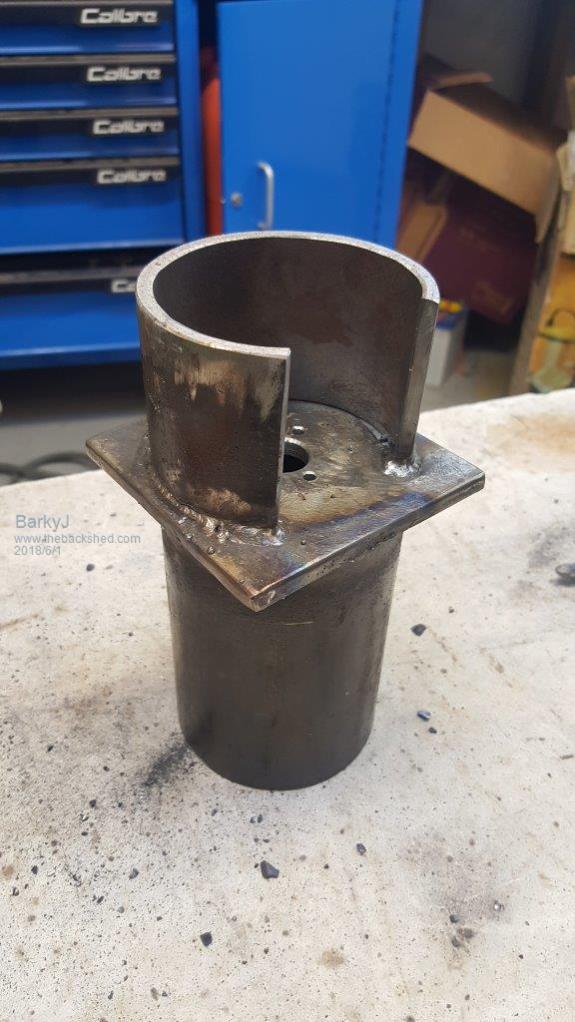

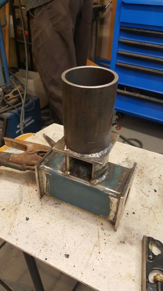

Here are some progress shots from today:
Really happy, its coming together nicely.
If you are wondering what the gap in the round tubes is for, this is to access the slip rings (to install it etc), and also where the wires from the stators etc will go to, to then go down the pole via the slip rings. I got a 12 channel 5A per channel stainless slip ring coming, which should be more than enough to cope with the 1x12C Delta currents, which in theory should peak at around 2.8A per stator. Each stator will have its own 3 phases going through the slip rings, so 6 channels, and they will combine down on the ground after the rectifiers.
I then have 6 channels for other things, such as RPM sensor, etc.
More to come over the weekend.

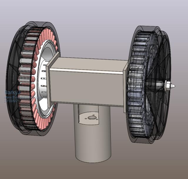

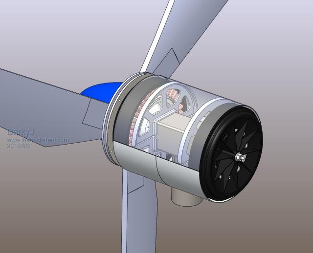

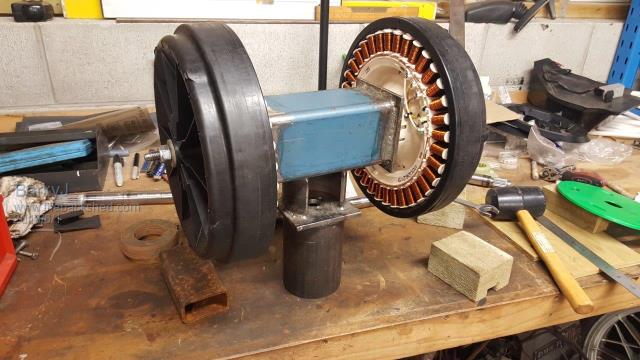

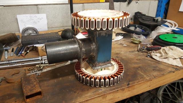

I am pretty stoked with progress though, as the actual thing came out just like my design, which I actually forgot to post here before the other images.
Here it the guts of the design:

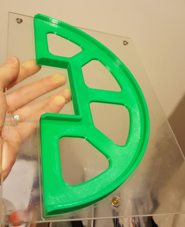

Here it is a few stages along. I have already started printing the cover supports. Last one is in the printer as we speak. I will either cover it all (with clearance to the rotors) with 0.5mm Aluminium sheet, or I might use that 0.8mm thick clear polycarbonate UV safe sheet you can buy in a roll from Bunnings. Not sure yet. But something along those lines, to keep most of the weather out of the guts.
The blades pictured are extremely first pass CAD concepts only, I haven't done much research on these yet. At the moment they are just placeholders
Here is one of the cover supports still on the printer glass bed. Fits snug over the square box section, and will be fastened in place, and then the covers wrapped over the top in some fashion. All still to be determined yet.

I'm a bit old , so I have to ask .
That green frame thingo ?. you say it's on the printer glass bed or something ,,what do you mean by that and how is it actually made -there, told ya I was a bit dumb?!!.
luv your drawing on that computer , wish I had listened to my teacher at school way back then, might be a rocket scientist by now,Eh?.
