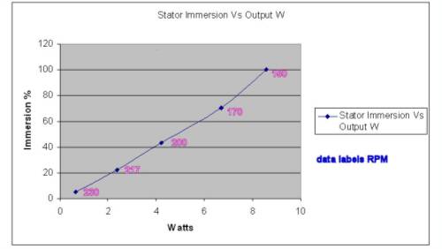

ok, so I've started doing some tests and there are some results graphed below. Hopefully those amongst you who may see some merrit in this system and have a whole bunch more experience with actual windmills than I do, might make suggestions, pose ideas etc to see if this is all worth pursuing.
The test below was done using one phase of an 80SP setup. Rectified, and connected to a 12V/75W halogen bulb at around 2 ohm, although this is not important as i measured both voltage and current at RMS to calculate Watts Continuous RMS.
The output watts are very low and as a result of using one phase and the load I used, but the aim was to look at how things changed, not produce lots of watts. This is not to say the results mightn't be very different if i was pushing many watts. But it's easier to deal with low watts, so thats what I'm starting with.
The motor driving the hub was set at 150RPM with 100% coverage and then left alone for the whole test. This is not to say I'm confident it was producing constant torque, because i don't at present have a constant torque drive, but I'm hoping it's pretty constant so as to not make much difference.
As you can see, the relationship between immersion and output power is close enough to linear and the speed increases from 150RPM at 100% coverage to 230RPM at 5% coverage

well this came out pretty blurry, so for those interested, the values of RPM are from Left. 230, 217,200,170 and 150

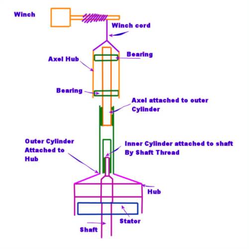

Those two issues I also isolated as being possibly problematic. A picture might help explain the workings but a diagram might be better to show the hidden bits. I'll see what i can do about it.
The mechanism is pretty simple and as cheap as it gets.
My first thought was to use a servo for exact control but I decided a simple DC winch would do the job, probably just as well for the control needed, and at a fraction of the price.
The winch is the little 12V window winder motor you can get from Oatly for $12. It has a 10mm shaft attached and uses a nylon cord as the cable. A stainless light cable would be better but it's just a prototype
It draws 24W to lift the hub and 6W to lower it. This it can do fully in about 1/2 second. So on average you would be looking at 15W for 1 sec per gust. If your gust is not exceeding that well and truly then it's not a gust worth catching. As for control, pulsing the winch allows about 5% increments in immersion, each way. This is probably about as much as would be needed
The rest of the gear uses so much less power than the motor, it's not worth worrying about.
As for the splines. Well with full spline contact(ie the entire length of hub splines in contact with shaft splines) there shouldn't be any more wear on the hub splines moving the hub up and down as it would in normal 100% coverage position. Both the Hub and shaft are moving at the same speed.
But when say only 5% of the hub splines are in contact with the shaft splines, well the forces are much greater. I talked to a fitter and turner about it and the simple solution is to cut a piece of the spline section from a second shaft and turn both so that the new piece fits on the original shaft. You then have an extension to the original shaft spline length. After that there is always full contact of hub splines with shaft splines. And there should be no extra wear than normal.
I have been monitoring the hub splines since I started and there hasn't been any noticable wear even without the spline extension. So it may be more hardy than we fear.
My other thought regarding hub spline wear is to drill out the hub centre and insert a moulded spline section made from polyurathane. You could have a box of very cheap spline replacements handy to refit whenever needed.

The only bit that probably needs explaining is that the inner cylinder is a snug fit with the outer cylinder. It's purpose is to keep the Hub centered as it's raised. Without the white screw down knob on the top of the hub(which I removed) the hub has a slight looseness which increases as less spline length is on the shaft, when the hub is raised. since the inner and outer cylinders spin together, there is no need for extra bearings here.
The inner cylinder could be dispensed with if the shaft splines are extended.
Note also that I have a vertical mounting with the hub above on my test unit. For a horrizontal design a light spring will be needed once the hub is raised past the strong magnetic pull of hub back over stator

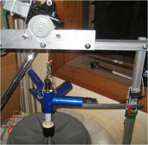

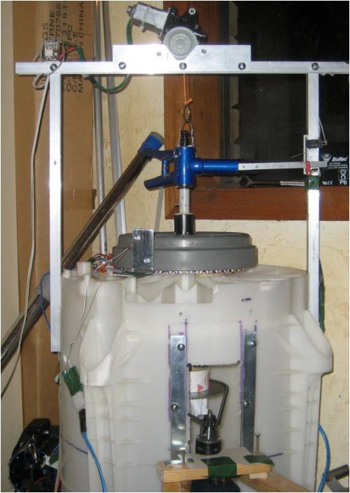

ok, here are a few pics of the set-up. Keep in mind I was trying to keep it as cheap as possible and still functional. So it's not my proudest engineering feat. And appologies for the messyness. My wife got sick of it being on the dining table So it's in the spare room sharing space with the vaccum cleaner.
The second gives a good view of the top and bottom limit micro switches and the red thing is an end on the linear pot slide which provides the position

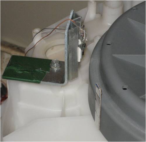

The 3rd pic is a close up of the IR optics for RPM measurement. The silver pickup reflector can also be seen on the hub
