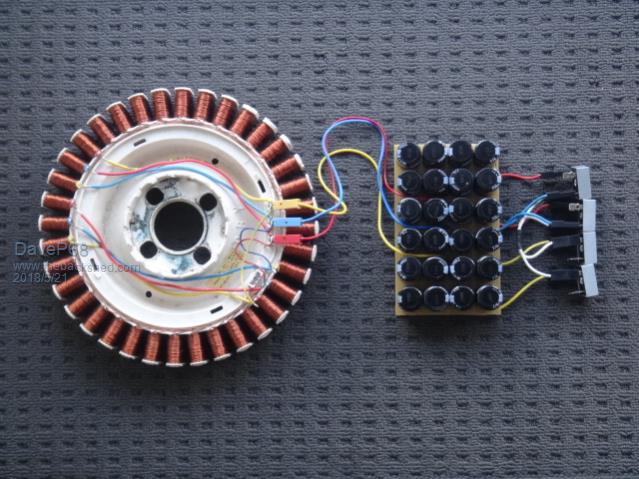

Hi guys, I've read through the rewiring page and it appears that all of the wiring diagrams for the 36 pole stators are for star.
Has anyone done any diagrams for the various 36 pole stators in delta?
Am i correct in thinking that eg 2x6c i need to run another 3 wires and connect the 3 poles represented at the dot at the bottom to the 3 poles represented at the dot at the top, then combine these 3 wires with x,y,z?

Here is a photo of a 2x6c wired in delta connected to a capacitor doubler.
Hope this is of help as I don't have any drawings to post.

Thanks David,
that makes it a bit clearer.
