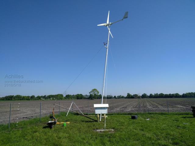

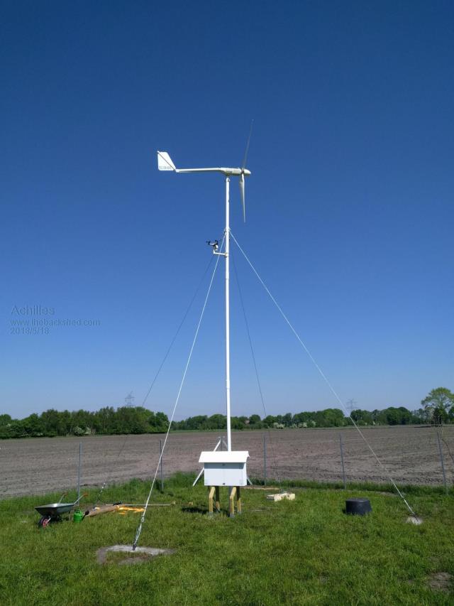

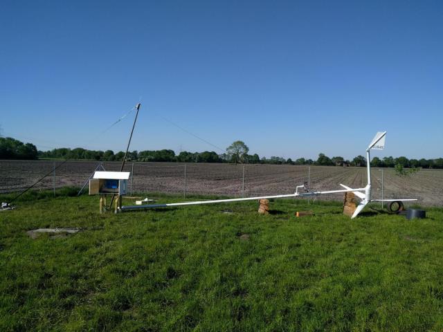

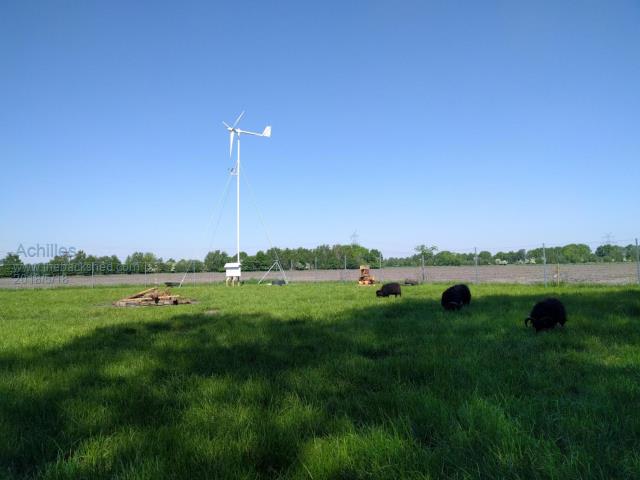

Anyway, the whole system looks like this:

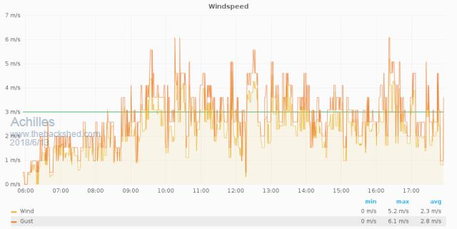

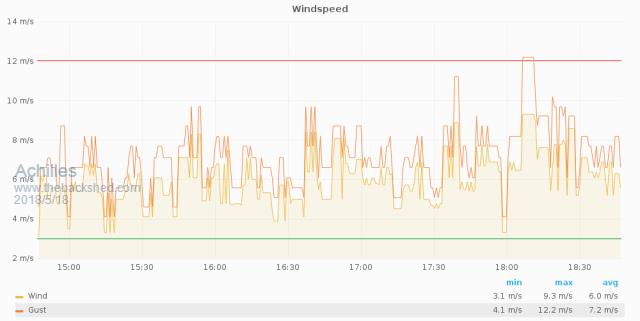

2 days ago I had some nice wind:
The problem I am faced with now is that I don't get up to speed.
Even at 7m/s wind (15.6 mph) it is only rotating at about 60-80 rpms.
At that speed I get 30 volts peak and 67W for just a few seconds.

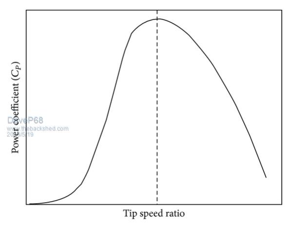

The blades you have look like they have a tip speed ratio of around 7 to 7.5 at a guess. This means as they start turning want to operate at over 100 RPM in light winds 2.5 - 3 m/s.
Here is a TSR graph to illustrait my point
Posted: 08:47pm 18 May 2018

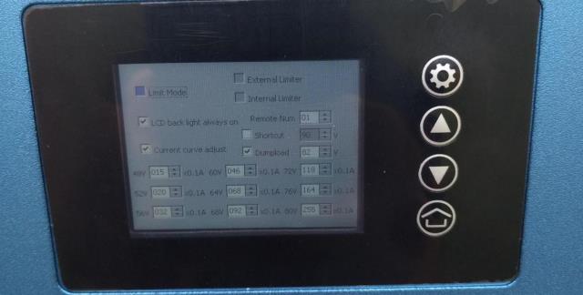

I am also waiting to hear from the inverter manufacturer whether the current curve can be adjusted in order no not stall it at 20-22 volts.
In terms of breaks and dump loads: While planning I thought about a 48V heating element in a bucket full of water. Missouri Wind and Solar sell them quite cheap, but I have to pay shipping and customs so I haven't ordered them yet.
I do not trust those flimsy chinese "1500W" dump loads. They may survive a few high speed gusts, but certainly not a fully fledged storm.
The inverter has some kind of break built it.
I noticed, that when I let the turbine spin up to above 60v and the connect the inverter, it slows down the turbine to a halt gracefully, not like shorting the generator. This also happens when I disconnect the tie from the grid.
The shorting feature can be enabled at a certain voltage though.

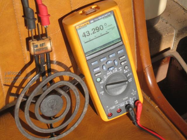

Since this is a DIY forum we would prefer to see dump loads built out of scrap.
old heaters, stove and oven elements, floodlights or even heavy gauge soft tie wire strung between insulators. You can run a fan to dissipate heat. The dump load you buy is only nichrome wire on an insulator cut to a specific length to get a certain resistance. Almost every heater element is made from nichrome wire.
You just need enough of them in parallel to handle 3200+ watts and finish up with the right resistance.
roughly 60 volts and 53 amps that's going to be 1.1-1.2 ohms
38 of these, OK maybe not, that only 90 watts each at 60 volts.
electrical laws
but you get the general idea, 3.2 kw is a lot of wind turbine to handle in a storm.
(90v x 90v) / 43 ohm is 190 watts.
16 units if it is switching on at 90 volts and 35 ampsEdited by yahoo2 2018-05-21

  Quote  So they can now be programmed?
They can, check the picture.
But not the start current which was the issue with the low voltage version of this inverter.
Once the 45-90V model starts up it actually works all the way down to 40V which is very nice in low wind speeds.

The 2nd inverter arrived today and after installing it I observed that the blades did not speed up as much as it was the case with a single inverter. (I modified the voltage points to split the current evenly between the 2, modification is only possible from 48V upwards though.)
I will wait and observe before I modify the hardware though.
Today wasn't particulary windy.
