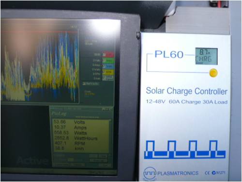

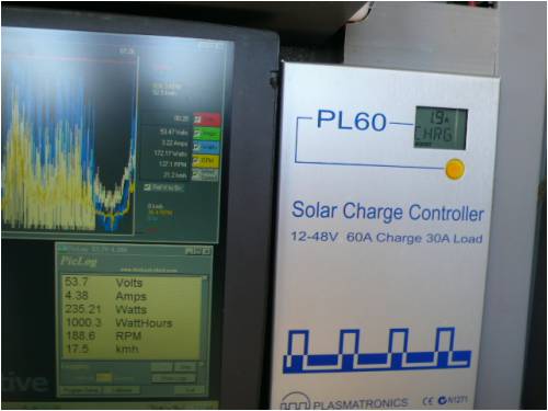

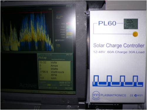

Woke up this morning to a glorious sound , WIND , went out to check the logger as I left it on over night as the forcast was for strong wind , they were right for a change , from 12am to 7am - 1000watt hrs , I was running in star so switched the relays to delta which you can see the change in graph
Delta all day , max peak 611w @ 420 rpm , I lowered the tower 3 times late in the afternoon to do adjustments to the tail angle and centre line of the blades to square it to the wind in 20 to 30 klm
All over 8 pm , the dual stator equaled the solar today . If only that it was every day
Am going to trial 60 series tomorrow , am running 80s unmodified at present , hopfully will get some more blow to see how they go....Phill...
