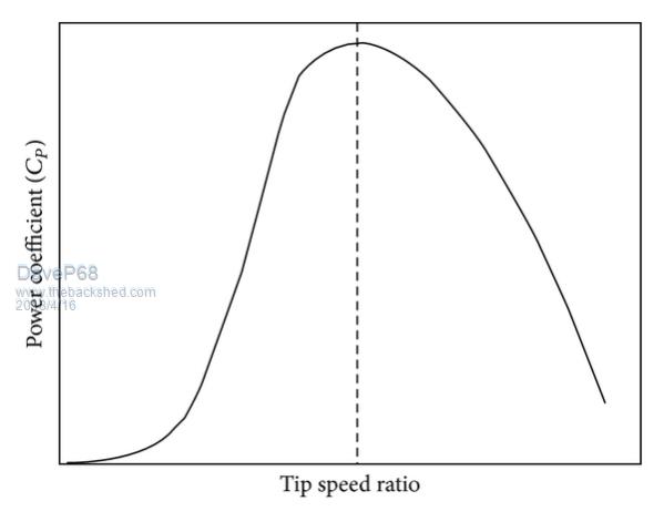

The torque produced by blades increases at a rate of 4x as the wind speed doubles. This will remain relatively constant if the blades are kept in their optimum TSR power coefficient (Cp). Tip Speed Ratio is directly related to Torque, please refer to the graph below.
If a PMA isn't correctly matched to blades with respect to the torque required to drive it, then energy will be lost. The current produced increases on a PMA at a rate of 6-8x as the RPM doubles if the voltage is clamped (by battery voltage). Torque is proportional to current drawn from a PMA. If torque is proportional to current the blades end up operating outside their optimum TSR with a 6-8x torque increase for a doubling of RPM.

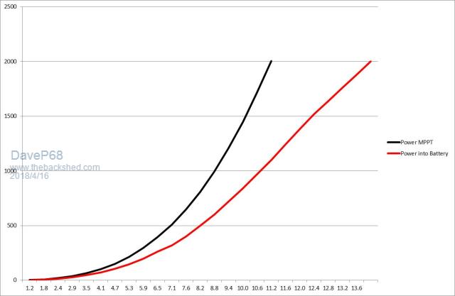

Here is a graph of difference in performance between MPPT and Battery Charging.
The bottom scale m/s of wind vs power in watts.
As you can clearly see the MPPT black line on the graph produces FAR more power at lower wind speeds resulting in more accumulated power produced. Edited by DaveP68 2018-04-17

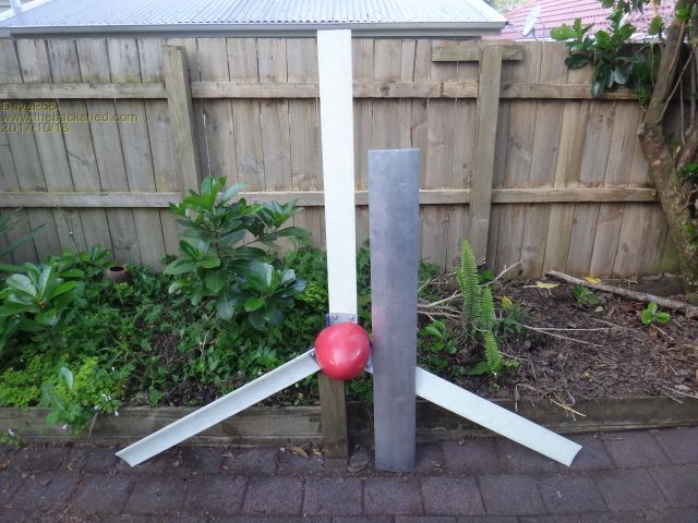

  DaveP68 said   Finally I'm getting ready to build my first wind turbine.
It will be a 2 stage process as I've got 2 different sets of blades to use. First version is going to be 3 blades with a diameter of 2.15 m as test unit only. The plan is to only have a single F&P stator and work out cut in + TSR values etc. It will also be used to check the operation of my new electronic dynamic brake circuit.
Here is a photo of the 2 different types of blades.
The second version (production unit) will be a F&P dual with 3 blades at a 3 m diameter using the Oz Wind Engineering GOE 222 blades. These are the same blades as Fred (flc1) used on his latest triple F&P stator build. Having been involved with helping him out with the configuration of his stators, it will take some of the guess work out on my own set up.
