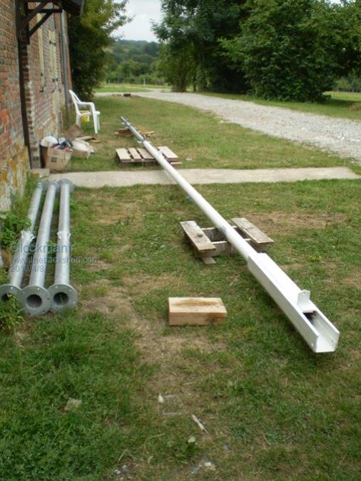

Posted: 07:20am 30 Mar 2018

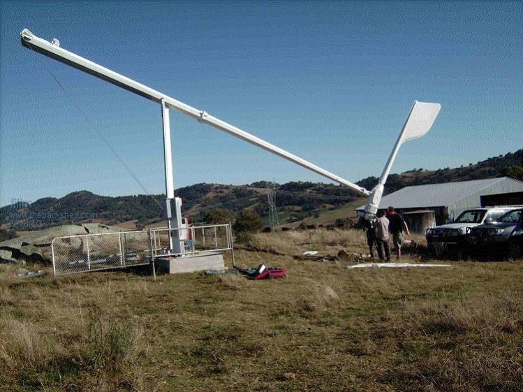

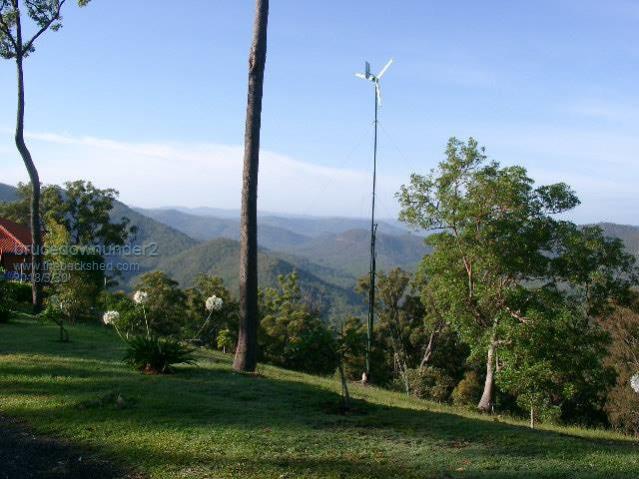

picture of tower
hope this works
OK, so the pic works, now , that is a pic of the old LIGHT F&P wind gennie,so the tower is able to be erected ok with that light load .
Now I have a heavy 'er windgennie and it's heavier, so this is where the problem is .
Not the lifting , but the bending of the steel..
I'll grab some pic's of the pulley block set-up later.
BruceEdited by brucedownunder2 2018-03-31

brucedownunder2
Joined: 14/09/2005
Posts: 1548
Posted: 06:46am 31 Mar 2018

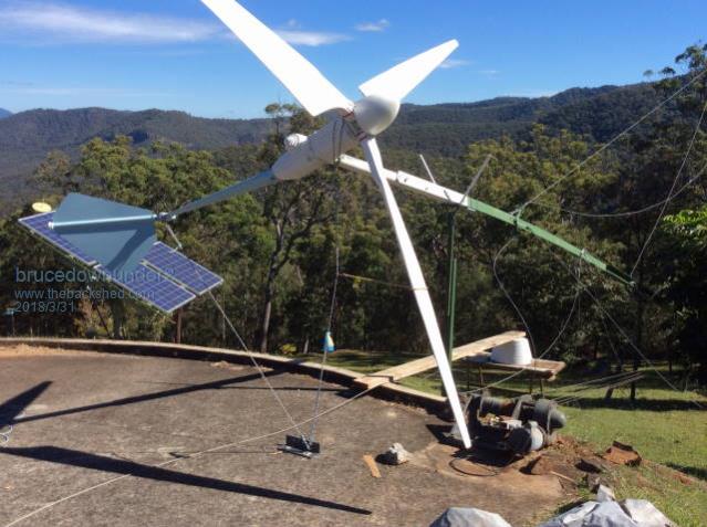

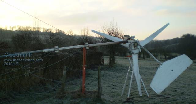

OK found a pic of the bending ,I'm talking about ,and you can see the attachment fixings on the tower steel -I've tried moving these fixings to other places ,but still get bending.
by the way,these attached wire cables are actually one only ,going back to a sheave block . It is then pulled up tight by the winch cable.that may be where my problem is?
Bruce
the topmost cable takes all the lifting weight, the lower ones are there to just stop things flopping around and hold the weight of the mast. if you are pulling on the lower cable the mast will bend.

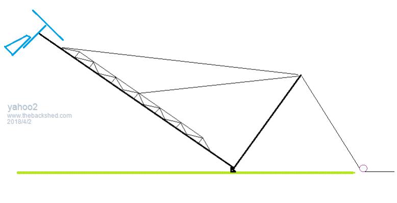

the problem with building stuff with metal is there is only strength in compression and tension, any metal that is on the central axis contributes nothing to stability in the other plane.
That is why the stiff metal masts have a larger diameter and hollow centre (or triangular lattice), when they bend there is compression on one side and tension on the other.

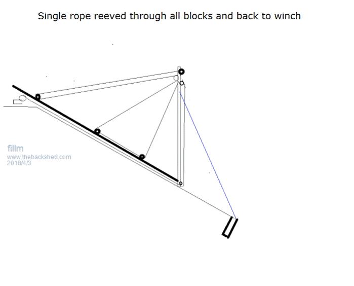

I guess it is time for one of my matchstick man drawings again, the ones the search engines love so much.
Ignore the zig-zag cross bracing, it does very little structurally under tension, as long as there is a triangle at both ends and the outrigger braces are there it will be all good. It would be even better with two outriggers 90 degrees apart tied in a triangle at the outrigger points.
You can also see that the lift angles on the cables stay the same using a gin pole, it stops us pulling on the middle of the tower.
Anyway, something for you to ponder and mull over, I have "dropped" a few towers over 100ft without the correct gear, that last 20-30 feet is pretty scary, it usually ends with something damaged.
edit: Wow it looks much better on the interwebs! its no fusion360 but you get the idea.

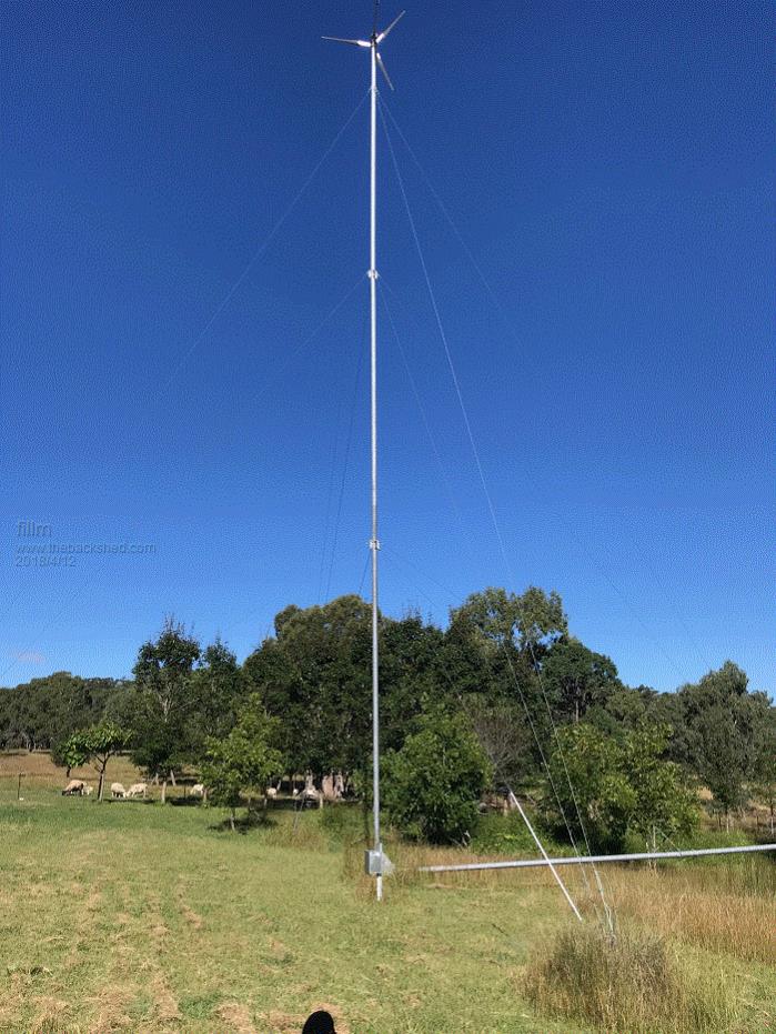

Yahoo is correct an the method he has shown is the simplest and most cost effective way of raising turbine towers.
As I know a little about your tower from visits many years ago, and from that and the pictures I can fairly well say that its not capable of a 80kg turbine without major modification . The lighter F&P were no problem in the day but now you have trippled the weight and extended the tower top with the 89mm ID Pipe . It is made from 75mm x 6 x 3mtr angle as you gave me a few pieces back then, I can not remember the full details of your build method but the best config is as a 20mm overlap stitch welded to give a + formation which give stability but still not as good as 100mm to 125mm pipe.
Your lifting method is pulling on different radius points and if they are all 3 apear to be going back to the same winch drum. This will not work as different lengths will end up with the inner point getting ahead and the upper lagging a bending the tower as it appears now .
The lifting method needs to be changed to the conventional "Gin Pole " this then has the frt guys permanently attached and as shown in Yahoo's drawing is pulled from one point and the weight of the pole assists the lift to the point of over counter balance at the top .. Or you could reeve as a single wire through wire rope pulleys and it would then pull evenly but the weight still might cause tower
bending if the structure is flimsy with the 2kw on the end .
Also from your pictures you have raised the height of the tower with some 89mm pipe that looks to be just bolted in the first 1 - 2 mtr painted white and not moved the upper guy rope . This is most likelly also causing the upward bend in the under the guy point .
The Upper guy point needs to be as close to the top as possible to minimize the unsupported, if you change this and also run the 3" 89mm pipe past the upper guy point it will then support the leverage exerted onto the upper section between the intermediate and upper guy point.

the Tower, thanks for the illistrated drawing , my set up ie very similar,except for the addition of one extras sheeve block .
This illistration works , but the friction in the intermediate placed sheeve blocks causes some difference in lifting forces. ( thats my guess ,anyhow)
I don,t have any problem with the winch ,it's heaps strong enough . The weight of the 2Kw Gennie is a factor ,indeed.
If I could just get the bending sorted out to some lesser degree,I think all would be OK , I reckon once it's up around 45 or more degrees it would behave itself ,up and down.. Ilda and I ,sometimes just myself , have raised and lowered this contraption many uneventfull times in the past -I carry a deadman up-down-stop control switch on a 60 metre lead around the paddock as we ,I, check all safety aspects while in operation . works perfectly .
