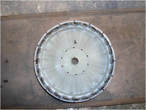

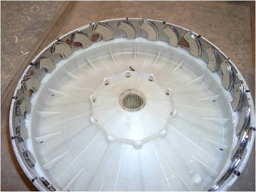

Here are a few images of the magnet hub. I placed the magnets with the hub on the shaft so I could see where to line up the magnets so they were in phase with each stator coil, and used a brass
rod to position them. I hooked this up and it spun at about 250 RPM without anything(glue) holding the magnets in place. They didn't move a bit. At this point I need to get a larger ammeter to do a bit more testing. I may have to build a piclog now. By the way thanks for the site and all the info. I love to tinker with DIY energy
projects. I felt like I won the lottery when I found a F&P machine here in the states, they are not easy to come by here.

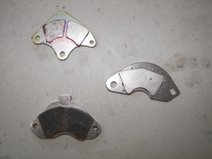

They are from many different kinds of hard drives. I got double the amount of drives from a computer repair shop, and took them apart. The magnet sizes vary so it is helpful to try and get the same brand, but they tend to be roughly the same sizes. I plan on taking apart more as time goes on so that they are all the same size and thickness. The motor that powers the harddisk is similar to the F&P only very tiny.
Posted: 06:39am 08 May 2008
Hi spiral,
those magnets are from the voice coil actuator, that drives the pickup heads. I believe most are praesodymium alloy. I read once that Japanese companies used this rare earth compound. This alloy tends to be softer and less brittle than the Neodymium Iron Boron alloy. The magnets are still a good find. I use them for fridge magnets... Gordon.

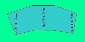

I've just tested some hard drive magnets and found on the flat face that faces the stator, They are not all one magnetic pole. Mine has one pole in the middle with the other at each end. Are yours the same as mine? I suspect so.
HDD Magnets
If so this magnetic configuration will not work as both magnetic poles are adjacent any one stator pole pole at the same time. It will have magnetic attraction to the stator laminations but will not cause the flux to flow through the coil and this is what induces the current to flow.
I can't think of a way of using these magnets unless they can be cut. I'll leave that for you to explore.

Hi spiral,
I have tested some magnets from the voice coil actuator of a hard disk drive, that look very similar to the ones you have used and they all have a north / south through the thickness orientation at one and the opposite polarity at the other.
The ones I tested had curved inner and outer edges. They were not flatenned like Gills' picture.
The ones I have would work. .. .. Gordon.
edit.. One thing I have noticed on your layout. The magnets are not a very good shape to suit the F&P rotor. I expect that the output waveform may be a little strange.Edited by GWatPE 2008-05-10

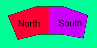

The magnets I have all have the north/south poles on the same face. They do work. My testing has just begun, but I

When I came up with the idea to do this I had planned on cutting the magnets and arranging the poles in a more linear fashion around the hub, but then I read about a company that skewed their stators to help with cogging.
I thought, maybe skewing the magnet would also work. Plus the natural curve of the magnet lent itself to this.

That they have "north/south poles on the same face" is not the problem as such, it is where these are located on the face that I see as the problem. I think Gordon says his has the poles at each end. I am surprised as I have several HDD magnet types here and they do not.
For those considering a similar modification, it may pay to check by sprinkling some iron powder or fine iron filings above the intended magnet and seeing if you get the twin arrangement I have identified.
If this happens, better go look for spiral and Gordon's single type like I am.

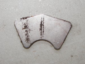

I use a needle to find the pole of the magnet. Filings tend to stick to where the field is concentrated. My method is hold the magnet in one hand and the needle in the other. Hold the needle at an end. Move the other end of the needle over the magnet surface of interest. The needle will align to the magnetic field.
The hard drive magnet shows a distinct null between the two poles. The needle will jump from pole to pole. The needle tends to centre in the area I have shown on the picture marked N and S
I think you will find that the line the filings make is not a pole. .. .. Gordon.

All the hard drive magnets I came across have a N/S pole on each face, with the center being the dividing line.

I tried some different magnet configurations but the one in the picture gives the best output so far. I did notice that my air gap is quite large compared to the factory hub, and will try to either add another magnet or build out the laminations with another layer.
