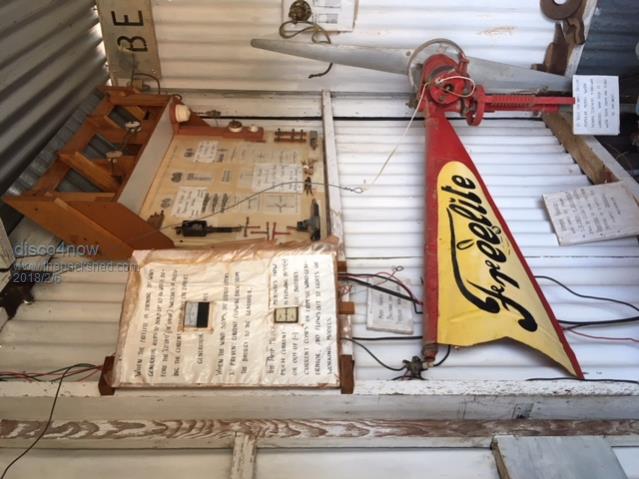

Sorry I can't help, but thought I would post a picture of one I saw on my last trip into South Australia. It is in a shed/museum in the abandoned town of Beltana in outback South Australia.
Hope someone can help.

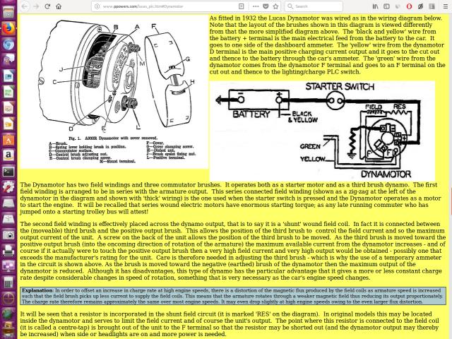

Lucas A900R Dynamotor
about 1/2 way down the page has some info on how it works by a guy who has one on his
1932 Morris Cowley.... you may be able to track him down and contact him for more info?- try his homepage?

Its a weird beast, its both a starter motor AND an generator in the one unit...
Dont know about later models but the wiring diagram I found is a weird setup- its a constant voltage, constant current output apparently- with an internal field resistor inside, and an external one- usually fitted to the headlight switch(probably the one on the outside of his case) that basically increases the current output when the headlights were turned on....
I didnt find it at first as I was searching for generators, and lucas list this as a dynomotor, apparently bosche and several other companies made versions of it- and more surprisingly they are still used in some volvo marine motors as well (suppose its cheaper than a seperate magneto charging circuit if you are going to put in a starter moor, might as well use it for charging too if its only light loads light running lights and the like for small boats
Why it was being used in a windgenny???- anyones guess- ex manufacturers stock they could get cheap maybe?

Not many would have come across these before Madness, the A900R is a strange beast indeed- its not a standard dynamo aka generator, its both a starter motor and an generator in the one unit. They had a combination field winding, part of which is dual duty for both functions. It apparently doesnt use a regulator in its standard configuration, with basically only two output levels- low and high amps out, set by changing resistance in the field windings. Add in the three brush system they normally had, and many auto sparkies (even the old schoolers) would be struggling to figure out how it works, I'm still not exactly sure myself as there is very little literature about them around (and I been in the field for thirty years, did some of my apprenticeship playing with gennies, but they were pretty rare even back then lol)
Add on this has probably been modified for use as a wind genny to boot and i's a big ask, any autoelec could probably nut it out eventually, they arent that complicated, but as a paying job would be $$$
If they know its history as a combination dynamo/startermotor (hence the dynamotor tag) it would be a lot quicker to decipher its workings- for many that didnt know its original use would spend a lot of time trying to figure out what and why they had the extra heavier windings in there etc, add in no original regulator (that may have been modified in its new role as a wind genny) and you have a real cludge of a beast lol
