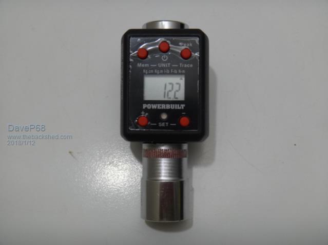

Now have just the tool to make an accurate input power measurements of any F&P stator setup.
Use an inline digital torque meter that I picked up from the local hardware store for $70 NZD.
Here is a photo of a 12.2 Nm reading I took last night.
Calculation for the measuring the input power of an F&P stator is;
Power = Torque x RPM divided by 9.5493
Power in Watts
Torque in Nm
Example test run at 600 RPM with torque reading 12.2 Nm.
Input power to stator came to 767 W with an output power of 661 W.
Divide the output power by input power and we get 86% efficiency. I know that 600 RPM doesn't represent a practical operating RPM for most Wind turbines described on this website. Just an illustration of what can be done.
