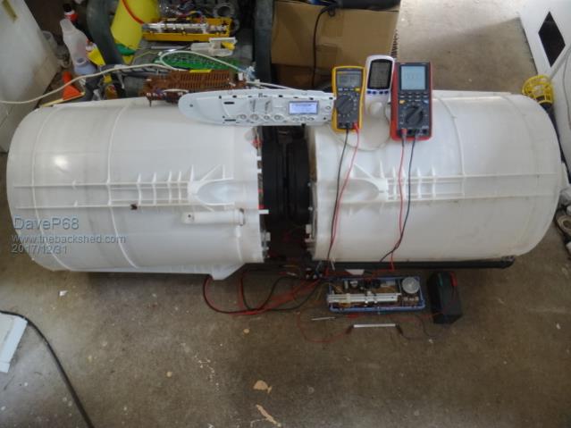

Here is my new test rig with a fully adjustable load (blue module below) that can simulate MPPT (GTI) or Battery Charging.

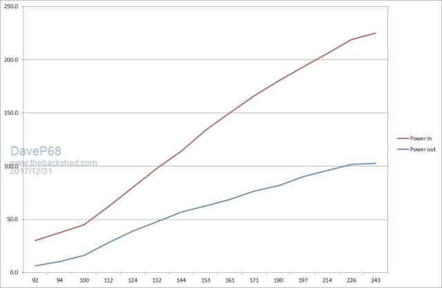

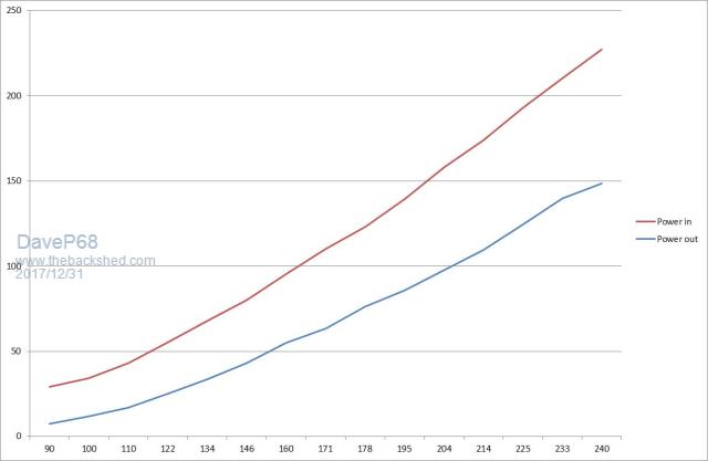

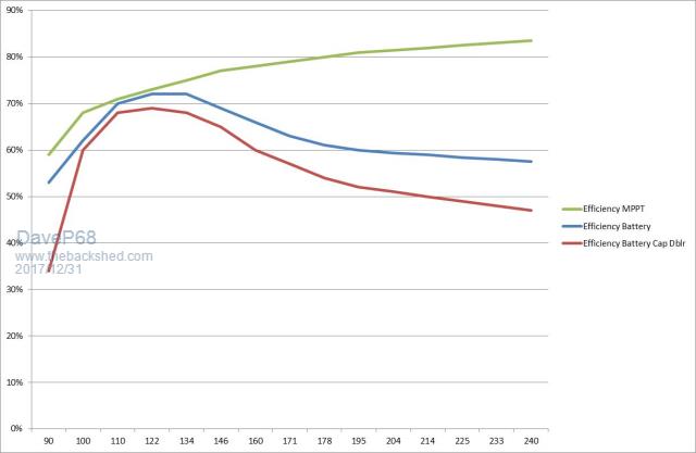

Here is a graph of an F&P stator’s efficiency in 3 different modes, MPPT (GTI), Battery Charging and Battery charging using a Capacitor Doubler.
Have also taken into account the various losses such as efficiency off motor controller, friction, I^R copper loss etc.

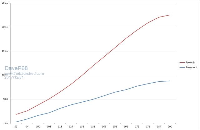

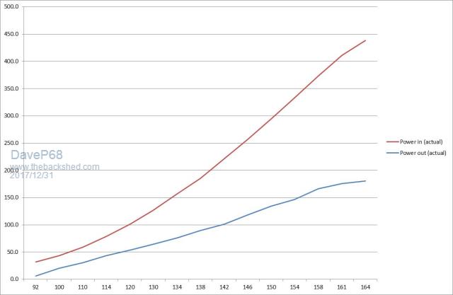

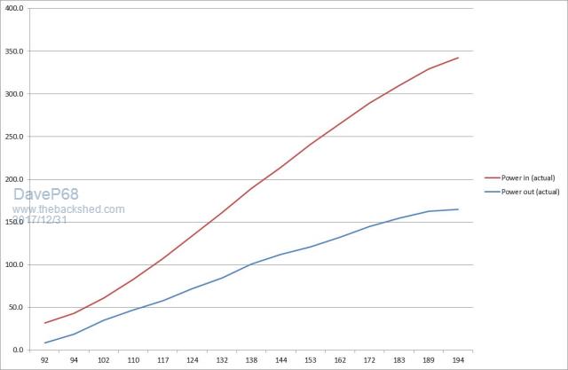

Here are 3 graphs of input power vs output power measured over similar RPM ranges. The motor controller used to drive stator # 1 as a motor is torque limited above 270 RPM so there is no data for above that RPM limit. It also closely represents the winds in a range of 3 – 8 m/s.
My data logger was to take a video of each test from 92 up to 245 RPM and enter all the 4 readings displayed as they updated. Readings taken were RPM (white display module), AC power meter measuring input to motor controller, then Volts + Apms on stator #2 output at DC side of 3 phase rectifier.
First is a graph of simulated MPPT (GTI) which results in the best overall efficiency up to 245 RPM.
Second is a graph of simulated Batter Charging.
Third is a graph of simulated Battery Charging but this time using a capacitor doubler.
** Please note in last 2 graphs, only half of a stator (1x 6c) was used on the output side. The motor torque required to drive a whole stator was almost double as the stator output current approached it's maximum limit due to stator voltage being clamped in battery charging mode. This allowed for a more equal comparison between the different set ups as the input drive torque requirement remained fairly constant over a similar RPM range for each test done.
So the conclusion I've reached here is Battery Charging quickly becomes less efficient as the RPM increases just above the cut in. The MPPT (GTI) system is more complex to impediment, but is the most efficient way to extract power from an F&P stator or any PMA for that matter.
Comparing 2 identical F&P dual wind turbines, one using MPPT (GTI) and the other Battery Charging, the accumulated output power difference over time would be >30 % better using MPPT (GTI).

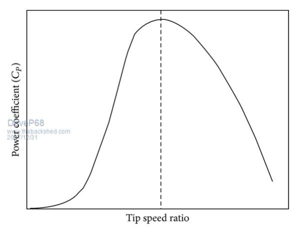

It's all about keeping the blades in the TSR sweet spot in order to gain the "optimum" amount of torque for a given wind speed. Power = Torque x RPM divided by 9.549297 with Power in Watts, Torque in Nm. This is how MPPT works, it keeps the TSR at a point as close as possible to the best Power Coefficient over a wide range of wind speeds.
If too much torque is taken from the shaft then the TSR will drop off creating further losses. The blades will produce more torque at that lower RPM but but at the expense of a lower Power Coefficient, thus resulting in lower power transfer to the PMA. The PMA having less RPM to work with will produce less power output, a law of diminishing returns!!

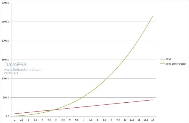

A graph of wind power vs RPM over a speed range of 2 - 12 m/s using 3 m blades.
I've developed a complex algorithm which uses "Closed Loop Control" that can used to operate the PWM in an inverter used for battery charging or GTI modes.

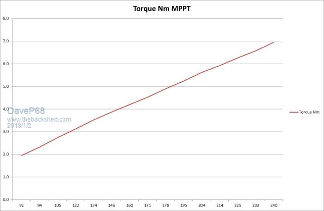

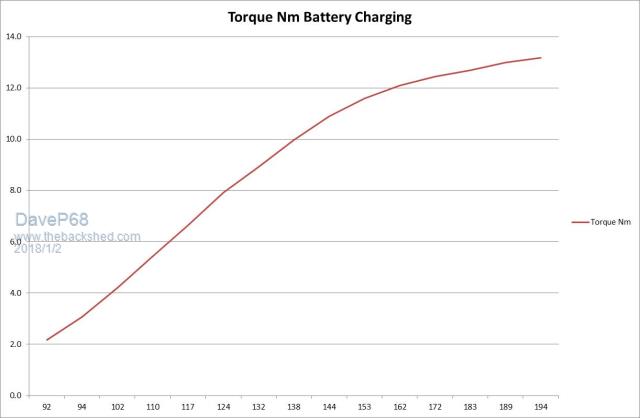

Very good question as I hadn't bothered graphing that data even though I was able to closely calculate what it is.
I don't have any manufacturing data from Fisher & Paykel but was able to work out most of input modes to the motor by watch the PWM wave forms etc.
Also run up the motor on its own over same RPM range logged input power data vs RPM. Then connected the test stator acting as the alternator with no load on it and ran same test. That way was able to calculate closer to what is going on in the complete drive system.

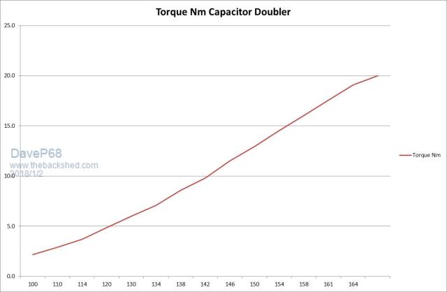

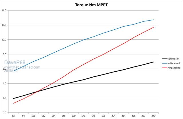

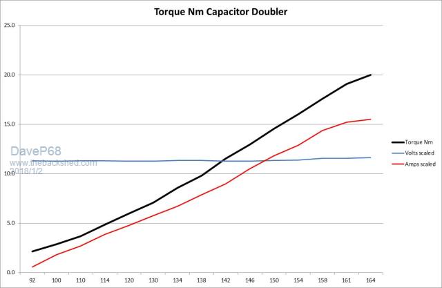

Here are 3 graphs of Torque in Nm over the test RPM ranges as seen in this topic.
First is for simulated MPPT.
Second is for simulated Battery Charging.
Third is for simulated Battery Charging via a Capacitor Doubler.
Note how the Torque curve for a stator feeding into Capacitor Doubler is similar to the curve in the MPPT graph. If one thinks that Capacitor Doublers can replace an electronic MPPT system my new data says that is definitely not the case.
Look up the "Dunning Kruger effect" to check out why I'm saying it this way.
Capacitor Doublers perform even more poorly than directly charging batters on F&P stators from my new data. To achieve better power transfer efficiency in the 3 - 8 m/s wind speed range, just rewire the stator to suit the best TSR. The older 42 pole stators are not as suitable for this with a more limited rewiring combinations compared to the 36 pole copper stator with black rotor caps. Also 36 pole stator are factory decogged!
I can now see why there was lots of effort 9-10 years ago put into capacitor doublers on F&P stators, as the 36 pole copper stators were not common back then.

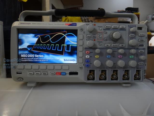

A photo of my latest purchase towards this new project, a Tektronics MSO 2024.
Won't say how much this secondhand unit cost me, was <10% of the current model.

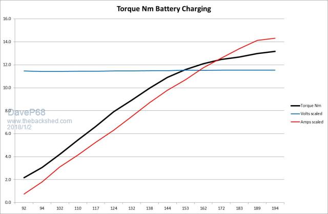

Here are 3 the same graphs showing the input torque of 3 different F&P stator set ups, but this time with "Scaled" Volts & Amps. Results speak for themselves!!
First simulated MPPT.
Second simulated Battery Charging.
Third simulated Battery Charging via a Capacitor Doubler.
Note how the current from the stator runs in proportion to the Torque in the second and third graphs!!
So we can now say with MPPT the equation of 2+2=4, but with battery charging or even worse a capacitor doubler 1 being voltage + 2 being current does not = 4...
Hope this clarifies your questions ks and also allows others following this topic to gain a deeper understanding of how to make better use of F&P stators on wind turbines.

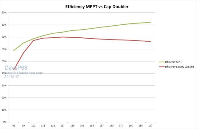

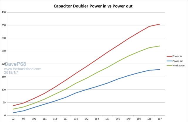

Found an error in the Capacitor doubler used to provided the test results above. Was using too high capacitor value in the test unit. This was due it being used in the past for testing of a 2 to 1 input voltage range MPPT GTI inverter which doesn't behave like a battery at all...
The capacitor value was 280 uF AC way too high! Changed them over to 120 uF AC, but found they were still a little too high. Still gave good results though so left them in for the test anyway. The capacitors actually need to be about 80 - 100 uF AC to get the best results.
Used a 80s stator wired Delta into a simulated battery set at 57 VDC. It ended up working well compared to my MPPT system and a lot better than what can be seen above. My guess is the best efficiency of a capacitor double will be 70 to 72 % at best in it's sweet spot for where most power is produced.
Capacitor Doublers efficiency is around 15 % less than a good MPPT system, so you can't get something for nothing!!
Here are my updated graphs showing the change in power input vs power output and efficiency compared to MPPT.
Note in colour "Green" I've included the equivalent "wind shaft power" that would be driving a 0.8 mm stator on an actual wind turbine.
Hope this is of interest to those following this topic.
Can now calculate all the capacitor values for Capacitor Doublers for any F&P stator wiring configuration, for both star and delta that will be used with a 24 or 48 VDC battery system. This includes all different versions of F&P stators 42 pole 100s, 80s, 60s and 36 pole copper with black rotor caps.
