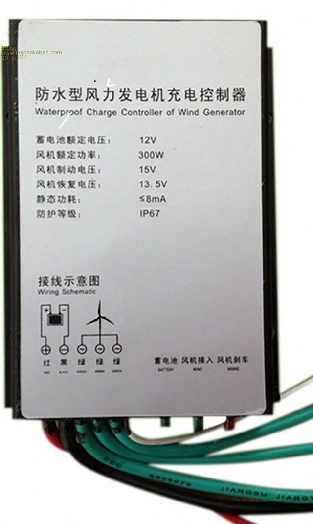

Hi all, i have two projects for wind turbines for my allotment, one using a treadmill motor (4500rpm/12v/2hp) and recently i won an lg direct drive for a £1 (36p stator as above post). I was planning on using the first motor for a hawt and the second as a VAWT as i dont have anywhere i can put something up high. The land i intend to use is at the top of a valley - can get very windy, but i can only go about 10 - 15ft high.
i bought a cheap controller (see pic) and have mmpt controllers for solar. Can i cheaply combine one of these setups to include 300w solar system which i already have AND also I need to add a dump load onto the 300w controller or can i add it to the whole solar/wind setup - if so how?
Have 2 AGM 12v batteries and plan to run some lights, pump, fan = 200w max. But if this generates more, i may use it on my house.
