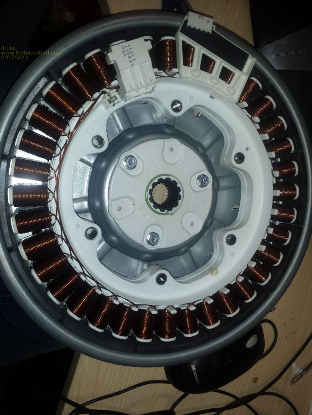

Hi from the uk and new to the forum. Am building an oil drum savonius wind turbine. I managed to get an LG Smartdrive washing machine, using the hub, stator and rotor. But I need some advice on how to rewire the stator for low rpm, max amps at 12v (batteries). I have inverter, charge controller and plan to make a load dump. Looked at many posts and diagrams on here but all relate to f&p which we dont get in the uk. So any help would be great, also on which leads goto the charge controller etc thanks

that rotor and stator looks similar to an f n p, so I would say you could use the fnp rewire page on this site as a" guide" for how to rewire your stator,, read the WARNINGS on this site about LEATHAL high voltage that the stators can produce .
The wires that lead into the stator when it was used on the washing machine.. will be the lead out, to rectifier for dc to your controller, or unrectified ac to your controller.whichever your controller takes.

Thanks Flc1, also, i have a chinese 300w charge controller wondering if this might need something more?
This seems to relate to what i would need for low rpm /vawt when it says "factory wiring" does that mean it doesnt need rewiring?

Just to add my 5 cents worth in on electrical characteristics, is the wire copper or aluminium? Also what is the resistance reading between the phase pairs?
Also is it possible to get a volts per RPM reading?
The F&P 36 pole copper stator in star configuration using white rotor cap is about 1.02 VDC per 1 RPM out of the 3 phase rectifier. Example 102 VDC open circuit output at 100 RPM.

factory wiring means that is how it left the factory,with that wireing configuration,
get a voltage tester, put your stator n rotor on a jig so you can spin it and get some voltage readings vs rpm, I don't have any experience with vawts, but from what I have been told they are not as efficient a a hawt, and I think you work with lower rpm,
So whatever voltage you get for your preffered rpm in your test will be reduced by about 30-40% when its under load, so when you have for example 50 volts at 50 rpm ( thats your open circut voltage)it will reduce to about 35 volts(working voltage under load) for the same rpm when its put into your controller and batterys or whatever you are putting it into, so you have working voltage and open circut voltage. the factory wired stator will have high voltage per rpm, so be careful when you spin it up.

  flc1 said   Druist
So whatever voltage you get for your preffered rpm in your test will be reduced by about 30-40% when its under load, so when you have for example 50 volts at 50 rpm ( thats your open circuit voltage)it will reduce to about 35 volts(working voltage under load) for the same rpm when its put into your controller and batterys or whatever you are putting it into, so you have working voltage and open circut voltage. the factory wired stator will have high voltage per rpm, so be careful when you spin it up.
So it would be better to configure it to a lower voltage 12/24 which would increase the amps too?

yea, find out what your average rpm is and configure it for that
