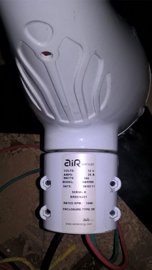

Having a look through the manual it doesn't specify anywhere whether it is DC or AC. However, the turbine itself has positive, negative, and earth cables, so I am guessing from that it is outputing an AC current.
I have included a photo of the sticker which has some information on it.

Yes DC only and won't work without a battery DIRECTLY connected to it.
Did I say "directly" connected 12 volt battery. It will not operate if there is no battery.
If it is exactly the same as mine, It "should" be set to stop charging at 14.2 volts.
If there is a little adjust screw on the side I suggest you do not fiddle with it.
It is a nightmare to reset.
The led underneath will flash codes and indicate when it is charging.
Quite easy to see on a "pitch black" night when it is 40 feet up a pole.
Any external battery over charge controller must short the turbine out to stop it charging.
It is 12 volt and only 12 volt same as mine.
Has lots of "happy" complicated, reliable electronics inside, if it is used as it was made to.
There is some information on the web.
By the way my unit's output is pulsed so amp-meters don't really tell me anything.
A volt meter will indicate the battery voltage.
It is working if the battery is not flat.
I could write a book about mine. (But I won't)
I believe they are no longer manufactured.
If you require more info PM me.

an air breeze is DC, it has a charge controller, rectifier pack and electronic braking built in.
My advice would be put it on a short pole and hook it to a 12 volt battery and play with it. They are fun they look cool but as a wind turbine that generates usable power they are a lesson in the power of marketing. Don't waste any time or money trying to integrate it into your existing system.
there is a lot of potential in that little turbine but it is just impossible to extract.
