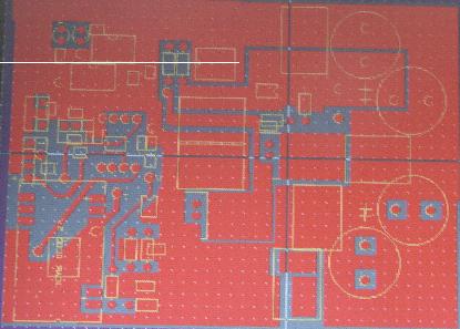

Hi All,
MPPT is progressing well. I am at final artwork stage. Screen photo is presented below. I have been unable to capture this screen, had to use camera, so apologise for poor quality.
This is a multi layer board. approx dimensions are 100mm x 80mm. No heatsinks should be required. Only one picaxe is on this board. 2 other picaxe interfaces are off this main board and connect with a 4 way loom. The current sensing Hall effect device is also located OFF the board. This is designed to be a universal main board. I have also made provisions for in circuit reprogramming. I hope to have a cct in operation next week.
cheers, Gordon.

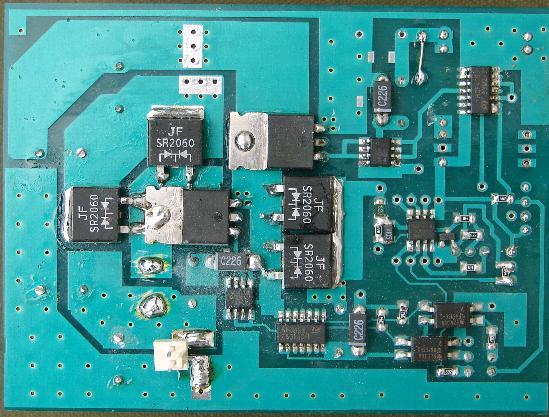

Hi interested readers,
I have attached a photo of my prototype MPPT board.
This board has the high power DC-DC converter and modulators.
There is still quite a bit of code optimisation in the micro still to be done. I have had to relocate as much of the code to other micros, to improve the response time.
It is inconclusive at this point to say the AXE-08M is able to perform the Maths functions necessary for correct tracking of a windmill's output power.
Still some more work to do.
cheers, Gordon.

Posted: 05:53pm 15 Dec 2007
Hi
Gordon Any chance of sharing circuit diagrams particularly of the dc dc converter. After all I believe this is a forum where info is freely shared and built on.
Herb
Posted: 10:52pm 15 Dec 2007
Hi Herb,
As you will be aware, these type of ccts do require special construction techniques. Poor construction can lead to a serious RFI problem. If this works well, there is probably economic value in it. At this point I will not be publishing any cct diags on a public forum. I may have employed similar techniques to others and I will not be publishing ccts as my own without first checking. If I have used other persons published ideas, then I intend to credit those people.
I am still trying to distribute the various mathematical tasks between micros. It is pretty apparent that a single micro, AXE-08M is unable to fulfill the role by itself. The control of rapidly changing variables may still be better managed by a mixture of digital and analogue ccts. In the past I have been able to modulate at 500kHz, with a linear response 0-100%, to digitally amplify audio using a discrete component digital modulator that I have built. The digital control response time of the process usung the AXE-08M is currently a bottleneck.
I will continue to press on as many DIY windmillers and solar experimenters will benefit if this technique can be successfully implimented.
cheers, Gordon.
