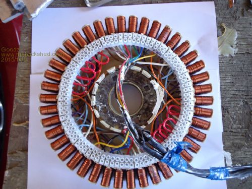

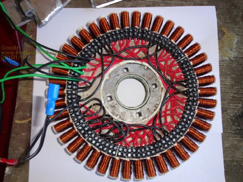

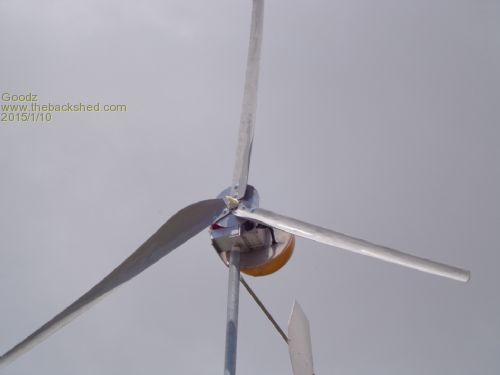

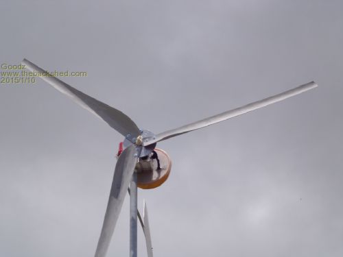

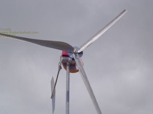

Hi Gizmo find pics here of my rewired poles and the blades running the unit now
cheers
Goodz
Hope you can be of some help. Have read that maybe the 60s are not the best and should I swap wiring to the 80s. Easy with the connectors in place !!
regards
Goodz

Hi all In pics the top photo shows the 0.8 dia wire,set up as 2X3C 7 phase
The bottom shows the 0.6 dia wire set up as 1X6C 7 phase
regards
Goodz
Posted: 12:55am 10 Jan 2015
Hi, that is certainly the most unusual way to connect to the individual stator coils that I have seen.
I would think that there is a very good chance for one or more of the 80+ screw terminals making a poor contact to the enameled copper wire.
Why not solder the connections? With soldering its easier to see if the enamel insulation was not properly removed as the solder joint will look bad - at least to my trained eye.
Posted: 01:06pm 10 Jan 2015
I would put the 2X3C 7 phase into service and see how that goes. You need to get the RPM up a bit to make any real power.
Those types of blades can be a bit of a problem, not the best option, but enough to get your started. Check the angles neat the tips, easy to get a negative angle of attack and dramatically reduce the power. Some GOE222's or carved timber blades will perform much better, and handle strong winds.
Tinker I've see a few forum members use the screw terminals before, its good for experimenting. Long term though I agree, solder connections are better.

Posted: 02:42pm 10 Jan 2015
I agree with gizmo on the blades also. I played with blades just like that before I found that even simple cheap pine strait angle blades were as easy to make and worked better. I like the twisted blades even better and it doesn't kill them if you make a few flaws while doing them. I have no luck with pvc and I find them harder to mount also.

Posted: 11:54pm 10 Jan 2015
Hi Barry,
Hey very nice work and yes it is a great way to learn. As I have advised off forum, and as Glenn has said you need to get the RPMs matched with the blades , especially the PVC pipe.
From the pictures you still have way to much material (curve) out at the tip. Ideally you need to remove enough so the blade tip looks like an airfiol and a lot flatter, but this is a double edge sword with Pipe blades as they then become weak . From about 1/2 way take material off the back of the blade until the tip is about +2deg or even less AOA, if you can.
For your 24V with the 80S try 2x7C, in star and if it loads to much and stalls then go delta.
