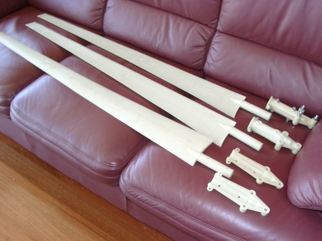

Hi
I bought similar blades (6.8Ft)from ebay seller "magnet4less". The parcel arrived today from the USA. They are a piece of junk, not worth even making a hub for it.
This blades look the same as the one from ebay seller "powermax".
If somebody wants them for anything: free pick up from my place- Mooloolaba 4575.
I will order set off blades off a Lotoka turbine, any info on a good price is welcome.
It didn't make my day

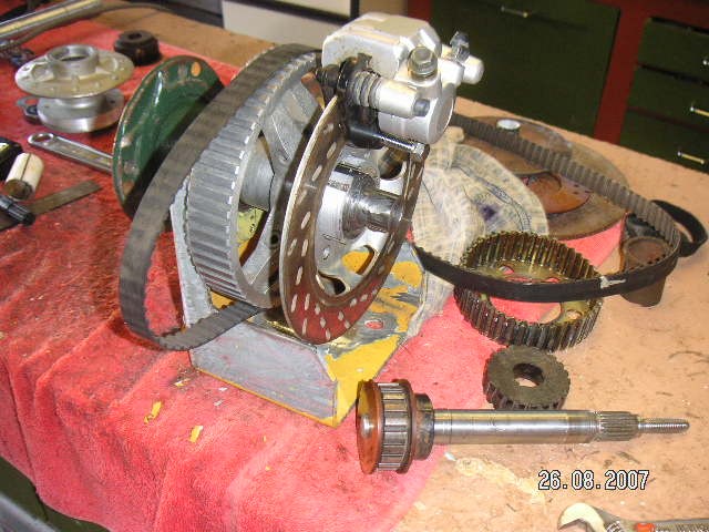

Hello Harold, sorry to hear of your disappointment. They look ok in the photograph,but !!.
Tell you what,, I got a set of Trev's fibreglass blades-why don't you come down here to Mt. Tamborine and have a look at them ?. You'll be impressed.
I haven't set the hub attactments in them yet,so you'll see what I'm going to do . I've half made the hub platform and disc brake ,plus the ribbed drive pulley.

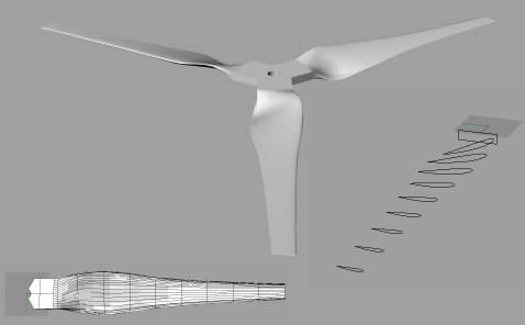

Trev and I are finally starting to make some progress on a set of blades to suit the single rotor F&P windmills. Its been my fault, tied up with other projects. But the cad work is almost done, and the CNC router is all cleaned up ready to start machining.
Its 2.4 meters diameter, with a TSR of 6, profile NACA 2410.
Still some time away, I need to rout out the blank, then Trev can make some moulds to make the blades in fibreglass.

Hi Robert
Maybe the set of blades I received are just a one off.
The ebay seller contacted me and said he had never a complaint and is willing to refund them without the shipping coats. I paid 62USfor the blades and the shipping was the same amount. Not worth sending back.
The ebay seller has a 100% positiv feedback.
When Bruce picks them up he can report on this.

Hi Glenn
Are you going to produce this blades via infusion system?

hi glenn
how will he cast them?
carl1 asked if it was infusion method, what's that?

Hello out there,, well Harald sent me those chinese blades he spoke about at the top of this topic...
What junk ,,,, I reckon they were put together by a mob of 3 year old kids , they are as rough as you could ever imagine .
How someone or worse still a company could send these to a customer ,, I don't know.
The edges are absolutely shocking,no sanding,no filling and the rounded tips are a joke,so rough. the profile is reasonable ,but the things seem to have been pulled out of the mould early and there are depressions along the length.Lots of bog required to fair these blades out ,I'm telling you.
Harald and I talked about these yesterday, I thank Harald for sending them to me and I can assure everyone out there never to buy these .
I will one day bog them and do some serious sanding and grinding of the edges ,they are 1 metre long ,maybe be fairly good for a small gennie. But serious work has to be done to bring these up to good looking blades.
Thank you Harald, he's wisely going to lakota blades ..
I'll probably pass these on to a keen interested 'starter" when I meet him..
