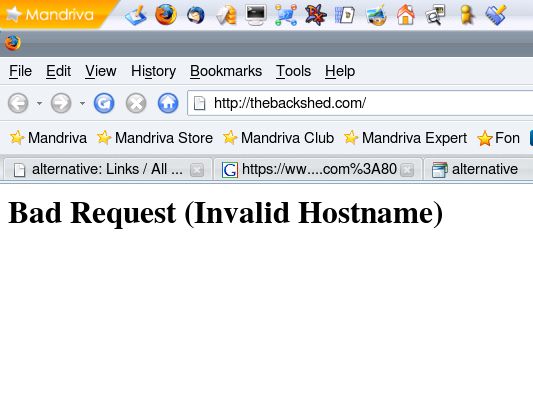

Just by accident typed in the URL without www.
http://thebackshed.com/windmill/forum1/default.asp
And got back this!
Bad Request (Invalid Hostname)
Whatever it is, Glenn, contrary to Gavins claims that everything is "perfectly valid", it is *NOT* working properly. I'm not planning any further diagnostics lest I step on any toes, nor am I going to say what is (or isn't) right, wrong or anything else save "it's broken" as other members have already reported.

Posted: 10:36am 05 Jun 2007
Also from my Firefox under linux ...

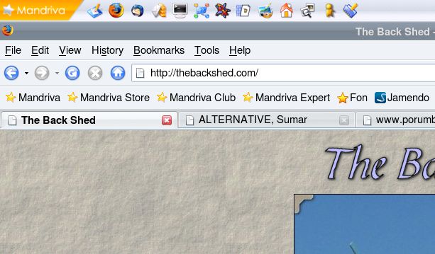

Posted: 08:24pm 05 Jun 2007
Is done! The new host is now "home, sweet home".
