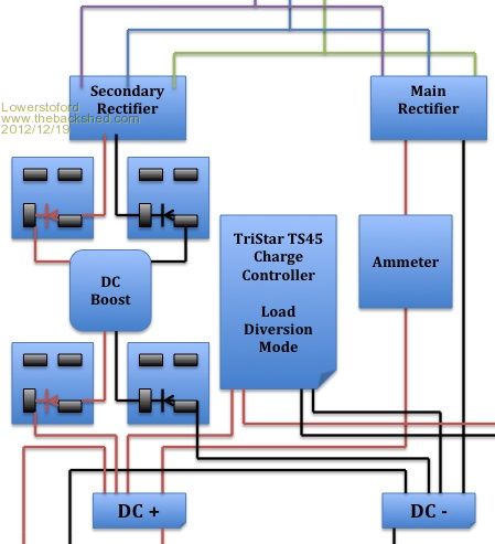

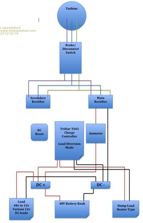

Here is a diagram of my current setup
I need advice in getting the DC boost module installed
My turbine outputs 30 - 48 in low wind speeds. So I am going to add the DC boost and not cap mod
I have KBPC5010 diode and just need confirmation of the correct wiring on these diodes

This is how I think I should wire the DC booster in
This is the booster
http://www.ebay.co.uk/itm/170945298926?ssPageName=STRK:MEWNX :IT&_trksid=p3984.m1497.l2649
These are the diodes(rectifiers)
http://www.ebay.co.uk/itm/260991079196?ssPageName=STRK:MEWNX :IT&_trksid=p3984.m1497.l2649
I think this is correct but would like your expert opinions.......

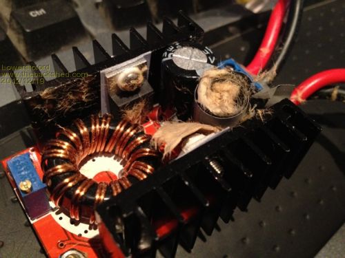

This is why I am asking for help wiring the DC booster into my system
After waiting 3 weeks for my 2 boosters to arrive from China, I jumped straight in, without much research and wired it to my secondary rectifier.
This made the turbine run very slowly so I added a diode(rectifier) to the output and my DMM
The wind blew, The voltage went up to battery charge levels. Wow
I then added diodes to the input so both + and - where isolated and one diode on the output
The wind blew, the output voltage hit battery charge levels. Then the board started making a strange buzz, so I started to move my ear to the unit to listen.........
Yes, yes, its coming.........
It then decided to release its magic smoke, fluff, sparks and flying metal into my face with a spectacular bang!
WOOOO what a rush! (well I can say that as no damage was done to my face, just my nerves)
This unit only cost a few pounds the larger one was more expensive so I must make sure it is wired correctly and does not try to modify my face.

It looks like you might have the wrong one , some are 35V on the output and you will need the 60V ones .
I think I did say it previously , they will try and hold the mill at the min input voltage which is 10.5 , so it will effectively stall the mill if it has no low down blade power which I am pretty sure yous is designed to cut-in at 150+ Rpm , This is why the mill ran slow.
You would not need the diodes between the Main Rec and boost, and if the module was a 60V probably not on the other side as well , you could also AC couple with back to back DC caps to the rec to limit the current draw , then set the output V at 50 to 52 so it cuts out when the wind gets up and the main rec start kicking in.
The boost module you have linked to is not the one in the pic , as the others are voltage and current adjustable but will still react in the same way.
You are probably better of leaving this type right out of the system and playing with a Cap/doubler as the amount of load can be determined by the capacitance.
Had a bit of a rethink here , with all the diode isolation to blow the module up like that you might have connected up the input to output V as it sure wasted the cap , you might need to double check .
Is This the one you installed first HERE OR .... when it blew were you adjusting the output voltage pot to lower the output , if so the mill would have taken of and exceeded the max input V threshold ...... BANGEdited by fillm 2012-12-21

Yes I installed the smaller one first
I didn't think it though, it can only take 37v in max and the turbine will do 40 in 2.5m/s
I purchased this before measuring the low speed output voltage.

The diagram I have uploaded shows how I THINK i should wire it, not how I have
The first diagram is how my system is wired at the moment
At first I just had a diode on the output, as it was loading the turbine down, I added on the in input. This stopped the loading down and the turbine was spinning at the normal speed, the voltage reading was normal
I am sure this unit blew due to too high input voltage
I also think I may have wired input to output at some point, realized what I had done and changed it quickly
This would not have helped.......Edited by Lowerstoford 2012-12-21
